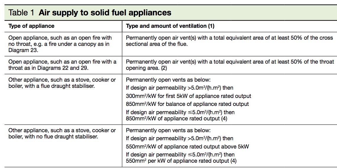

gc100 Posted November 5, 2019 Share Posted November 5, 2019 On 21/02/2018 at 12:12, joe90 said: Well I have built a well insulated, airtight ( I hope) newbuild with a small wood burner that has a dedicated under slab air feed pipe. Yes it may get a bit warm for me but never too warm for SWMBO? @joe90 Did you still have to install a non-closable vent? Apparently the building regs and it recommends a non-closable vent even if the stove is full direct air supply. It seems a HETA installer can fit without the vent if they do the smoke tests (and it passes) in BS8303 . Just wondering what you did? I was planning to do the stove myself as there is no one around here with experience with zinc roofs, air tight houses and don't have any modern effecient stoves. Link to comment Share on other sites More sharing options...
PeterW Posted November 5, 2019 Share Posted November 5, 2019 37 minutes ago, gc100 said: I was planning to do the stove myself as there is no one around here with experience with zinc roofs, air tight houses and don't have any modern effecient stoves. So keep the stove below 5kw and ensure your MVHR over supplies to the room with the stove .. Link to comment Share on other sites More sharing options...
gc100 Posted November 5, 2019 Share Posted November 5, 2019 8 minutes ago, PeterW said: So keep the stove below 5kw and ensure your MVHR over supplies to the room with the stove .. Why 5kW? Link to comment Share on other sites More sharing options...
ProDave Posted November 5, 2019 Share Posted November 5, 2019 We have a WBS. Ours is room sealed with combustion air direct from outside. Ours takes both primary and secondary air from outside, not the room. When not in use it appears to have no aparent impact on energy used to heat the house. It does not create draughts or in any way make the house cold. We do use it a couple of times a week (it is burning now) With the very open layout of the house it does not over heat one room (room with the stove currently 23 degrees) Obviously burning the stove shuts down the ASHP and saves a bit of electricity. It's on tonight as it's damned cold here for the time of year, just 5 degrees today and a hard frost expected tonight. Most of the wood we burn is from our own trees that I am gradually thinning, and local wind fall. I don't buy wood to burn and if I did not have access to free wood, I would not have a WBS. The air quality here is about as good as you will get. Prevailing wind is from the SW and if you look on a map, there is only Dingwall 12 miles away, then next population is Fort William or Ullapool. There is not much in between. I have twice checked the MVHR filters and they are very clean indeed. So anyone with respiration issues, I can recommend this as a place to come and live. No Major roads either, the A9 being our trunk road. If you have MVHR and a room sealed stove there is no need for air vents in the room. In fact our stove is rated at 4.5Kw so even if it were not room sealed you would not need an air intake vent. 1 Link to comment Share on other sites More sharing options...
PeterW Posted November 5, 2019 Share Posted November 5, 2019 9 minutes ago, gc100 said: Why 5kW? that’s the maximum value where you don’t need dedicated air. 1 Link to comment Share on other sites More sharing options...
gc100 Posted November 5, 2019 Share Posted November 5, 2019 (edited) 16 minutes ago, PeterW said: that’s the maximum value where you don’t need dedicated air. Ah ok, so we mustn't have a flue draught stabilizer then but won't we still fall foul of the air permeability given its hopefully going to be reasonably airtight? Though we don't need to do an air tight test for our BC. Edited November 5, 2019 by gc100 Link to comment Share on other sites More sharing options...
joe90 Posted November 5, 2019 Share Posted November 5, 2019 3 hours ago, gc100 said: @joe90 Did you still have to install a non-closable vent? Apparently the building regs and it recommends a non-closable vent even if the stove is full direct air supply. It seems a HETA installer can fit without the vent if they do the smoke tests (and it passes) in BS8303 . Just wondering what you did? I was planning to do the stove myself as there is no one around here with experience with zinc roofs, air tight houses and don't have any modern effecient stoves. Like @ProDave air feed to our stove is from the outside so a “non closable vent” is not required, building inspector simply asked about its function in an airtight house and I showed him the air feed pipe outside and he was satisfied. Link to comment Share on other sites More sharing options...
Thedreamer Posted November 5, 2019 Share Posted November 5, 2019 A bit unusual here having a suspended timber floor, but when our foundations were poured we put in a pipe so we could draw air from under the floor, not strictly necessary as our stove at 4.8kw is under the limit and can take air from the room. Link to comment Share on other sites More sharing options...
