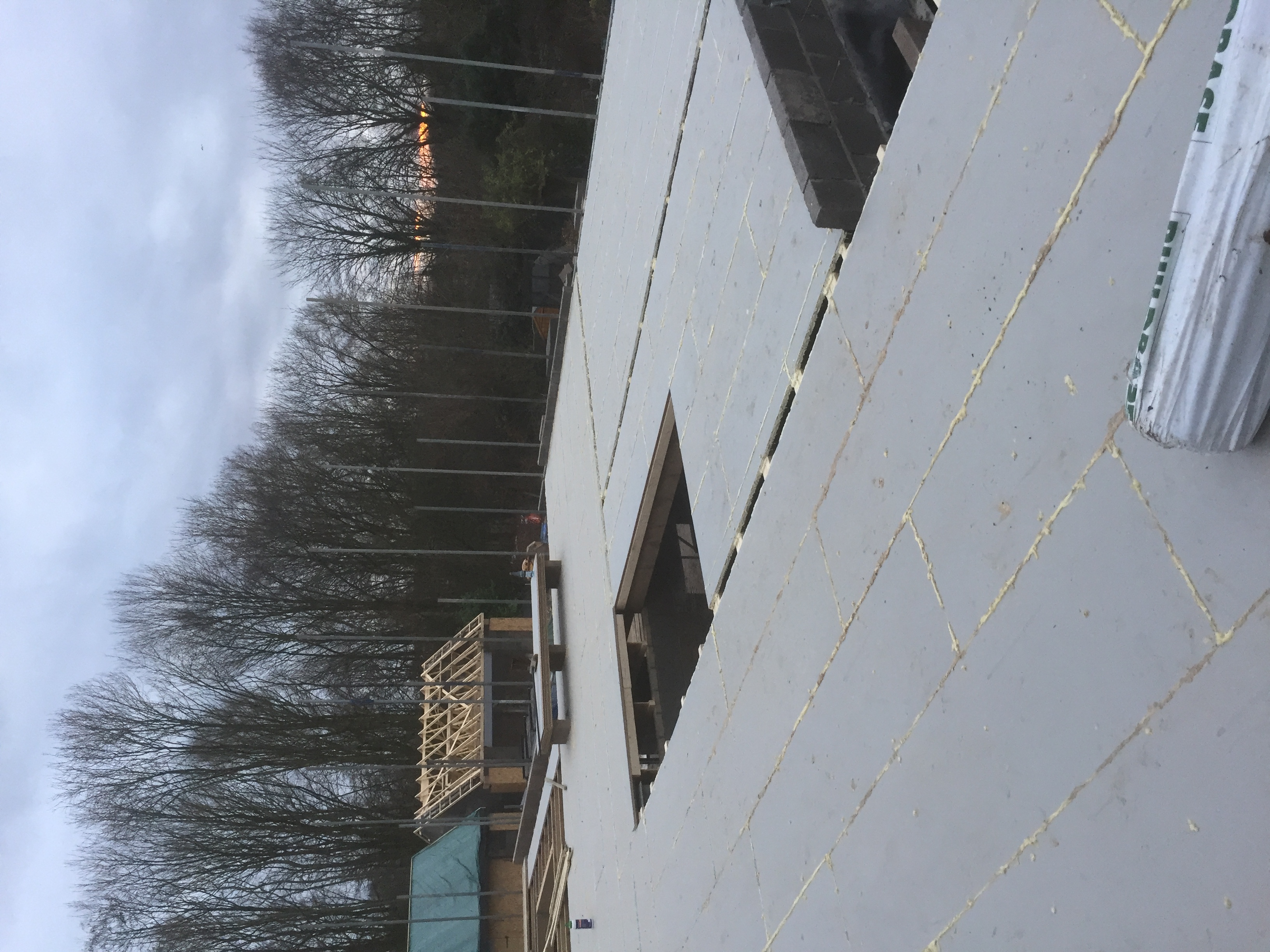

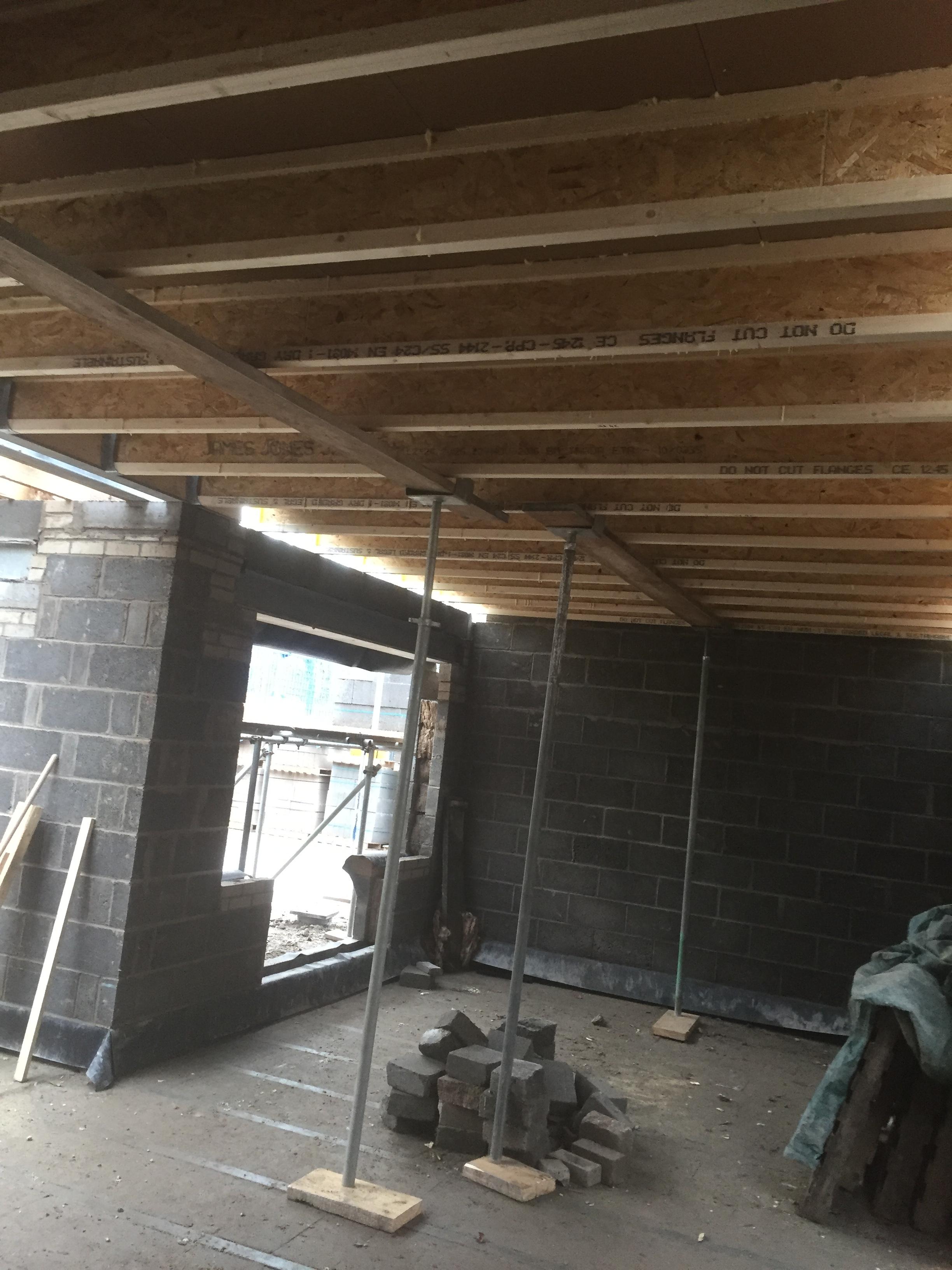

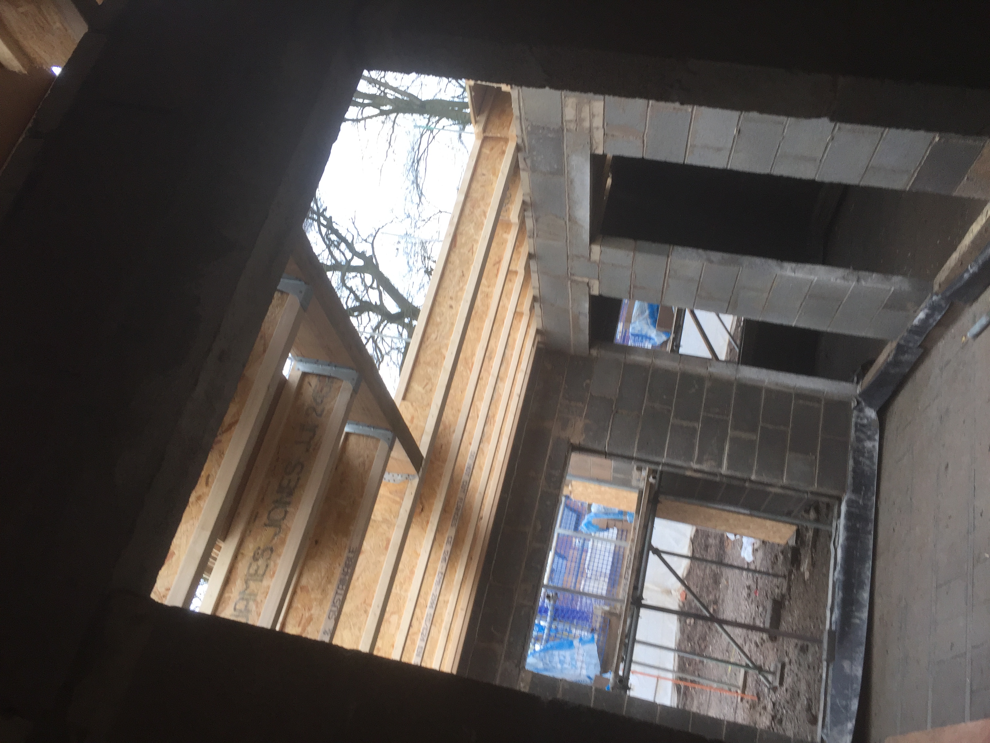

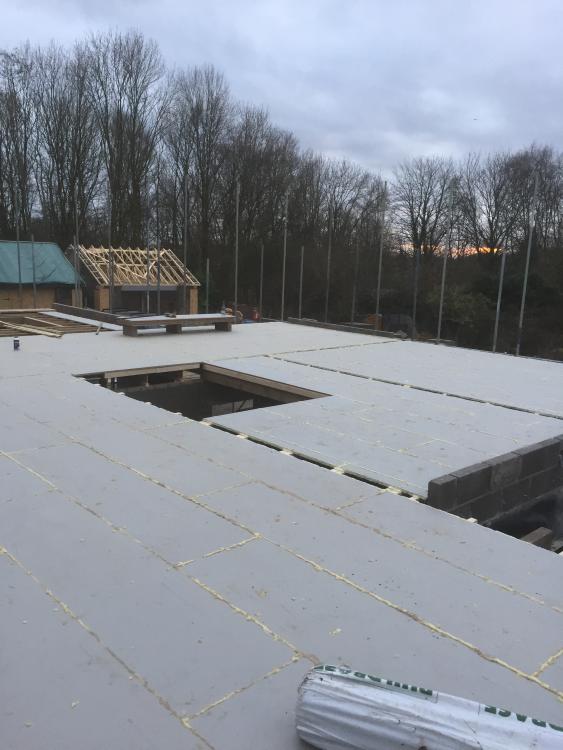

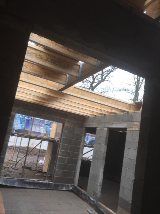

As stated below
you will certainly find answers to your questions on here and often explained in laymen’s terms
To get you started normally plaster to the stairs though if like me you plan on putting in hardwood stairs
It better to get all the plastering out of the way Then fit the stairs afterwards
internal block walls are built upto chamber height so that the posi joists can sit on them Then floored out leaving enough room to carryon building up once the floor is in
Once the roof is on and weathertight the studs can be fixed to the underside of the trusses or rafters and on top of the newly laid floor
hope this helps
