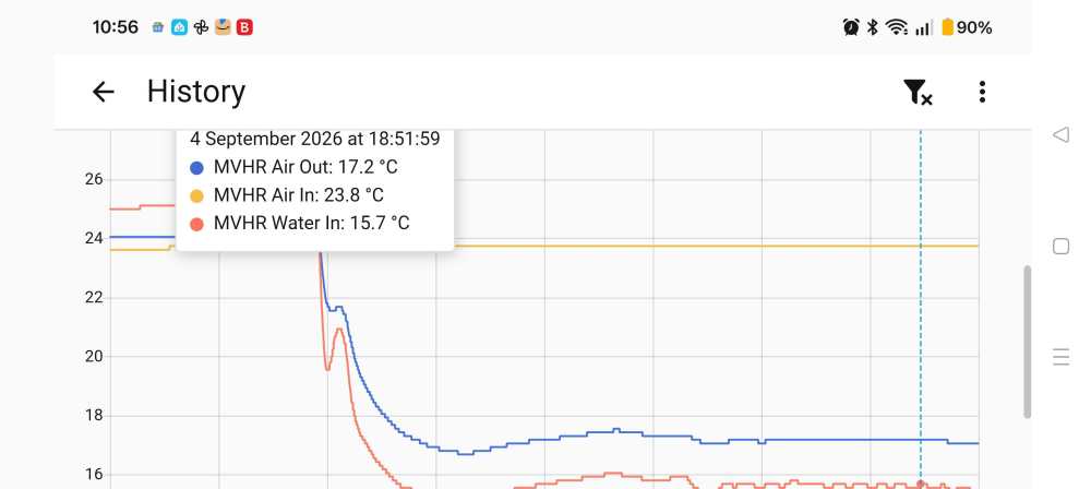

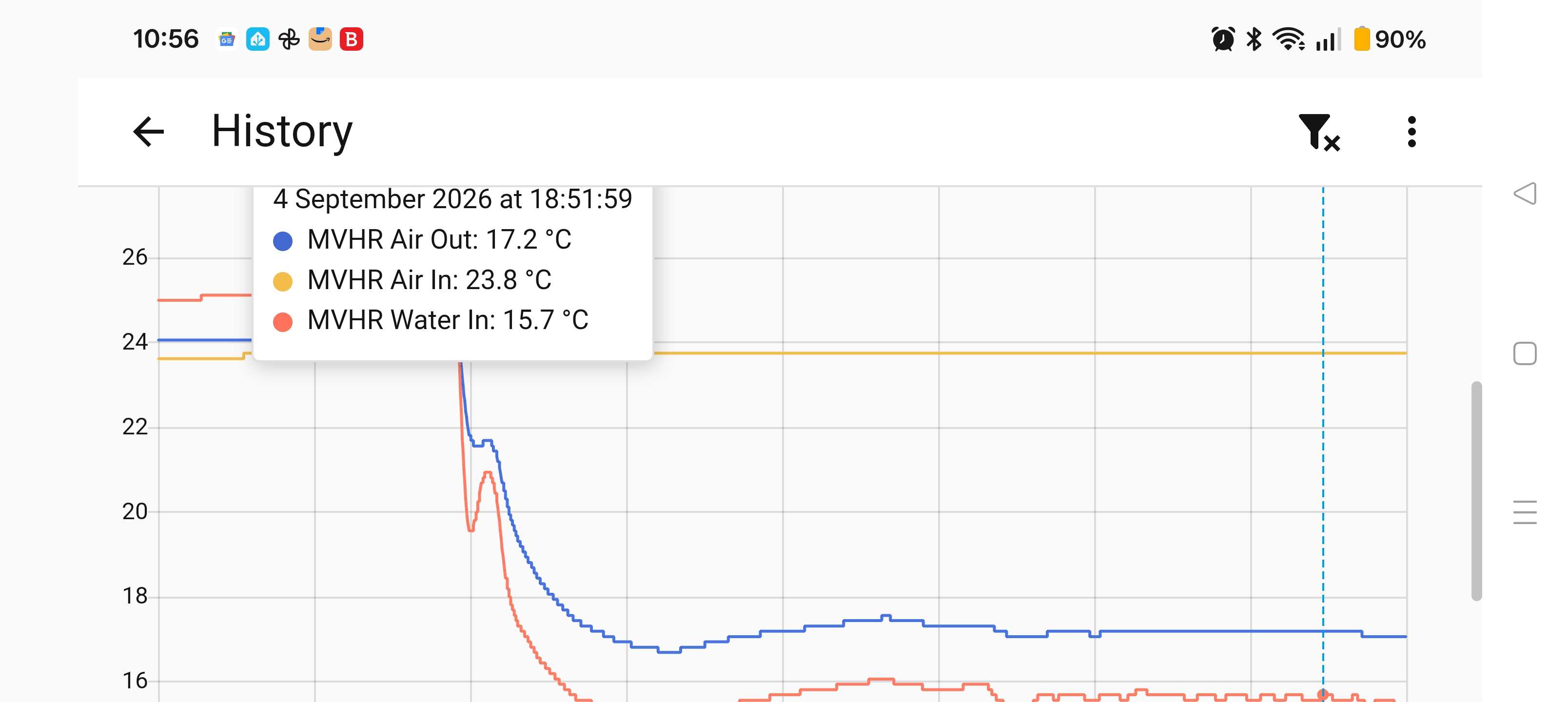

That's because you are thinking the wrong way. With UFH (cooling) it's not really about cooling the airspace, will come that in a second.  The floor surface becomes cooler than your body, its primary cooling method is a radiant heater in reverse.  Your body is the heat source and the floor sucks the heat from you. The second thing it does, is it becomes a heat sink for the building fabric, it again sucks the heat away.  Biggest thing we noticed when we did UFH cooling was the thermostat on wall only reads a couple of degrees cooler. But you feel way cooler and more importantly the whole building gets back to a nice temperature way quicker.
We have recently also added a DIY MVHR cooler (car heater matrix installed into a duct filter housing), not because it's just like Aircon, because it isn't, as airflow rates are way to low, but because it cools the air coming into the building and gets to the high areas in rooms. That air is about 6 degrees cooler than it would otherwise be. So over a few hours has a cooling effect.
A chart showing the effect on the air existing the MVHR unit to go into the rooms
Screenshot_2026-09-07-10-56-10-50_c3a231c25ed346e59462e84656a70e50.thumb.jpg.fa428225577d0c63d97e62aea293ff11.jpg
The yellow line is air temperature as it leaves the MVHR unit.
Blue is after the heat exchanger
Red is water temperature.
