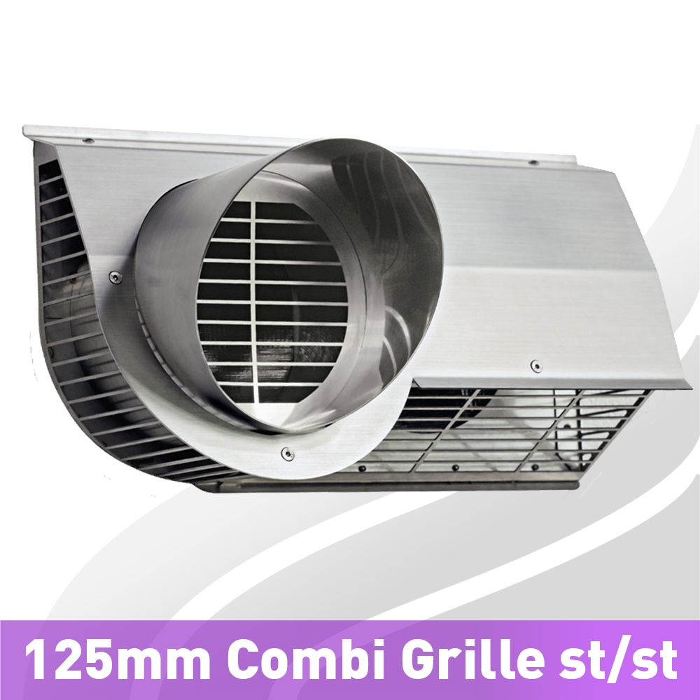

52 minutes ago, Oz07 said:
around 2m apart
Not required if you use a combined/directional inlet outlet. One of our two MVHR units is in the middle of the house, the two ducts effectively go in void above built-in wardrobes to the outside wall. Our manifolds are in the same void. But it only feeds two bedrooms and extracts from two bathrooms.
Never heard of them. Are they limited to smaller systems? Why do you have 2 units?
You can get from 125mm to 200mm so should cover all domestic properties.
https://www.paulheatrecovery.co.uk/product-category/mvhr-ducting/terminals-external/

2 minutes ago, saveasteading said:
They would need rather a strong flow speed to ensure the expelled air is sent clear.
A ran for a year at minimum speed and never saw any mixing going on by monitoring temperature. Out flow is rejected horizontally outwards, inwards flow comes from below and the sides, so out flow has a hard job making it's way back in.
Cool. What do you have 2 holes through the wall and they just connect into these? Neat solution. I went through roof tiles at my last place. How did you get on with your SAP with the titon units did you buy these before the design stage or did you change your as built SAP to allow for them?
We go through icf wall, so pre installed plastic ducts before the concrete pour.  You have the two ducts with an 50mm or so gap between them.
No issues with SAP, like the Titon units as they are UK manufacturer and the you can actually talk technical to a person on the same wave length. Buying cheap I had a speed signal issue on one of the motors, parts arrived the next day to fix with instructions. Great service.
Being Scotland we do a sap at design and completion. I had all the routes of ducts all designed in during design and I actually bought the 2x MVHR units at the design stage, prior to getting the as designed sap. So no issues.
