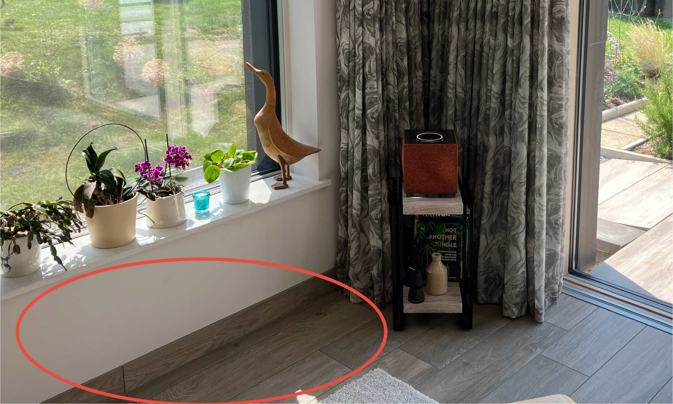

Hmm...  I will be having the floors tiled, so mopping will be happening!
Where we have tiled floors we used the same tile as the skirting. Looks good and hard as nails (obviously depends on the size of your tiles for this option to be considered).

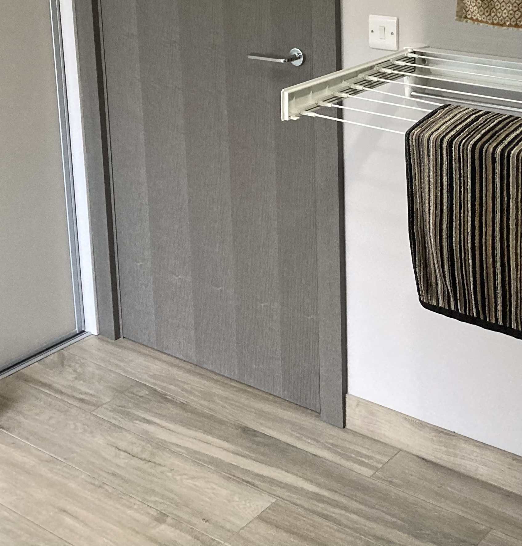

interesting, I’ve seen this on my holidays in the apartments.  how have you interfaced with door architraves?
 We’ve having a modular rustic tile fitted on the floor, I’ll check the catalogue and see what options they have listed to see if it could pass muster!
Also, depending on tiles used the top cut edge might not look great. Looks good if done well though.
Just butted up to the architraves.
Yep, good point. Our tiles are cut in half length ways and the factory edge faces up for exactly that reason.

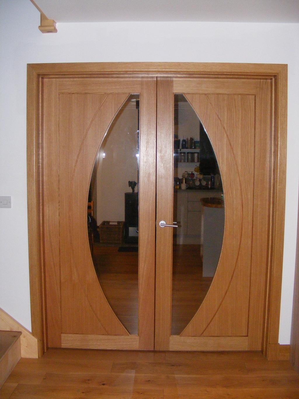

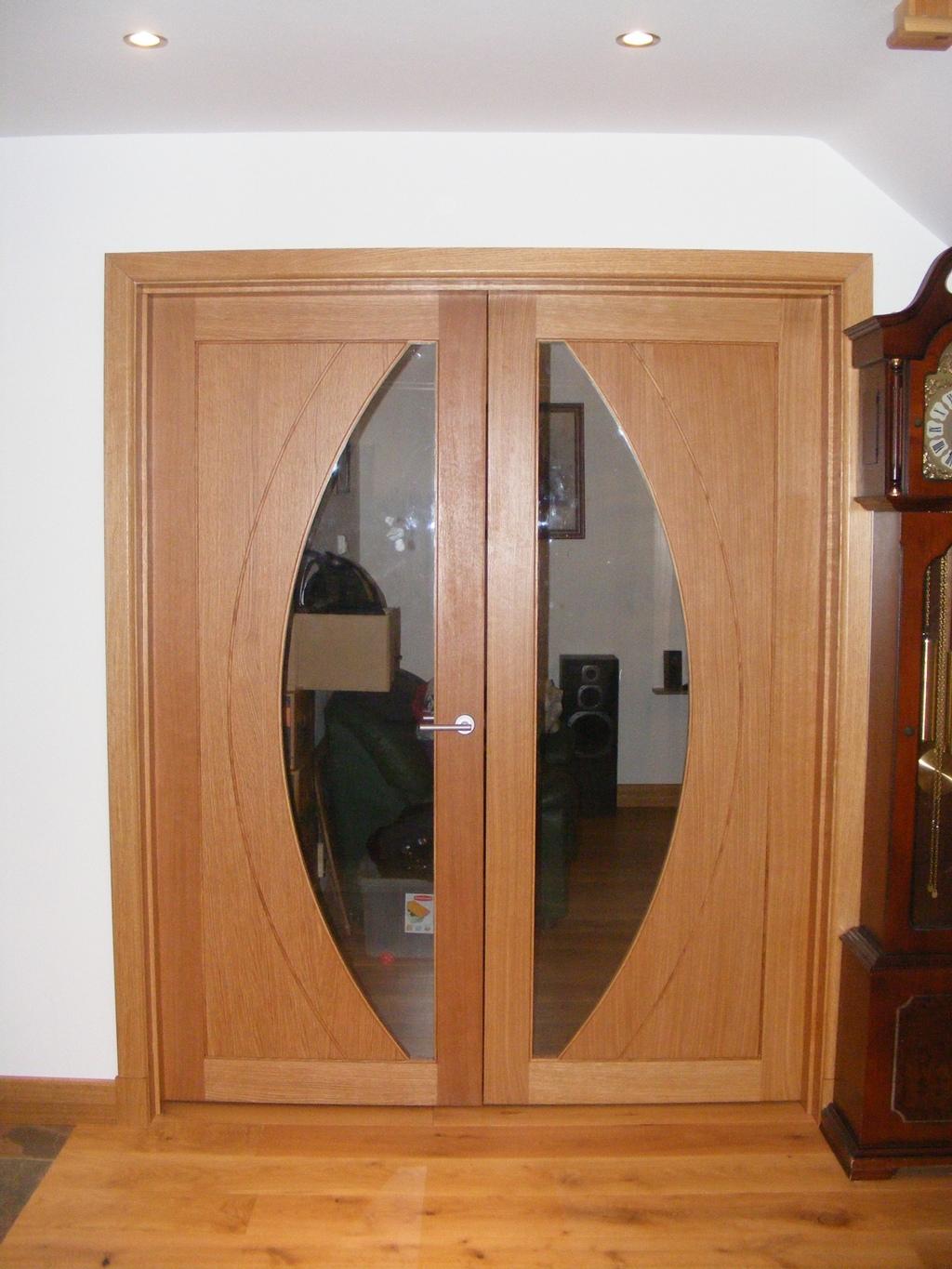

I used Oak veneered arcs and skirtings from Howdens, finished with Osmo oil.  Matches nicely to the real Oak door frames.
Annoyingly because we had chosen 2040mm tall doors, one length of Howdens Oak veneered arc was just too short to do two door uprights, so to avoid huge wastage, I used corner blocks to join arc to skirting.
Floors do get mopped from time to time, no sign of issues with the veneered MDF skirting.  Just be sensible and take a little care.
If I recall, mdf has a grain, so the ends will be more absorbant. The @ProDave block solves that for the architraves.
I really like the blocks.
Makes it look more 'expensive' imho. Done this a load of times, and when I show the client they say "yes please".
