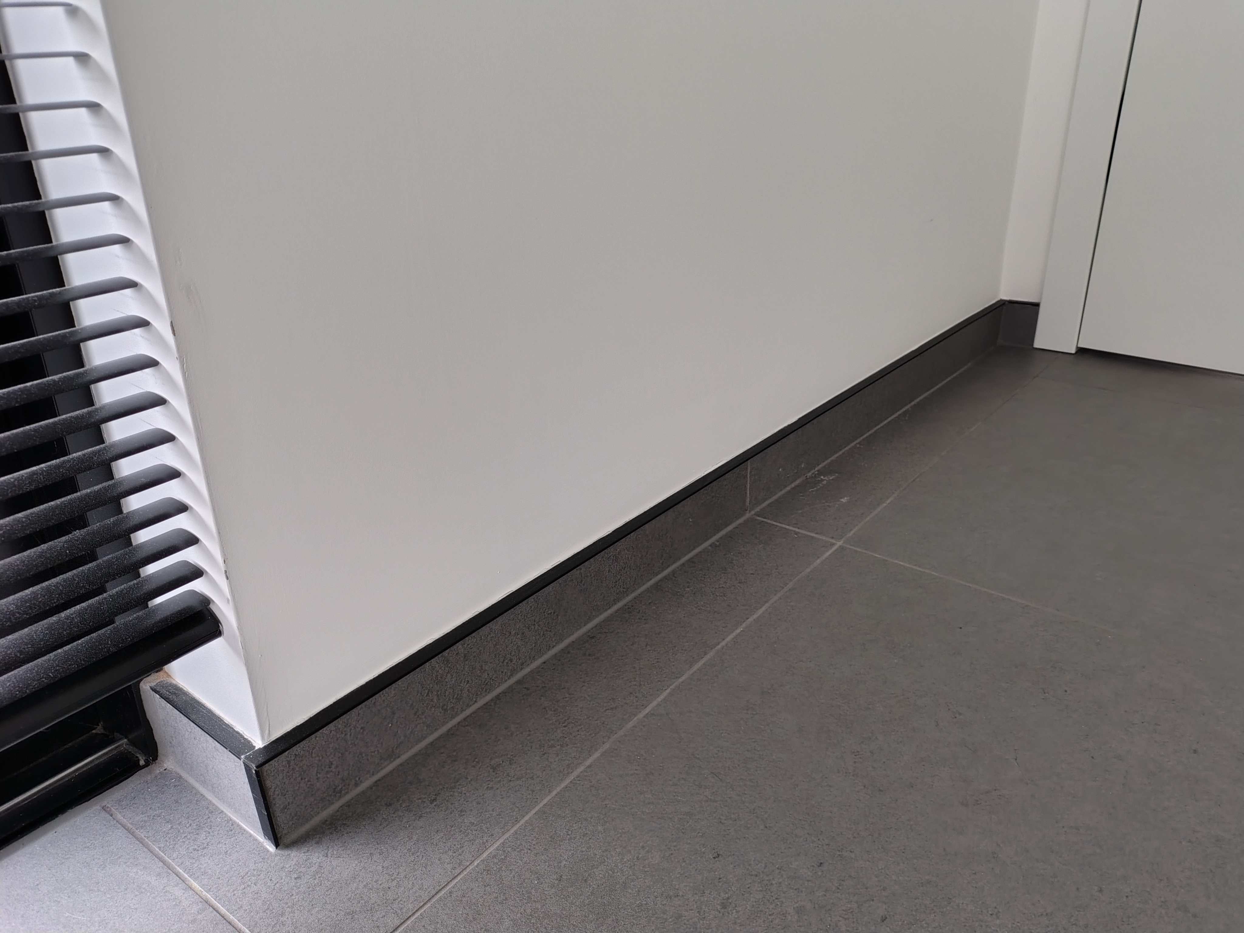

February 26Feb 26 23 hours ago, Russdl said: Just butted up to the architraves. Yep, good point. Our tiles are cut in half length ways and the factory edge faces up for exactly that reason. We have MDF in all the carpeted rooms, no problems whatsoever, no damage on external corners. No knots to prime. If done properly I see absolutely no issue with MDF (apart from the dust 😷) Ours were cut into strips and we used tile edging strip along the top edge - this gives a great finish and easier to get a horizontal line. I say we - our tiler did it of course. Being able to cur them into strips means less wastage. and like other replies having a tile skirting means no issues with mopping.
February 26Feb 26 Author yeah, nice! I do like the tiled skirting tbh. I think I'm going to wait for the tiles to be laid then I will get some samples cut and see what look we get. The tile we have chosen is a stone effect with tumbled edge, so may or may not lend itself to a tile skirting.
February 26Feb 26 1 hour ago, crispy_wafer said: yeah, nice! I do like the tiled skirting tbh. I think I'm going to wait for the tiles to be laid then I will get some samples cut and see what look we get. The tile we have chosen is a stone effect with tumbled edge, so may or may not lend itself to a tile skirting. You can bin off the tumbled edges and just use the centre 'meat' of the tile, adding a trim on the top to finish it. Curved 1/4 round trims would probably be more sympathetic to a tumbled tile / rustic look.
February 26Feb 26 6 minutes ago, Nickfromwales said: You can bin off the tumbled edges and just use the centre 'meat' of the tile, adding a trim on the top to finish it. Curved 1/4 round trims would probably be more sympathetic to a tumbled tile / rustic look. The other option with porcelain/ceramic tile is to have mitred edges with a sliver of face tile on top resin bound. Load of extra labour in it though.
February 26Feb 26 Just now, -rick- said: Load of extra labour in it though Boatloads. My Rubi DU 200 radial wet bench cutter makes this a LOT easier, but still a massive ballache.
February 26Feb 26 Author 3 minutes ago, Nickfromwales said: You can bin off the tumbled edges and just use the centre 'meat' of the tile, adding a trim on the top to finish it. Curved 1/4 round trims would probably be more sympathetic to a tumbled tile / rustic look. The manufacturer offers a rectified tile, so I can definitely get a nice straight edge, it's more how they look when crossing over the tumbled edge and grout line, but thinking about it that would be the same as if I selected timber anyway. They also offer a specific skirting tile, but I'd need to speak to the local tile supply man to see how much he can import them for. Quick google suggests £16'ish, if thats for 1 then that's too dear for me, and I choose the cut route.
