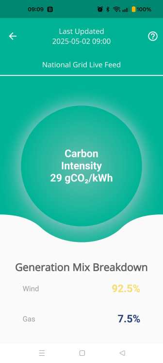

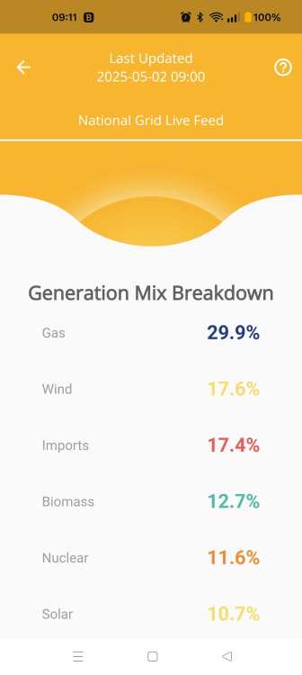

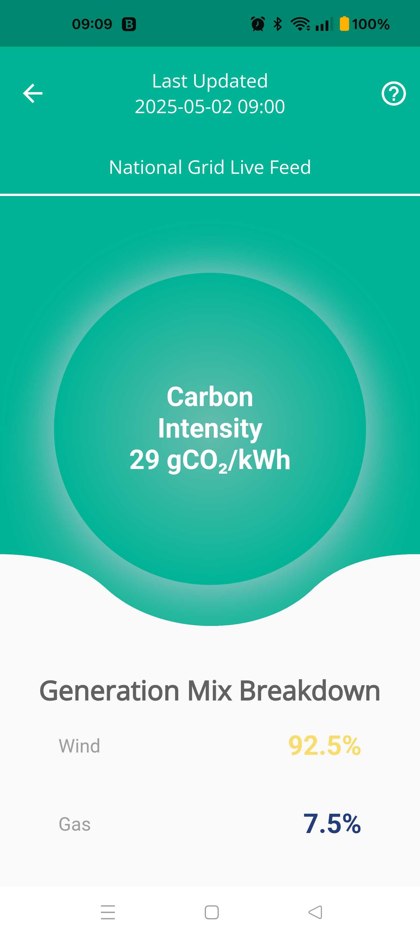

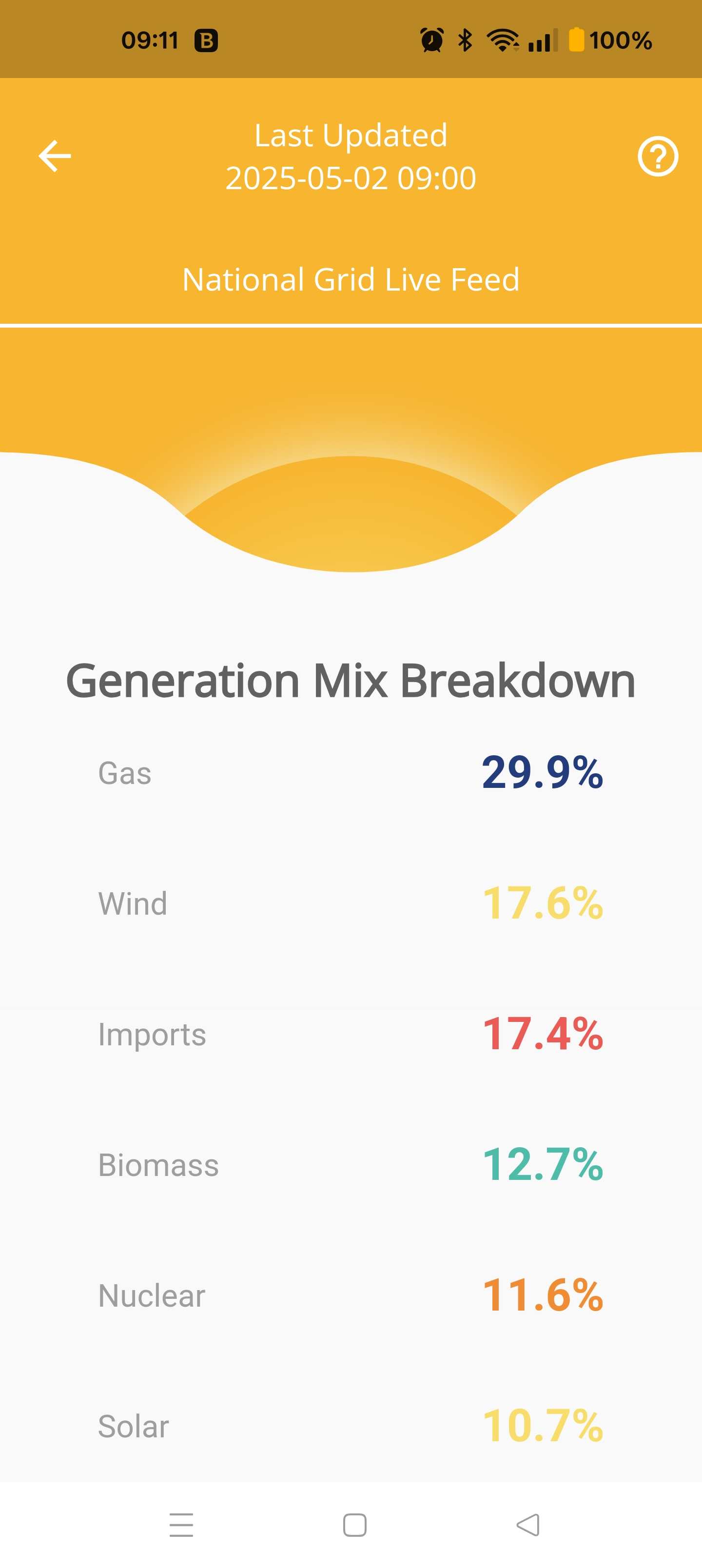

JohnMo Posted May 2, 2025 Posted May 2, 2025 (edited) 23 hours ago, ProDave said: Yet in spite of that, wind was producing about 11% of our electricity Just had a look today, so our local energy mix - NE Scotland. So mostly wind Then looking at UK as a whole Very different story, comparing local grid to UK wide. Edited May 2, 2025 by JohnMo Added NE Scotland 1
ProDave Posted May 2, 2025 Posted May 2, 2025 1 hour ago, JohnMo said: Very different story, comparing local grid to UK wide. As I keep saying. Scotland has enough wind generation for now. It is further south that needs more so time for them to have most of their hills covered in wind farms. 1

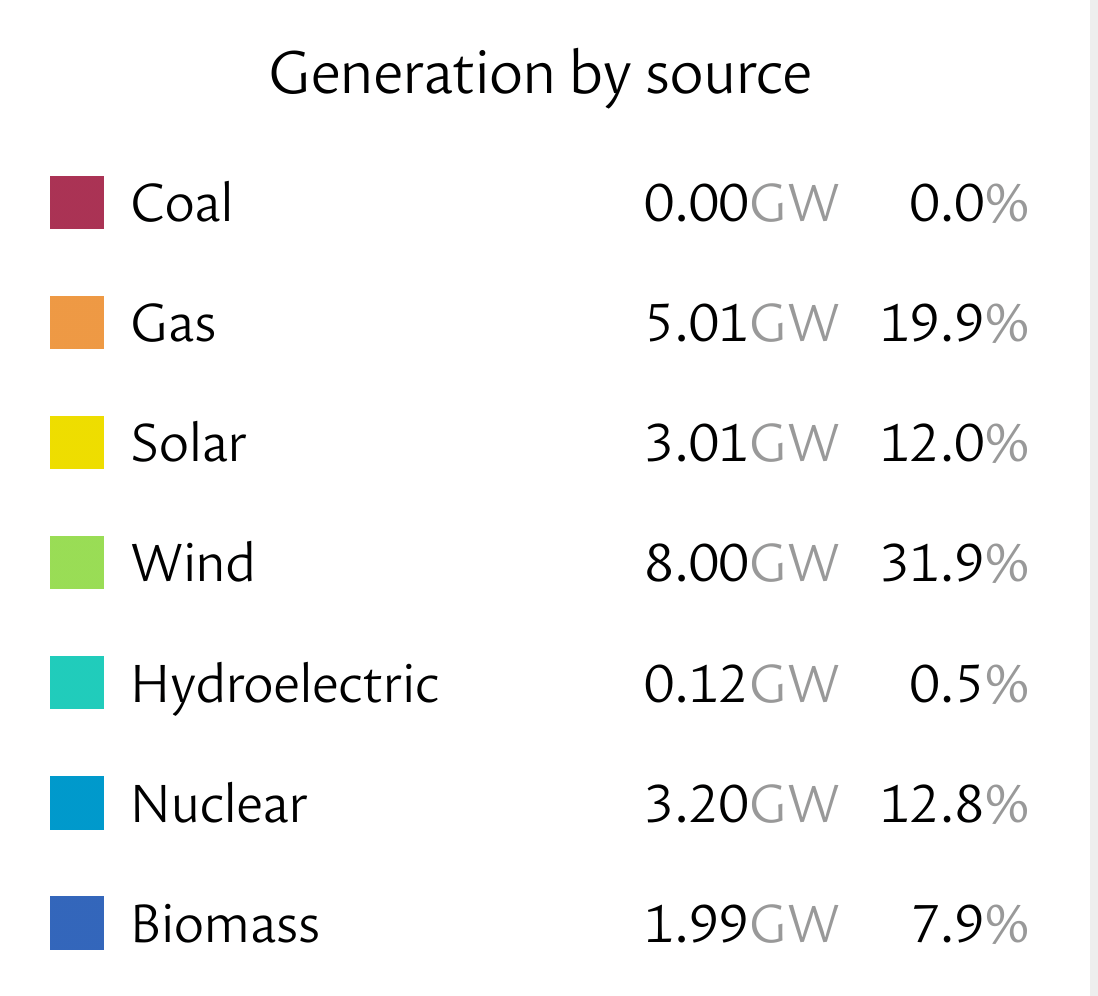

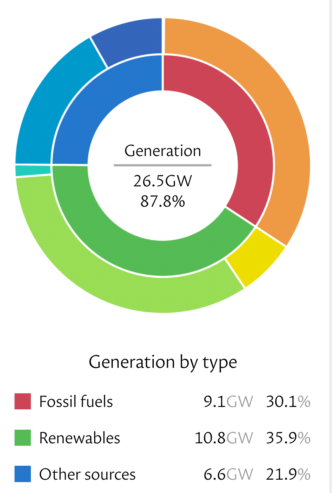

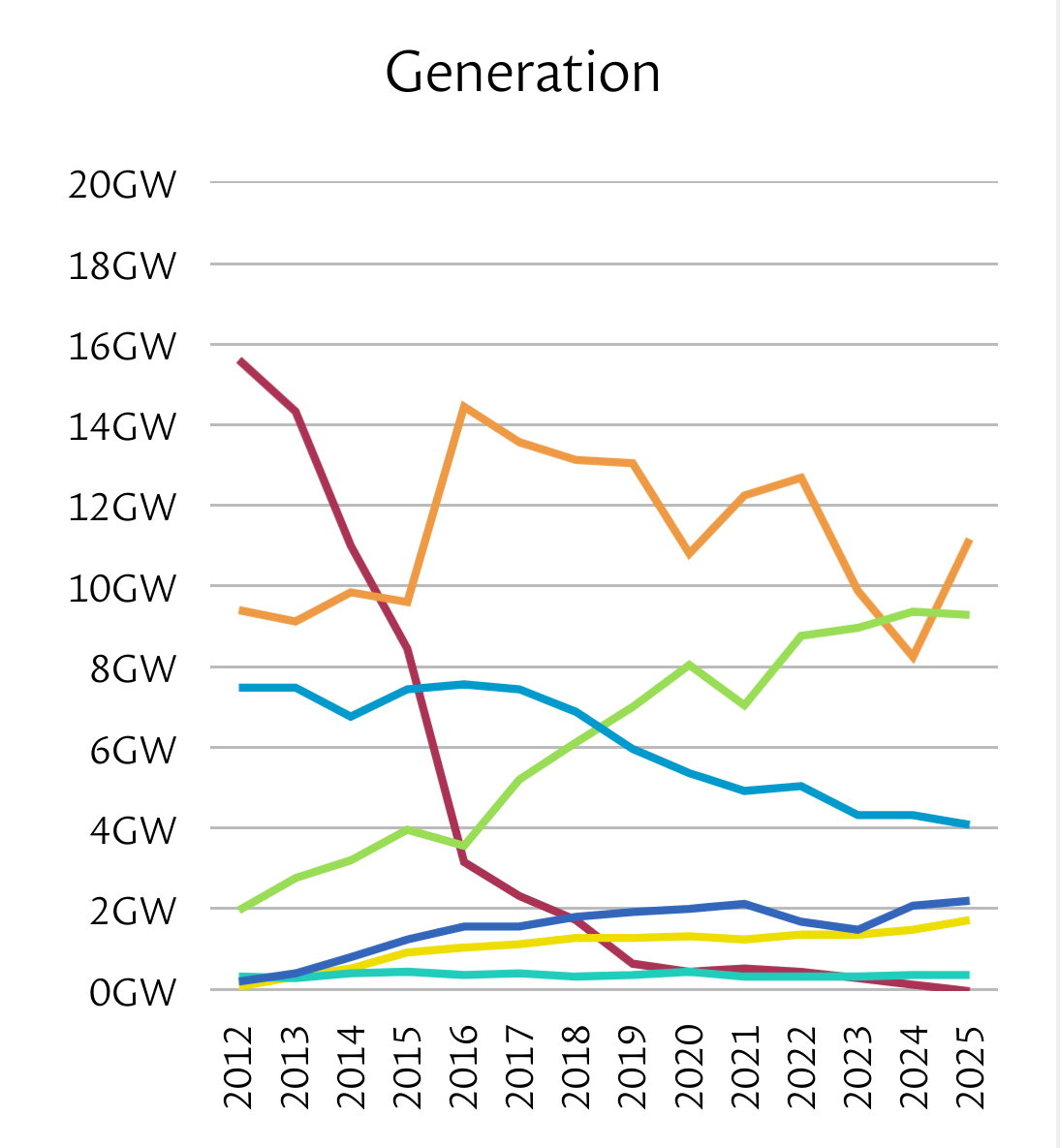

Beelbeebub Posted May 3, 2025 Author Posted May 3, 2025 On 01/05/2025 at 09:45, ProDave said: Yesterday was reasonably windy here (enough to need a reef in the sail) so you would expect wind generation to be reasonable. Yet in spite of that, wind was producing about 11% of our electricity while we were at that meeting. When you say "our" do you mean your local area or the UK? Just because it is windy in one place doesn't mean it's windy everywhere. Over the past day wind has generated nearly 1/3 of our electricity and renewables over half. Over the last 12 months just shy of 36% of our electricity has come from renewables. Greater than the just over 30% from fossil fuels (gas mainly) This is absolutely amazing. In under 15 years renewables have replaced all of our coal use and about 50% of our nuclear use.
