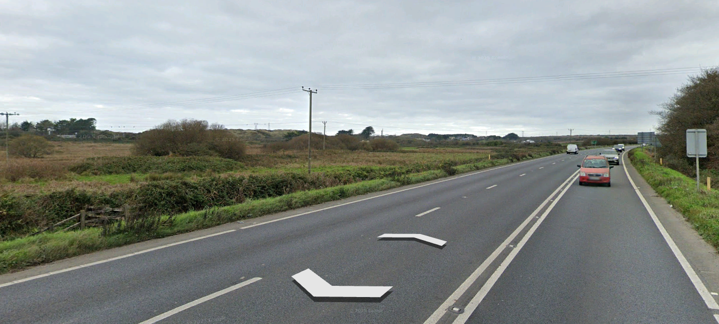

While some inertia is useful, it has to be remembered that large electrical grids run on a predictive statistical model, not on reactive feedback.  There is also the radial design of the network that would have worked against itself.  There is only so much extra power that can be injected into a single bulk transmission line.  The UK grid is a ring design, which allows for more entry point for distributed generation.
This is partly why the European Super Grid is such an important infrastructure project, even of a couple of countries got taken off grid, it would still function.
As we transition from centralised generation to distributed generation, and increase our reliance of electricity (however it is generated) to replace fossil fuels (mainly gas heating and transport), we are just going to have to accept that more cables have to be run around the country.
The below picture is on my daily drive along the A30 near Hayle, you can see the sandy towans on the left.  The power station was closed in the early 70's.
