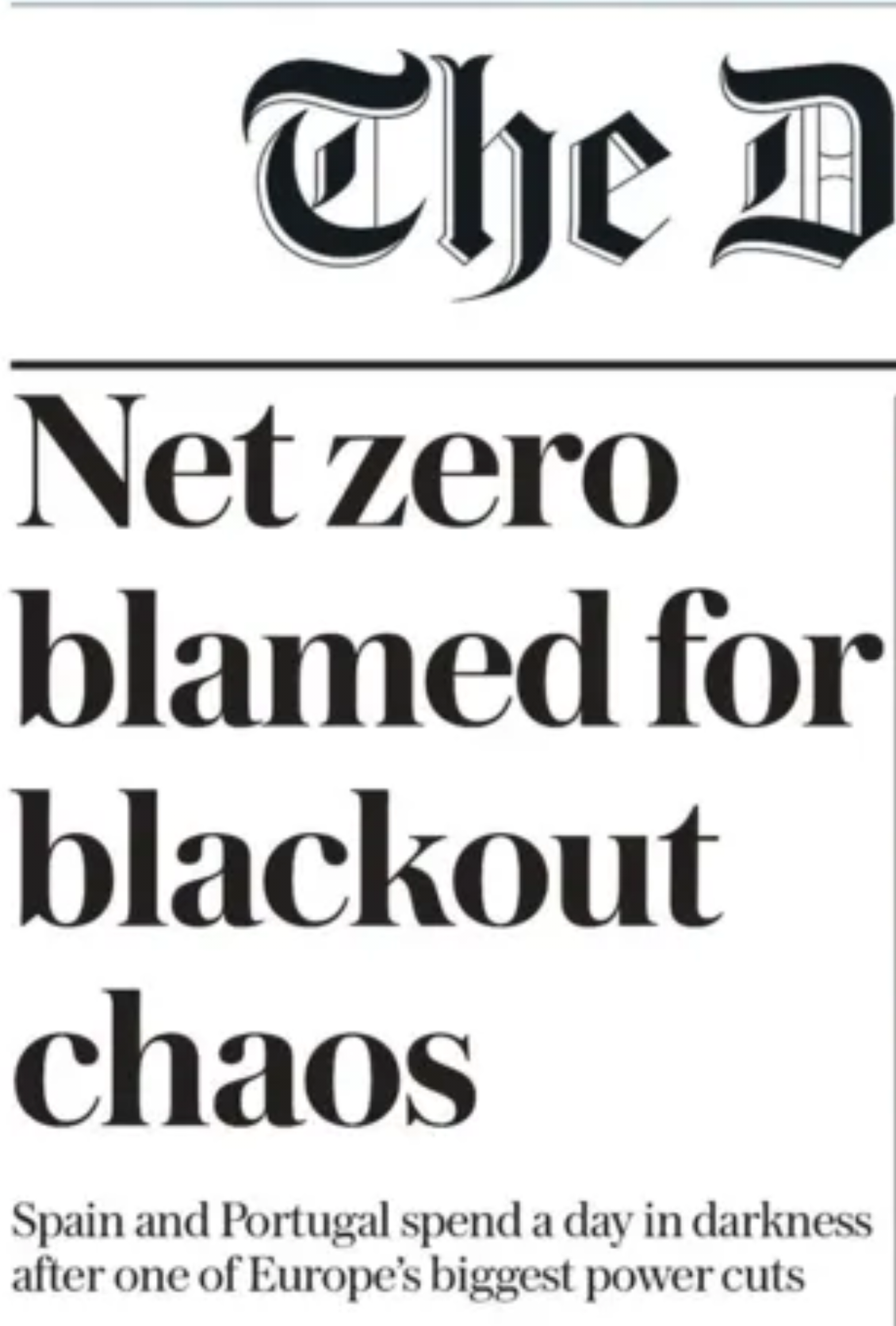

Predictably the Telegraph blames "net zero"...
Screenshot_2025-04-29-06-17-28-318_org.mozilla.firefox.thumb.png.8af64226199bcacb803b3fe755166ddb.png
They talk about "experts say" but never really say who the experts are.

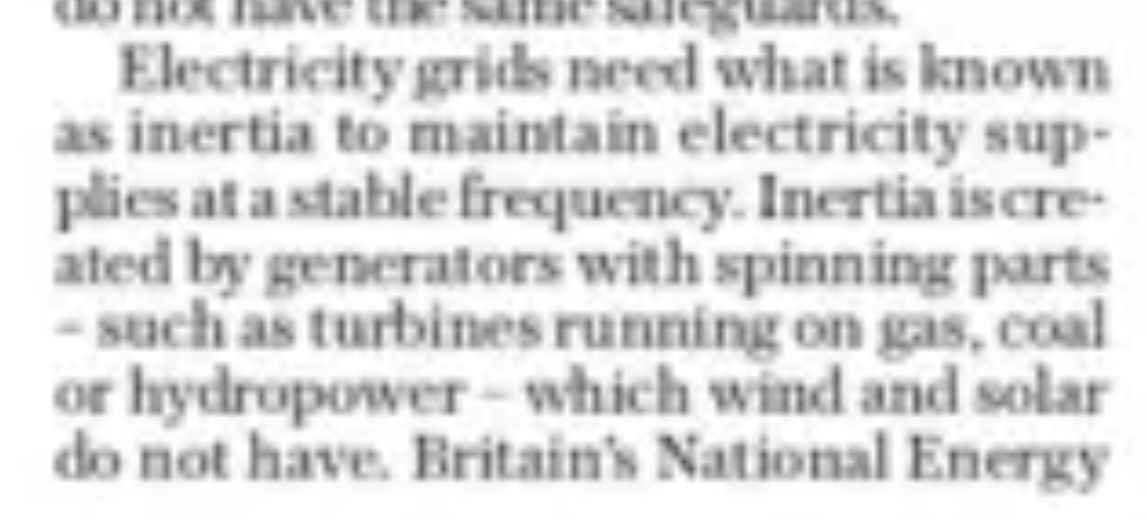

And then there's this...
Screenshot_2025-04-29-06-17-40-587_org.mozilla.firefox.thumb.png.7c58bc67341f1ebc1b1d5b0364898116.png
Wind turbines famously lack any spinning parts.....
They do rotate but their moment of inertia is relatively low due to slow speed. If the wind drops they can stop within a revolution due to drag. Large turbines will keep spinning (and generating electricity) for several minutes when cut off, giving operators precious time to switch over to another source.
Isn't the telegraph agenda to blame everything on net zero. So just normal reporting from them. So why bother reading it.

You do need "spinning mass" to maintain a stable frequency.  Wind turbines yes they spin but they then use an inverter to synchronise to the grid frequency.  So does PV and battery storage.
The unknown is when there are no real spinning mass generators, has anyone worked out how to synchronise a grid supplied entirely from millions of inverters, which one is the master for instance?
It is not net zero that caused this, but the drive to more and more renewables may be making it harder to re start the grid.
