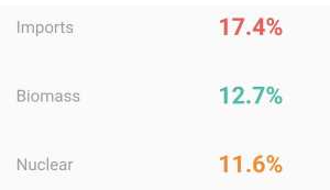

Do we know if the power imported constantly from France is listed here under imports or nuclear?
3 hours ago, ProDave said:
Blame Mrs T.  It was under her watch we closed down the UKAEA and with that development of our home grown reactors which we used to build a lot quicker than that.
Although, to be fair, our home grown AGR reactors were crap.
Edited by Beelbeebub
As far as I know it is just as an import.

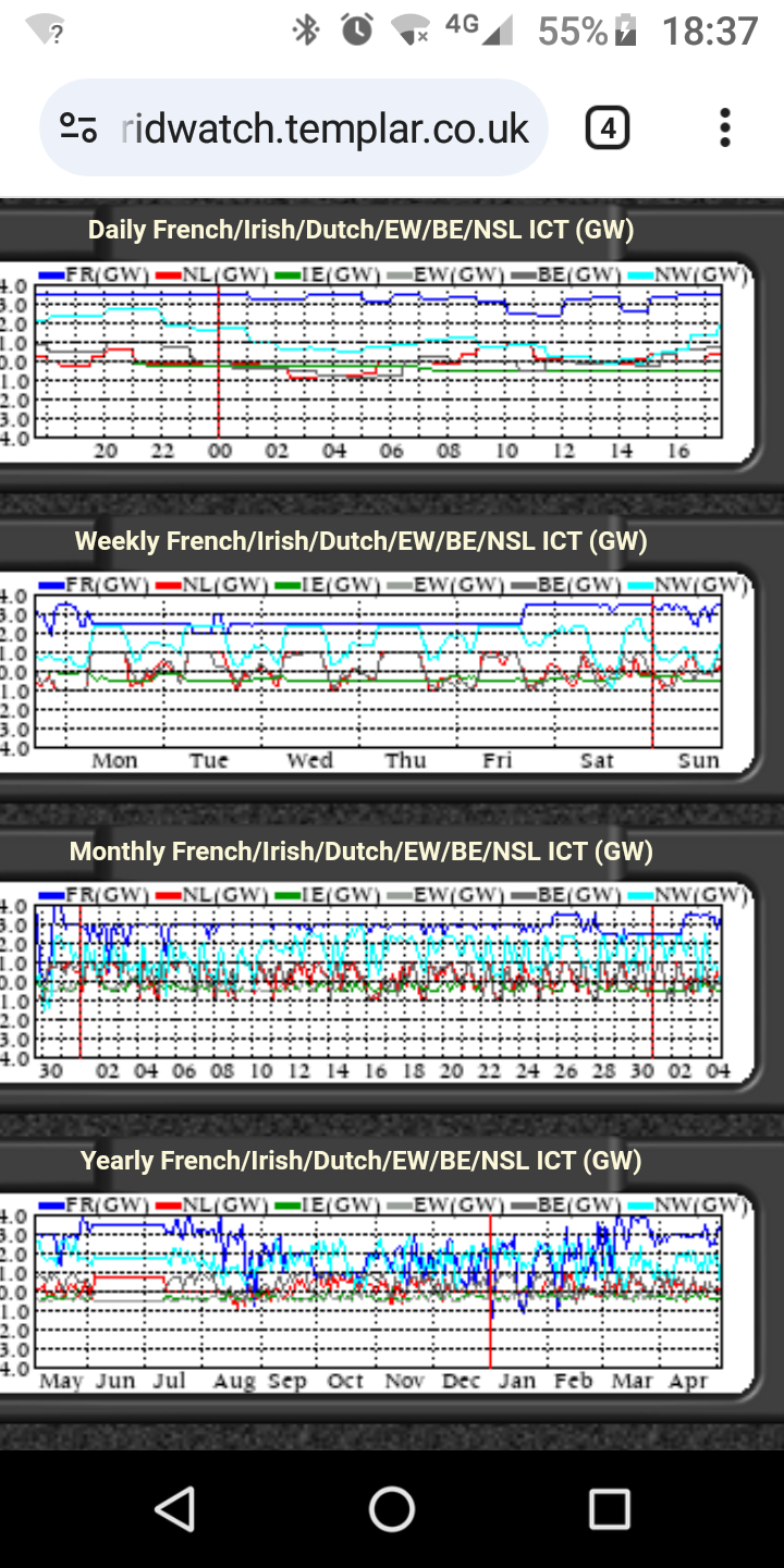

Just for a laugh here is the French grid data for the last week.
Edited by SteamyTea

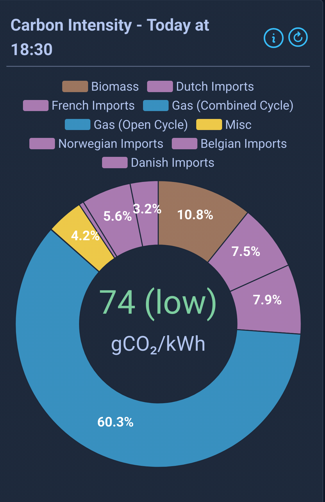

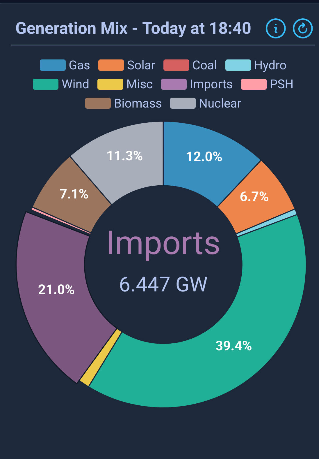

If you look here
https://www.energydashboard.co.uk/live
Which comes from the same ultimate source it splits out imports by country and CO2
For example today...
Screenshot_2025-05-04-18-45-02-542_org.mozilla.firefox.thumb.png.c045e3ad808c96b89ee8d5268615671b.png
The French imports are the 7.9%
And wind is nearly 40% of total and gas is that tiddly 12% (but sets the prices for the rest)
Screenshot_2025-05-04-18-47-33-739_org.mozilla.firefox.thumb.png.d83ca2554cbca8f18f899e789b1b2189.png
Might be being set by pumped storage, batteries or nuclear, depends what the auction price was. Not enough of our generation is in the CfD system.
But it is totally barmy that after 3 years of primary energy volatility, we have not sorted this out. There must be some emergency laws that allows the contracts to be broken.

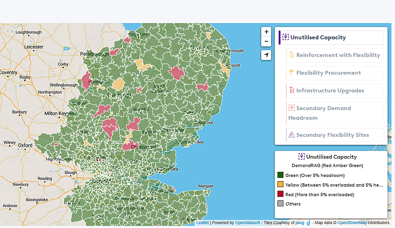

To show what I mean about using local substations, rather than individual houses to store energy, here is the current usage map from UK Power Networks for the SE of England.
Would be pretty pointless putting local storage into the green areas, and there really is not that much red and yellow.
All good points about the possibility of local substation store
The counter would be the tech for the home batt system is already here from multiple vendors
There aren't any planning or space issues.
The per house would be part funded by householders, probably the richer ones. The subsidy being maybe lower vat or some sort of rebate.  That rebate could be scaled for companies or technologies we deem worthy eg UK manufactured systems or new chemistries like sodium thus giving an industrial benefit.
The per house would give very good resilience against a Spain style blackout - plus alot will split "critical" circuits that are backed up (eg lights, freezers, comms) from non critical stuff like drivers or ev chargers to improve the runtime per stored kwh. This isn't easy for a substation system which woukd have to support people charging EVs, taking showers etc during a blackout.
The per house would also make peak shifting /shaving more of an individual choice rather than enforced from above.
