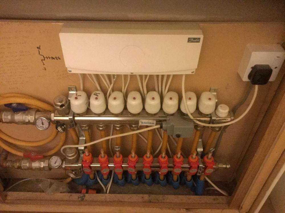

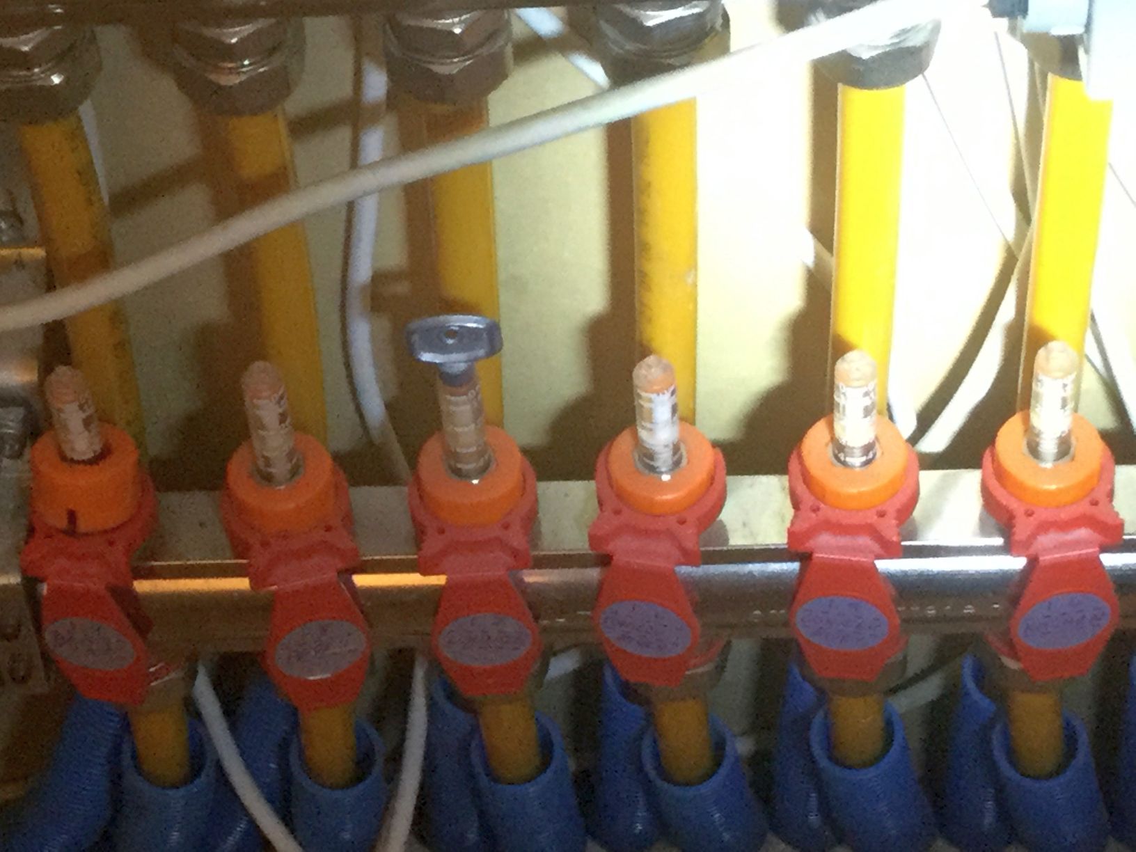

Gone West Posted December 12, 2017 Share Posted December 12, 2017 (edited) 12 hours ago, Nickfromwales said: I think it's @PeterStarck that has the uber nice looking plastic manifolds, one where I have to concede the point as it does look pretty damn good ? The manifolds are metal and virtually everything is Speedfit. It's a bit cramped but I've managed to squeeze everything in. We don't like the look of copper pipes so we've only used them for the D1 and D2 pipes. It'll all be hidden away in a cupboard eventually. Edited December 12, 2017 by PeterStarck 2 1 Link to comment Share on other sites More sharing options...

jack Posted December 12, 2017 Share Posted December 12, 2017 7 minutes ago, PeterStarck said: That is truly a thing of beauty. Puts me in mind of those amazing structured cable installations you sometimes see: 1 Link to comment Share on other sites More sharing options...
Nickfromwales Posted December 12, 2017 Share Posted December 12, 2017 22 minutes ago, PeterStarck said: The manifolds are metal and virtually everything is Speedfit. The blue, red and hard to see white collars are the horseshoe shaped circlips that keep the JG stuff from undoing themselves. Nice touch having them all colour coded for hot cold and softened etc. ? 1 Link to comment Share on other sites More sharing options...

Ferdinand Posted December 12, 2017 Share Posted December 12, 2017 (edited) 1 hour ago, Nickfromwales said: The blue, red and hard to see white collars are the horseshoe shaped circlips that keep the JG stuff from undoing themselves. Nice touch having them all colour coded for hot cold and softened etc. ? Do those white boxes contain any auto-balancing gubbins, or is it just room-stat connections to the actuators? I am trying to get to grips with mine for the first time and all of my flow meters show zero. Does that mean that autobalancing is happening, or that the system is in some kind of lockdown, or that they are stuck, or that someone set them to zero before we bought the house ? We certainly get heat through it, but the flow and return temps are 20C different (50 vs 30 with the boiler at current setup) - which seems high. This is my install: Edited December 12, 2017 by Ferdinand Link to comment Share on other sites More sharing options...

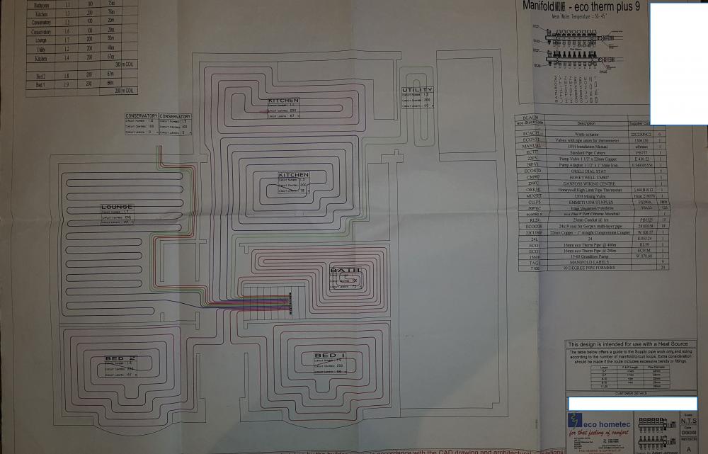

Nickfromwales Posted December 12, 2017 Share Posted December 12, 2017 Given that ian will end up with a manifold and UFH, and even though a slight digression, I think it'll be useful to the topic . So... The unit the plug goes into is the wiring centre ( Wctr ), the room stats connect to the Wctr, and the actuators get controlled by the Wctr. The acuators are dumb if they are 2-wire, or they're active if 4-wire ( as with 4-wire each actuator has a switched pair that close when the actuator is fully open and that would then directly control the manifold pump ). You've likely got 2-wire by the look of the Wctr and the pump relay will / is likely to be inside the WCtr. Is the pump pump speed on low / 1? That's a lot of heat going in TBH, so what's the floor construction? I'd dial the temp back to 35-38oC going in and change the pump speed to med / 2. Link to comment Share on other sites More sharing options...
Ferdinand Posted December 12, 2017 Share Posted December 12, 2017 44 minutes ago, Nickfromwales said: Given that ian will end up with a manifold and UFH, and even though a slight digression, I think it'll be useful to the topic . So... The unit the plug goes into is the wiring centre ( Wctr ), the room stats connect to the Wctr, and the actuators get controlled by the Wctr. The acuators are dumb if they are 2-wire, or they're active if 4-wire ( as with 4-wire each actuator has a switched pair that close when the actuator is fully open and that would then directly control the manifold pump ). You've likely got 2-wire by the look of the Wctr and the pump relay will / is likely to be inside the WCtr. Is the pump pump speed on low / 1? That's a lot of heat going in TBH, so what's the floor construction? I'd dial the temp back to 35-38oC going in and change the pump speed to med / 2. Flow temp dialed back to 40C via the boiler control, now reflected on the input side temp guage, and I have opened the controls on the circuits to rooms currently in use - lounge, 2 x in kitchen, bathroom, utility. We also have 2 bedroom circuits which I have left closed for now. Each is now showing flow of around 1 (litre per minute?). I have also set the indiivdual room stats (mechanical dial) high, and the programmer to "Manual" to stop them interfering. Is the pump the grey box in the first pic? Do I need to look for a switch to set it to fast? Cheers F Link to comment Share on other sites More sharing options...

Nickfromwales Posted December 12, 2017 Share Posted December 12, 2017 9 minutes ago, Ferdinand said: Flow temp dialed back to 40C via the boiler control, now reflected on the input side temp guage, and I have opened the controls on the circuits to rooms currently in use - lounge, 2 x in kitchen, bathroom, utility. We also have 2 bedroom circuits which I have left closed for now. Each is now showing flow of around 1 (litre per minute?). I have also set the indiivdual room stats (mechanical dial) high, and the programmer to "Manual" to stop them interfering. Is the pump the grey box in the first pic? Do I need to look for a switch to set it to fast? Cheers F The grey box is a pipe / cylinder stat and it's there to stop the pump from spinning if the flow manifold temp exceeds the set point. Basically it's a failsafe should the primary means of thermostatic control fail If this is off a system boiler or combi then the manifold pump may well have been wrongly omitted . Is there no pump at the manifold? Can we have a zoomed out pic? My fault for not seeing the HL stat as that's prob why you weren't getting any flow. The boiler was lighting, sending way too hot water to the manifold and the HL stat was shutting the whole thing down. More detail of system components / pic of under boiler etc please. Something is missing here me thinks. Link to comment Share on other sites More sharing options...
