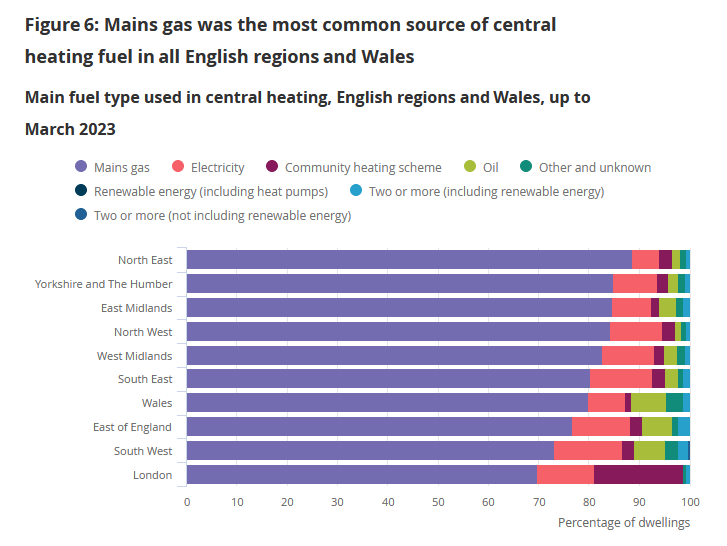

Crofter Posted 13 hours ago Share Posted 13 hours ago I agree, but I presume that the focus on replacing gas boilers is because they are far more common than direct electric heating. Does anybody have numbers on this? FWIW, last year I installed A2A to replace my storage heaters. Didn't go looking for any sort of grant, in my experience grant schemes just tie you up in their requirements. I spent £4200 for a 10kw system ducted to five outlets. I did a good amount of the work myself, but had the supplier of the unit do the refrigerant lines. It would have been nice to not have had to pay for that myself but I didn't think I qualified for any sort of help. Link to comment Share on other sites More sharing options...
Beelbeebub Posted 13 hours ago Share Posted 13 hours ago 3 minutes ago, Crofter said: I agree, but I presume that the focus on replacing gas boilers is because they are far more common than direct electric heating. Does anybody have numbers on this? FWIW, last year I installed A2A to replace my storage heaters. Didn't go looking for any sort of grant, in my experience grant schemes just tie you up in their requirements. I spent £4200 for a 10kw system ducted to five outlets. I did a good amount of the work myself, but had the supplier of the unit do the refrigerant lines. It would have been nice to not have had to pay for that myself but I didn't think I qualified for any sort of help. It varies by area but I think the national average is around 9% Are you haply with the system? £4200 is not a crazy amount for a new heating system. Yes, the anti HP brigade bang on about how you can get a new boiler for under a grand, but unless you are doing a really simple like for like swap of a heat only boiler with a cheap non vat one man band fitter you're going to be closer to £1,500. Add in upgrades due to new regs (eg condensate drains) and some replacements of old parts like valves and rads and you coukd easily be towards £3-4k. I've had quotes for £5-6k for fitting an a2a multisplit to a storage heater flat. That's probably less than fitting it out with a gas and rad system. https://www.ons.gov.uk/peoplepopulationandcommunity/housing/articles/census2021howhomesareheatedinyourarea/2023-01-05 Link to comment Share on other sites More sharing options...
BotusBuild Posted 12 hours ago Share Posted 12 hours ago 3 hours ago, Beelbeebub said: The only wrinkle is a lot of electric systems are in flats Exhaust air heat pumps are designed for flats. Also helps with humidity reduction -> mold reduction -> health improvement. A Win, Win, Win Link to comment Share on other sites More sharing options...
SBMS Posted 12 hours ago Share Posted 12 hours ago Couldn’t agree more @ProDave think the ONS reports around 11%/2 million homes use direct electric heating - less than 1% use an ASHP. I believe that the BUS grant funding covers up to around 33k homes so the ambition is so low… you’re right though target those 33k homes. I would wager as well that those with electric only heating have a cylinder whereas those on gas might have a combi and no space for the cylinder so aren’t a great fit for a heat pump. Link to comment Share on other sites More sharing options...

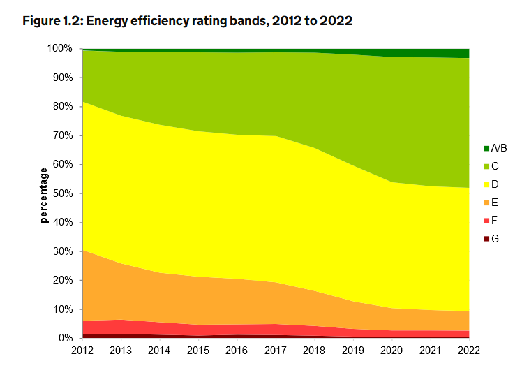

Alan Ambrose Posted 11 hours ago Share Posted 11 hours ago OK, some stats: + 19% of homes are privately rented, 17% 'socially rented', that's 36% i.e. ~1/3rd of homes where the landlord would have to pay for the installation (including a rental void period) with the financial benefit of lower heating costs accruing to the tenant. That going to happen very rarely. + overlapping with that, 22% of dwellings were flats. Yeah, realistically impossible for flat owners to install ASHPs. + overlapping with that, 31% of dwelings in UK have no EPC rating (only required since 2007). We can reasonably conclude that they are mostly old enough to have sub-standard insulation and therefore not suitable for an ASHP. + overlapping with that, about 50% of homes that have EPCs are D or below and are probably not suitable for ASHPs. + overlapping with that, 74% of households use gas (plus 5% using oil) and therefore don't have any financial incentive to change. + of houseowners, 15% of private owners without mortgages are poor (Joseph Rowntree Foundation) and 17% of those with mortgages i.e. they don't have enough money to invest. + 2% of homes are listed and there are 10,000 conservation areas - both of which are either unsuitable or impossible to swap to an ASHP. + we don't have any idea how all those segments overlap, but just from EPC ratings (or lack of them) 2/3rds of dwellings are not suitable for heat pumps, 3/4 have gas already and no incentive to change. (EPCs are, of course, nonsense anyway as the main insulation areas (roof, floor, walls) may just be 'assumed'.) + plus it requires personal energy, money, time and the ability to endure the disruption and uncertainty that installation of an ASHP would require. You may also have to battle at your expense with the planners, who have no incentive to be reasonable. + many people may just be sitting on the fence as they know that government doesn't always get it right (viz. diesel cars); technology may improve, installers may be better skilled etc. 1 Link to comment Share on other sites More sharing options...
G and J Posted 10 hours ago Share Posted 10 hours ago So (19% + 17% + 22% + 31% + 50% + 74% + 15% + 17% + 2% ) = 278% of homes aren’t suitable for a heat pump. Crumbs. I’m no mathematician, but that seems a lot. 😉 I think we need to demolish more buildings or accept slow progress towards net zero. Link to comment Share on other sites More sharing options...
