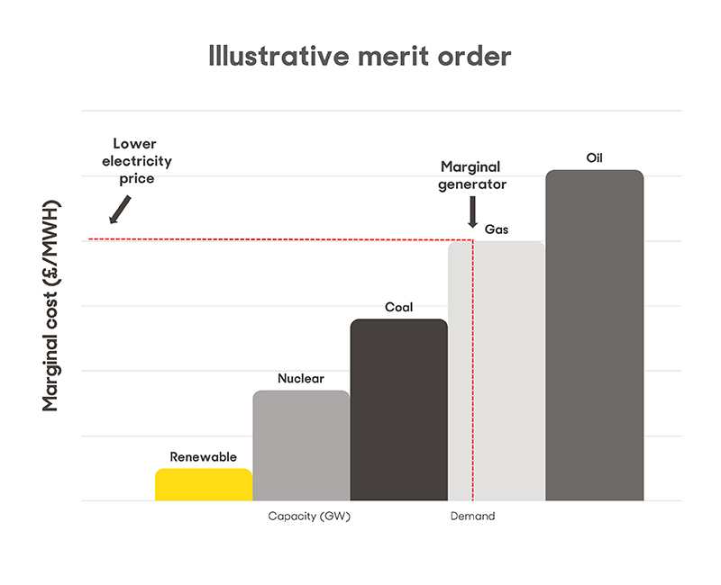

>>> Reforming the energy market to get rid of the "last unit sets price" method would be a huge win for electricity.
Something I've seen referred to bit on 't 'ub together with its relationship to gas prices rather than, say, PV prices. Possible to explain a bit?
The way the wholesale price per unit is set like auction.
The network requests X Mwh and various generators put up bid to supply some Mwh at a set price.
The network then accepts the bidsfrom lowest rom lowest nit upwards until it's got enough.
So far so normal.
But the wrinkle is, the prove paid per Mwh *to everybody* is the price of the last unit bought ie the most expensive.
Let's say in a simple setup 1000mwh is asked for.
Solar bids 300mwh at £100
