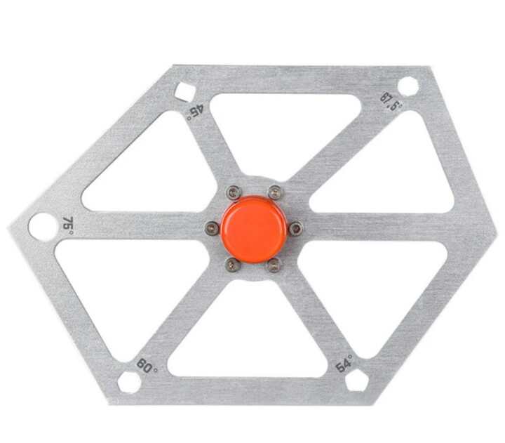

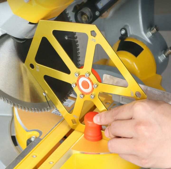

I don't have mine set up on a bench just grab it, manhandle to where I'm working, the car etc. I then need to set it up every time if I want an exactly square cut. I use one of these:
OSALADI Carpentry Angle Ruler Industry Protractor Angle Miter Gauge Miter Angle Finder Metal Stencils Finder Measuring Ruler Goniometer Angle Finder Aluminum Alloy Work Carpenter Magnetic https://amzn.eu/d/fsI2C8O
Useful as a periodic checker even if the saw is set up on a bench. It allows a fairly acceptable degree of repeatability for say mitre cuts.

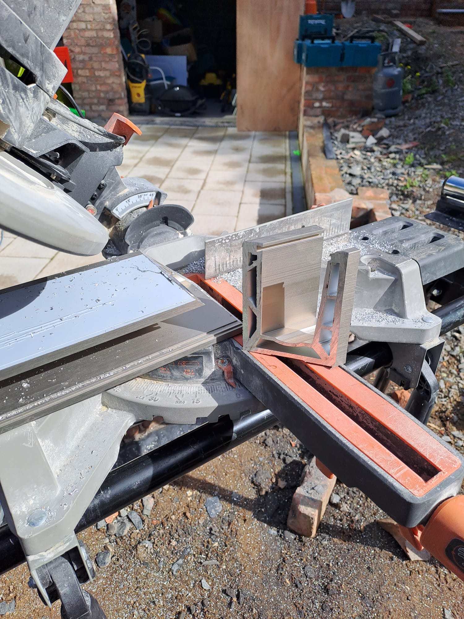

My mate has a big DeWalt sliding mitre saw, several hundred Pounds worth. The Evolution and DeWalt are streets apart. He'll do 6" skirting on his and it's perfect. By the same token his can't cut conduit, Unistrut or with a change to the Evo diamond blade, brick slips.
Imo the Evo saw is nearer to a rough and ready shed/fence building saw than something a proper chippy would use for say cabinet making.
