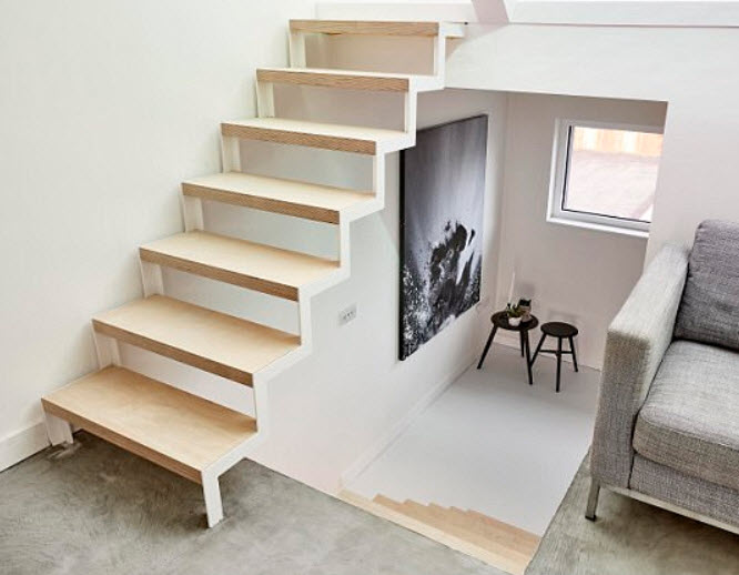

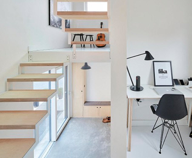

PeterW Posted October 25, 2017 Posted October 25, 2017 2 minutes ago, Barney12 said: Blink and you will miss the 5 second camera shot of the Sunamp. But you can play guess the budget overrun at every turn..... and how did the front door and stairs pass building regs ...??
Barney12 Posted October 25, 2017 Posted October 25, 2017 Just now, PeterW said: But you can play guess the budget overrun at every turn..... and how did the front door and stairs pass building regs ...?? I said exactly the same thing to myself about the entrance. Mind you not much point in a Part M entrance as you wouldn’t get much further in a wheel chair! The internal stairs open risers looked wider than 100mm to my eyes!
PeterW Posted October 25, 2017 Posted October 25, 2017 2 minutes ago, Barney12 said: I said exactly the same thing to myself about the entrance. Mind you not much point in a Part M entrance as you wouldn’t get much further in a wheel chair! The internal stairs open risers looked wider than 100mm to my eyes! Unless that's the argument ..!! No access as no real space ! No rail or banister !

Barney12 Posted October 26, 2017 Posted October 26, 2017 (edited) 10 hours ago, PeterW said: Unless that's the argument ..!! No access as no real space ! No rail or banister ! Actually, I'd say they were bloody lethal. You could fall a full two stories with ease and straight onto a metal steel angle! Death would be HIGHLY probable if you hit your head. How the feck can that have been achieved? Perhaps the reality is that they don't even have sign off from building control? It really naff's me off, the rest us spend our life jumping through god knows how many hoops to keep the right side of the BCO and then the likes of Grand Designs just produces a load of tabloid tat. Rant over Edited October 26, 2017 by Barney12 1

jack Posted October 26, 2017 Posted October 26, 2017 The "no rails" thing has happened several times on Grand Designs. I've always assumed they installed something for sign-off and then removed it. I particularly remember this one by Kathryn Tyler in Cornwall. We stole a few ideas from that house, but not the rail-less stairs!

Jeremy Harris Posted October 26, 2017 Posted October 26, 2017 The recurring theme of obvious non-compliance with building regs on Grand Designs needs to be addressed, I think, especially as we seem to regularly get breaches that aren't just minor stuff, but really significant safety-related issues, like staircases without rails or any protection from falling. I understand that the programme is primarily about the aesthetics of design, and so they take the view that the look is more important than the function is some cases, but they are creating an expectation with some viewers that it's perfectly OK to have potentially dangerous features, as long as they match the aesthetic of the building. In terms of heating demand, last nights house was pretty much the same as ours. We had minor over heating at first, caused primarily because we created a very sheltered spot by digging back into a South-facing slope, which increases the outside air temperature a couple of degrees above that we used to model the thermal performance. I learned pretty quickly that a well-insulated house is far more susceptible to relatively small changes in incidental heat gain, including solar gain, than I'd anticipated. Nothing that couldn't be managed, but I fell into the trap of worrying far more about the heating system, rather spring and autumn overheating (spring and autumn are by far the worst times, because of the lower sun angle and deeper penetration into the house, we've found).
