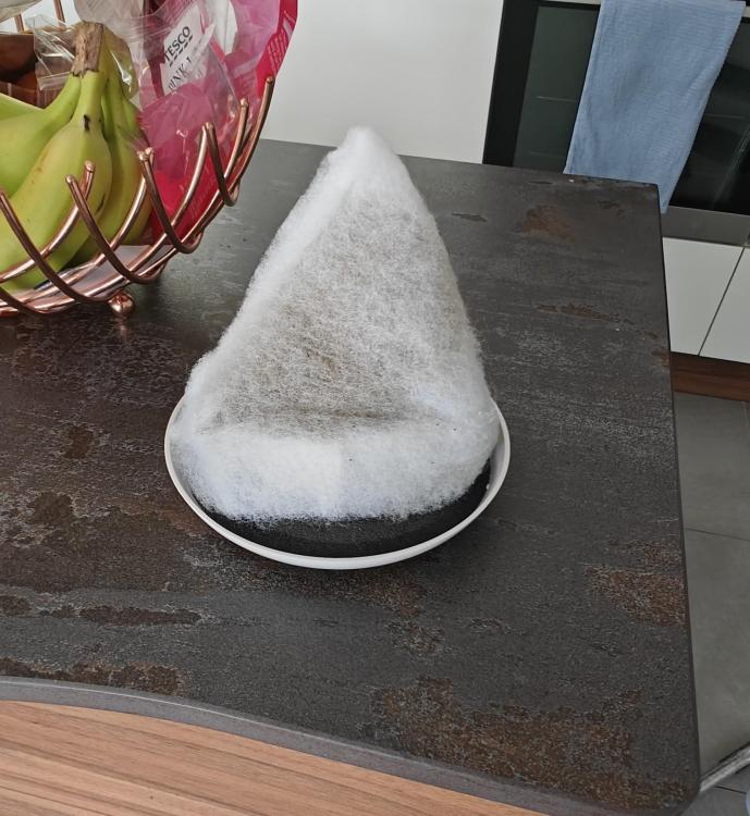

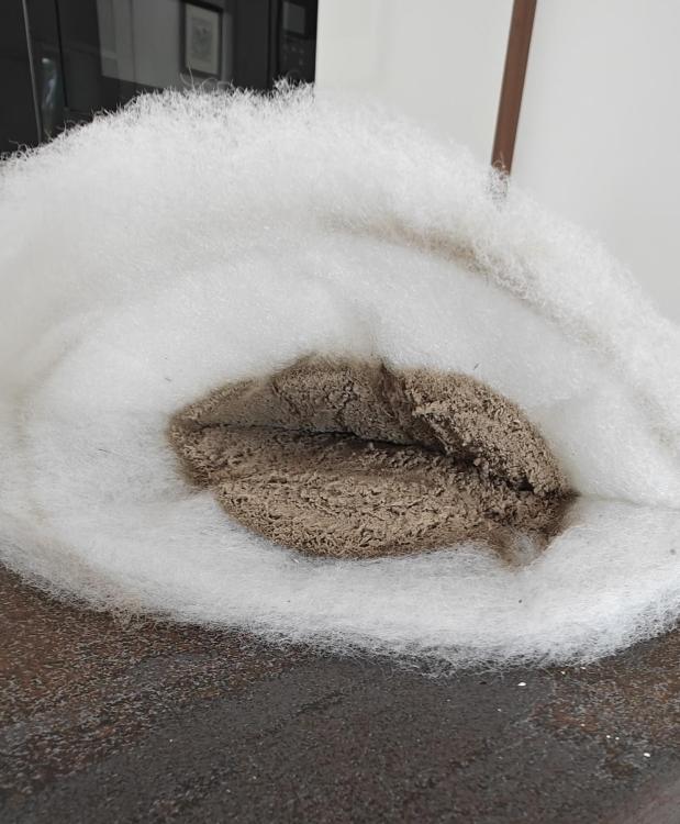

JohnMo Posted April 1, 2024 Share Posted April 1, 2024 8 minutes ago, ProDave said: Recirculating cooker hood with carbon filters and MVHR extract vent nearby but not directly coupled. Boost the MVHR rate while cooking if you want to. As Dave says, but I have the extract at the other end of the kitchen and have a foam filter mesh inside to catch anything that may get into the duct work. Rarely need to use the cooker hood. 1 Link to comment Share on other sites More sharing options...

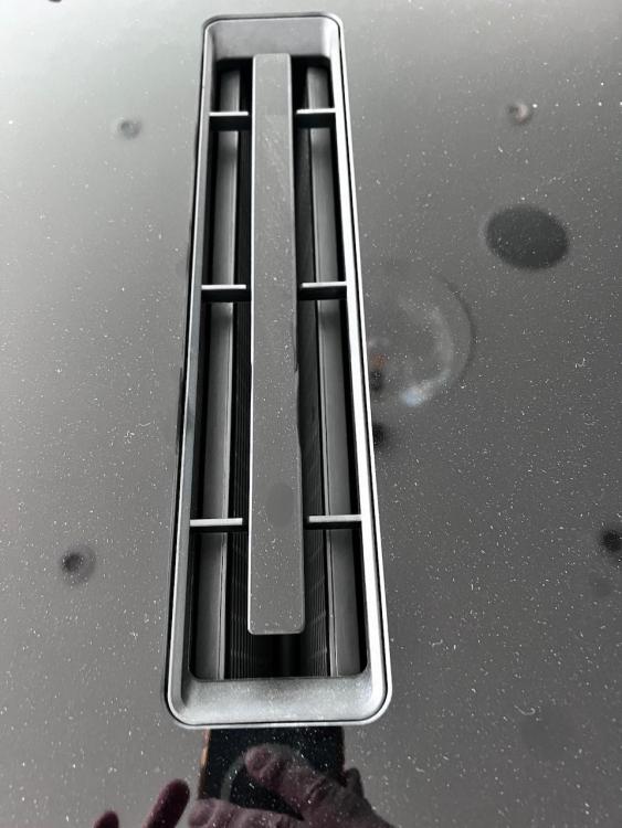

Kelvin Posted April 1, 2024 Share Posted April 1, 2024 (edited) We have a recirculating hob with grease and carbon filters with a nearby MVHR extract. I’ve set the hob to manual operation of the extractor though rather than it automatically coming on with the hob. Edited April 1, 2024 by Kelvin 1 Link to comment Share on other sites More sharing options...

JohnMo Posted April 13, 2024 Share Posted April 13, 2024 20 minutes ago, CalvinHobbes said: well used chip pan Get an air fryer - way better chips. Took me awhile to be converted 1 1 Link to comment Share on other sites More sharing options...

Kelvin Posted April 13, 2024 Share Posted April 13, 2024 We debated for some time about whether to extract to outside or use a recirculating hob but this was more about air quality in an open plan design than air tightness. Because of some aesthetic design decisions we decided on a recirculating hob with the caveat that we hardly ever fry food. We will also need to ensure we replace/clean the filters much more regularly than any other house we’ve lived it. Most cooker extraction hoods are far too high above the cooker to be effective anyway even if they are extracting externally. If you look at commercial kitchens you’ll often see the hood is much closer to the bob than in domestic kitchens. 1 Link to comment Share on other sites More sharing options...

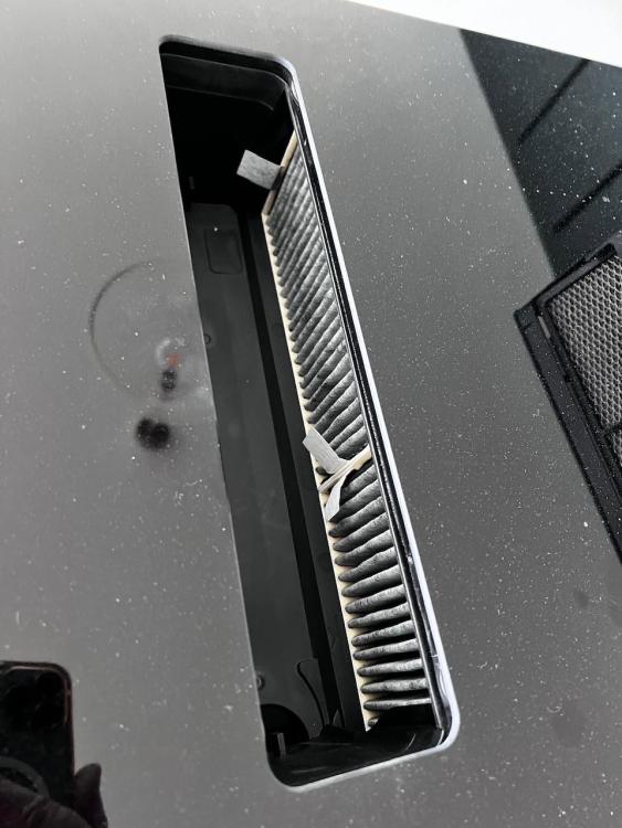

saveasteading Posted April 13, 2024 Share Posted April 13, 2024 6 minutes ago, Kelvin said: hood is much closer to the bob than in domestic kitchens. In forehead bashing position! @Kelvin where are the filters in yours? And they are disposable, not cleanable? Link to comment Share on other sites More sharing options...
Kelvin Posted April 13, 2024 Share Posted April 13, 2024 2 hours ago, saveasteading said: In forehead bashing position! @Kelvin where are the filters in yours? And they are disposable, not cleanable? Inside the hob. There are two sets of filters. Disposable carbon filters and washable grease filters. Link to comment Share on other sites More sharing options...
saveasteading Posted April 13, 2024 Share Posted April 13, 2024 58 minutes ago, Kelvin said: Inside the hob. In a cassette that comes easily out? Link to comment Share on other sites More sharing options...
Kelvin Posted April 13, 2024 Share Posted April 13, 2024 28 minutes ago, saveasteading said: In a cassette that comes easily out? They are individual but yes easy to get out. There’s also a container underneath the hob to catch any spills. Link to comment Share on other sites More sharing options...
garrymartin Posted April 13, 2024 Share Posted April 13, 2024 Extract from my research notes that might be helpful; Recirculating cooker hood with grease (typically steel/aluminium mesh) and charcoal/carbon filters with a MVHR extract vent nearby but not directly coupled. Boost the MVHR rate while cooking if you want to (current sensor on induction hob cable for automation??) Grease filters need cleaning regularly; every 1-3 months Charcoal/carbon filters have a lifetime (usually 3-12 months; check manufacturer specifications) and should be replaced Try to get a model with grease filters that can go (and fit) in the dishwasher and that will not tarnish, or that can be replaced (should you wish to) SMEG, for example, has a Universal Charcoal filter Stainless Steel AISI 304. The filter can be washed in the dishwasher at 50°C (water and suitable detergent) and to dry, put in the oven 180°C for 25 minutes 1 Link to comment Share on other sites More sharing options...
