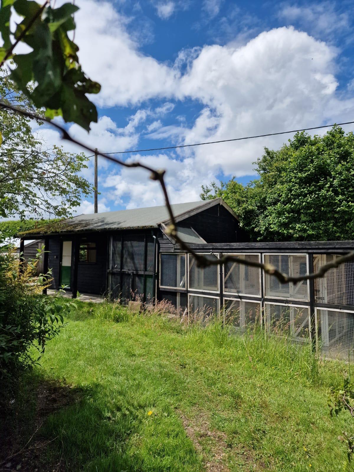

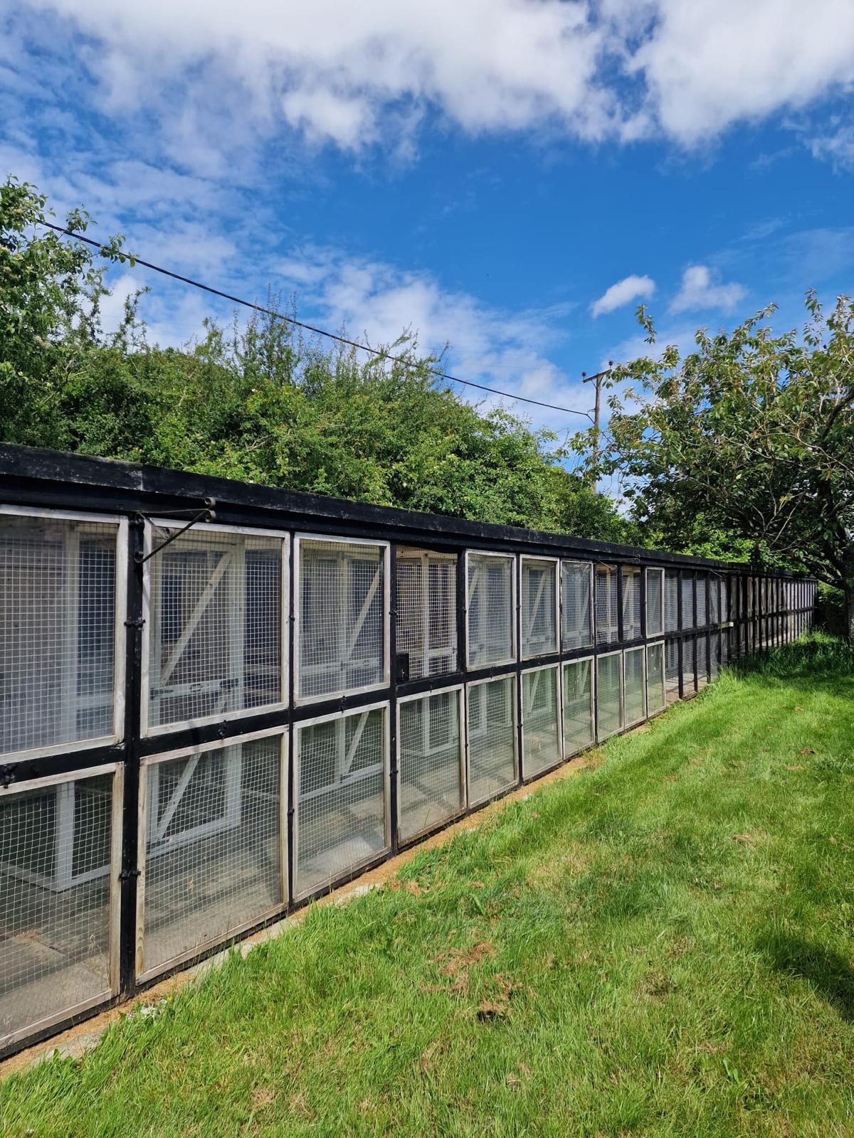

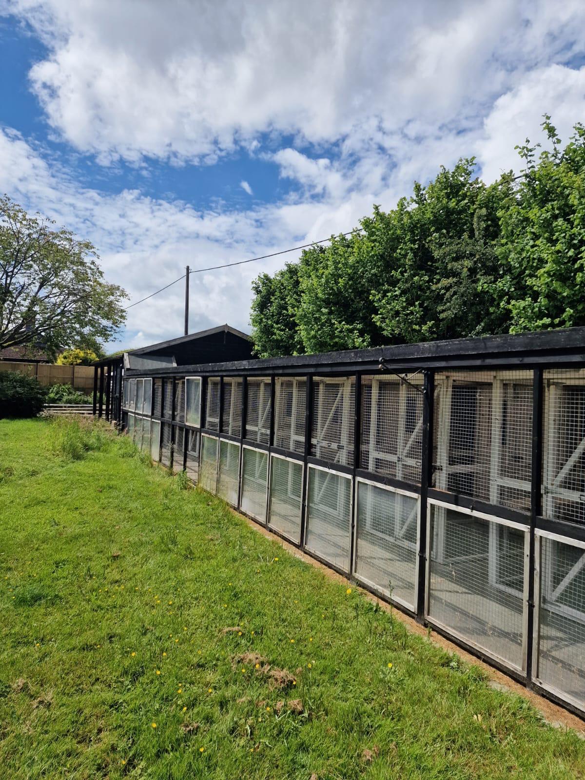

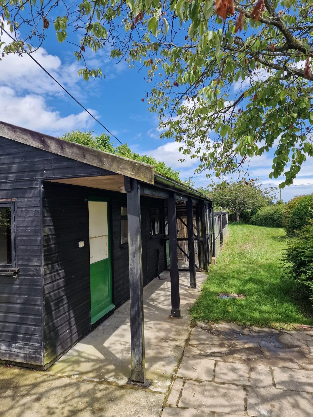

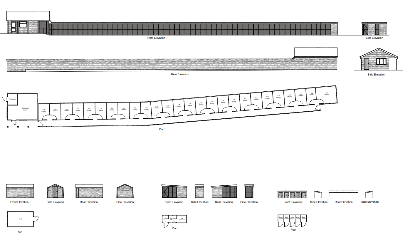

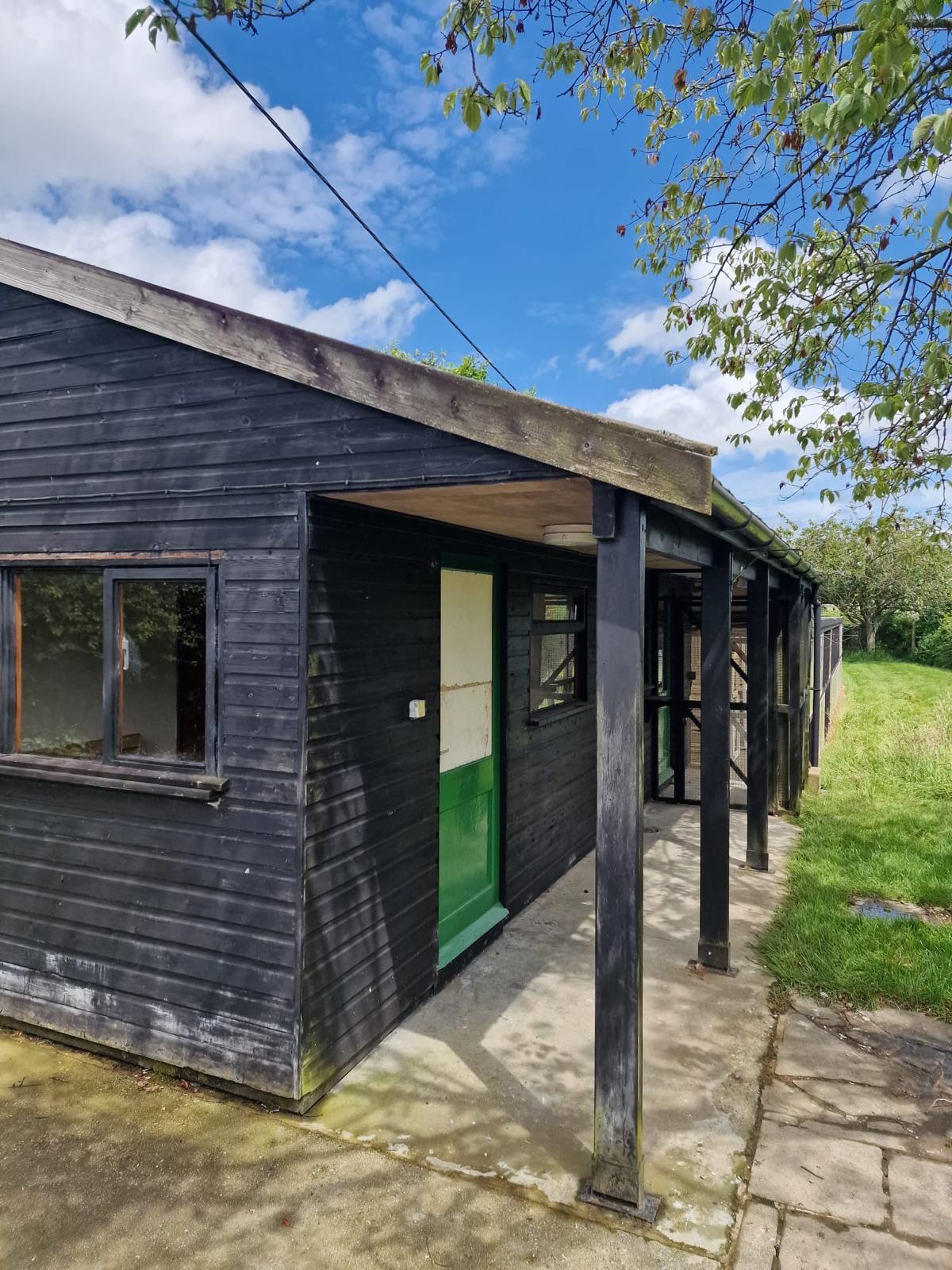

flanagaj Posted February 11 Share Posted February 11 About to offer on a plot that was a cattery business. Currently covers 220m2 of timber / construction. But I literally have zero idea what I am going to spend to have this demolished. I understand wood waste disposal has changed from Sept 2023 and as a result, not sure this can be disposed of in a conventional skip. Should I budget 10k - 20k for having this all removed? Link to comment Share on other sites More sharing options...
nod Posted February 11 Share Posted February 11 Depending on the condition You may get someone who will want part of it or all of it for free Advertise it online If your left with a concrete base Your digger will make fast work of it when you start your build and use it on site 1 Link to comment Share on other sites More sharing options...
flanagaj Posted February 11 Author Share Posted February 11 7 minutes ago, nod said: Depending on the condition You may get someone who will want part of it or all of it for free Advertise it online If your left with a concrete base Your digger will make fast work of it when you start your build and use it on site I did wonder whether that might be an option. Much better if it could be recycled and reused by somebody, rather than it just being destroyed. Link to comment Share on other sites More sharing options...
Gone West Posted February 12 Share Posted February 12 9 hours ago, flanagaj said: But I literally have zero idea what I am going to spend to have this demolished. We dismantled a timber frame bungalow and all the timber was taken via Freecycle and Freegle. 1 Link to comment Share on other sites More sharing options...
flanagaj Posted February 12 Author Share Posted February 12 3 minutes ago, Gone West said: We dismantled a timber frame bungalow and all the timber was taken via Freecycle and Freegle. Thanks. So my worry of 10 - 20k has been somewhat alleviated Link to comment Share on other sites More sharing options...

flanagaj Posted August 2 Author Share Posted August 2 Result!! We managed to sell the Cattery for 2.5k and I spent 5 days partly dismantling it, before the buyers dismantled the rest. They left it a bomb site and even changed the code on the combination lock so we couldn’t get onto our land! I then took three days off and fully cleared the site. So I’m well chuffed that what could have cost a large amount of money actually left us +£1200 in credit after I deduct two 10 yard skips and a 4 yard plasterboard skip. 4 Link to comment Share on other sites More sharing options...

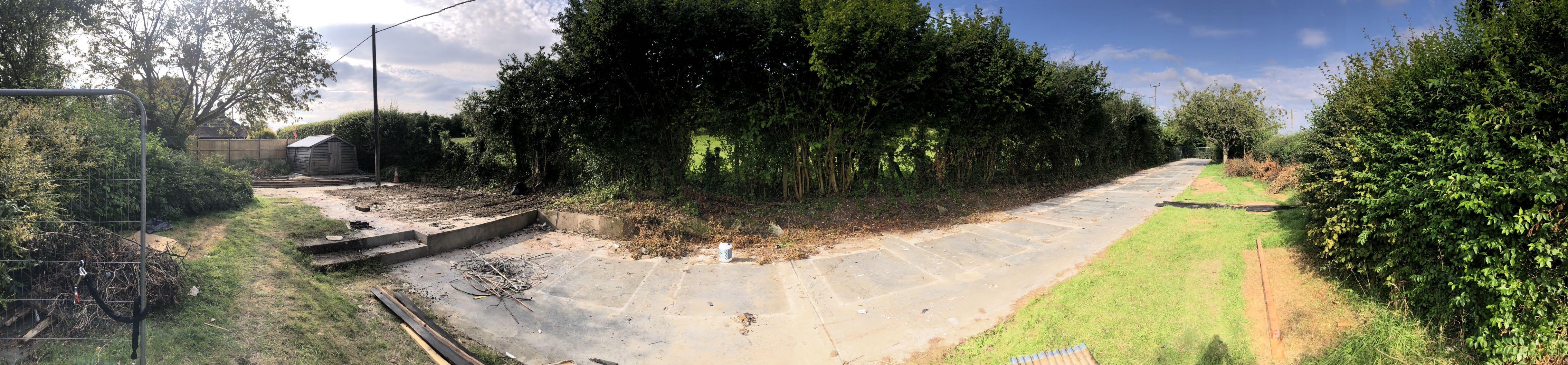

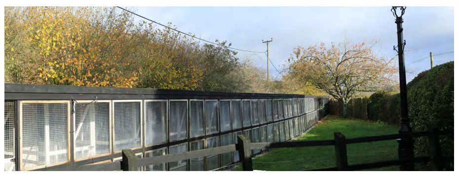

flanagaj Posted August 28 Author Share Posted August 28 Can anyone advise as to whether a 5 tonne excavator with a pecker will be notably quicker to break up the slab (100mm thick) than a 3 tonne one. I also have no idea as to whether it's a 1 day or 5 day job. There's in the region of 260m2 to break up and move to the site entrance for grab collection. If it's not reinforced, I am planning on hiring a crusher and to reuse it for the build. Link to comment Share on other sites More sharing options...
markc Posted August 28 Share Posted August 28 If you need to move the material any distance then you really need a dumper with the machine or a “JCB” (backhoe) to break it up then use the bucket to move it. difference between 3 and 5 tonner would be negligible, while you are paying the extra transport an 8t machine would be the better option. Unless the slab is thick or reinforced then you probably don’t need a pecker, especially with a JCB type machine as it will pull up the slab in chunks 1 Link to comment Share on other sites More sharing options...
ProDave Posted August 28 Share Posted August 28 If the site entrance is where the Heras fence is at the right of the last picture, then surely you would want a lot of it to remain as a site road? If not start breaking it furthest from the entrance and you have the "concrete road" there to push the first batch of rubble to the entrance with the diggers dozer blade. Then keep working your way to the entrance. Not the larger diggers might not have a dozer blade, something to check. I moved about 100 tons of soil around my site just pushing it with the dozer blade then digging it into a nice pile at the destination. 1 Link to comment Share on other sites More sharing options...
flanagaj Posted August 28 Author Share Posted August 28 Quote start breaking it furthest from the entrance and you have the "concrete road" there to push the first batch of rubble to the entrance Clever idea!! If in the event, it is reinforced and I cannot crush it for reuse, I can just pile it all up at the driveway end and the grab lorry can just reverse in and load it up. Link to comment Share on other sites More sharing options...

scottishjohn Posted August 28 Share Posted August 28 8 hours ago, flanagaj said: Can anyone advise as to whether a 5 tonne excavator with a pecker will be notably quicker to break up the slab (100mm thick) than a 3 tonne one. I also have no idea as to whether it's a 1 day or 5 day job. There's in the region of 260m2 to break up and move to the site entrance for grab collection. If it's not reinforced, I am planning on hiring a crusher and to reuse it for the build. If its 100mm thick then probaly no rebar so a 3tonner will murder it ,probaly with out a pecker start lifting it and see it break ,then do same to next bit ,prop one end of that bit onlast one and break into smaller lumps. how much of it is there .cos it you need hardcore then maybe rent a conrete crusher and make your own sub base or road stone --savess on skip and you something usable 1 Link to comment Share on other sites More sharing options...
