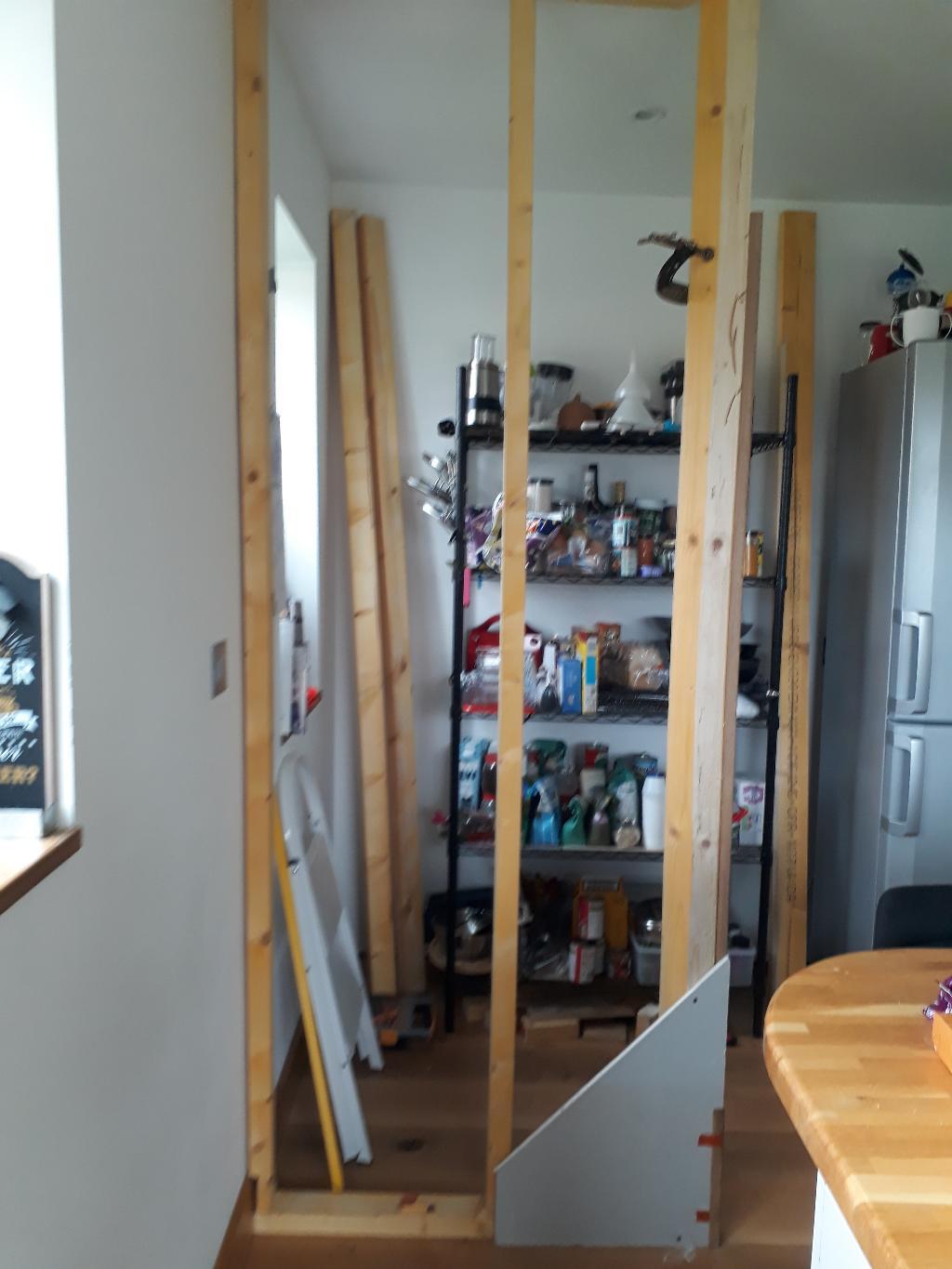

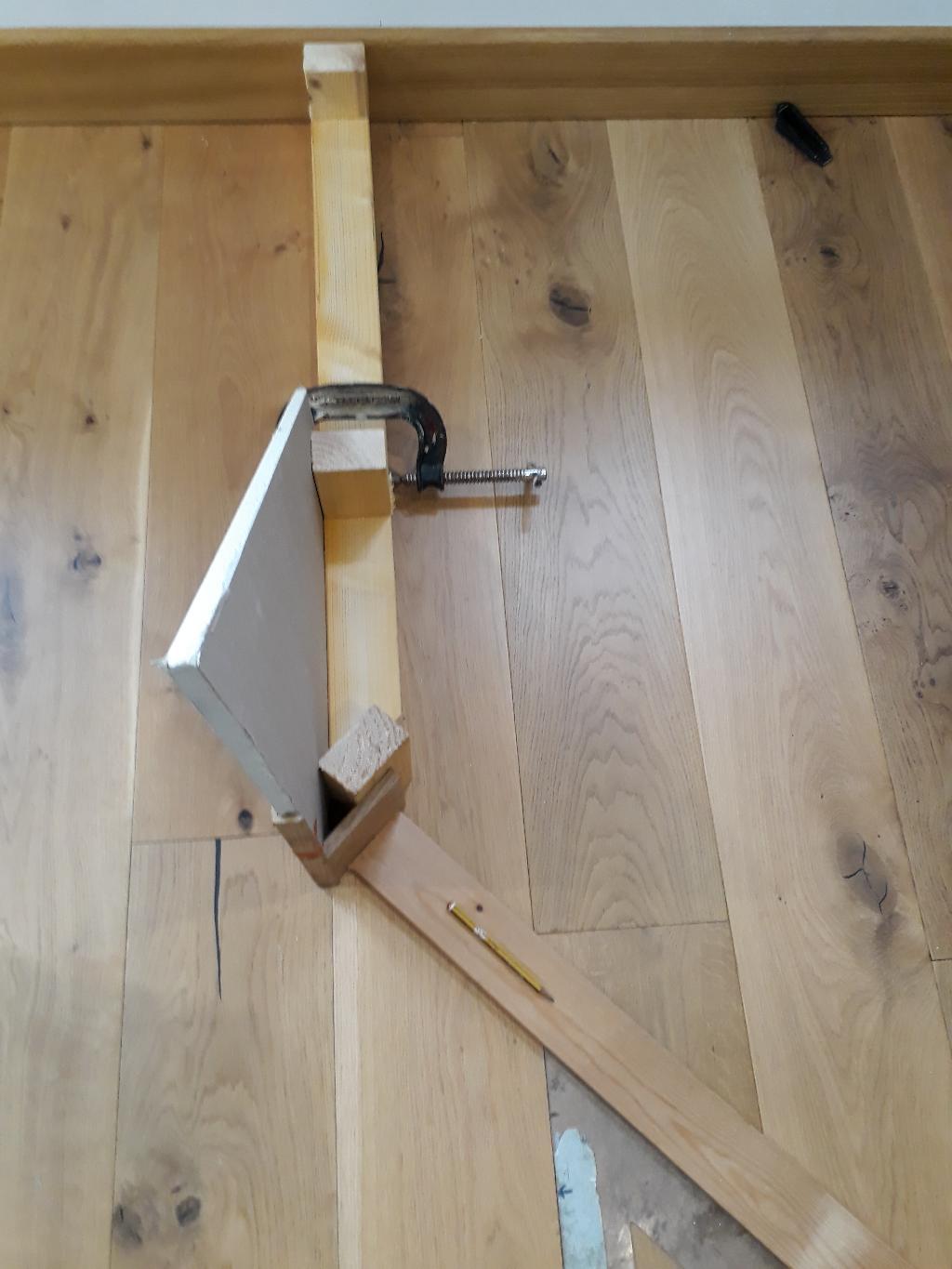

ProDave Posted September 25, 2023 Posted September 25, 2023 Slowly ticking off the bits to "finish" the house and the pantry has come to the top of the list. This is basically a small rectangle in the corner of the kitchen partitioned off to make a walk in cupboard with shelving. The corner of the rectangle will be cut off at 45 degrees and into that cut off corner will be a bi fold Oak door. I am knocking up ideas how to do this bit. Conventionally you would form the corner and then make the door opening in a short straight bit of wall. But that would widen the width of that 45 degree wall thus reducing the space inside the pantry. So i have come up with this mockup. to try and make the 45 degree cut off just the width of the door and it's liner. The bit of wood on the floor with the pencil on it represents the door. The last stud in the corner will be at 45 degrees. That will probably be made in practice with 4 * 2 with a corner planed or ripped off at 45 degrees. The door liner is made from 12mm thick planed oak, as most of my other door liners have been. And a bit of Oak corner bead in lieu of architrave. All the proper joiners will now be shaking their heads. Tell me why not, or how better to do it while taking up the minimum space?

joe90 Posted September 25, 2023 Posted September 25, 2023 Nothing wrong with you woodwork mate, yes get the door frame in and build the stud wall to it 👌👍, regarding the stone, nice to look at but little function in a warm room 🙈

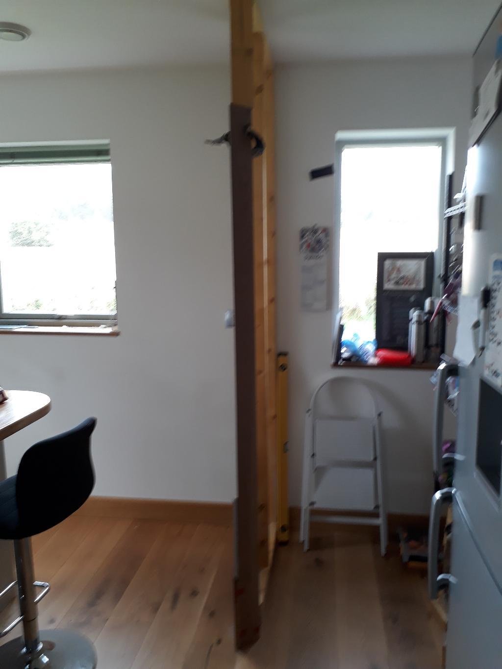

ProDave Posted October 3, 2023 Author Posted October 3, 2023 Slow progress. The first of the 2 stud walls built with my unusual angled corner posts. I can't make the door opening and therefore build the second wall until I know the size of the door. It is stated as 762mm wide, but one review says it is only 750mm wide. It does not actually matter which, but it is no good building a 762mm wide gap to then find the door is only 750mm wide. So the door arrived today. Well I now know the door is in fact about 752mm wide. The bad news is door No 1 arrived damaged. I have reported the damage to the supplier and door No 2 is now on it's way. More waiting around. Good job I am not in a hurry. 1

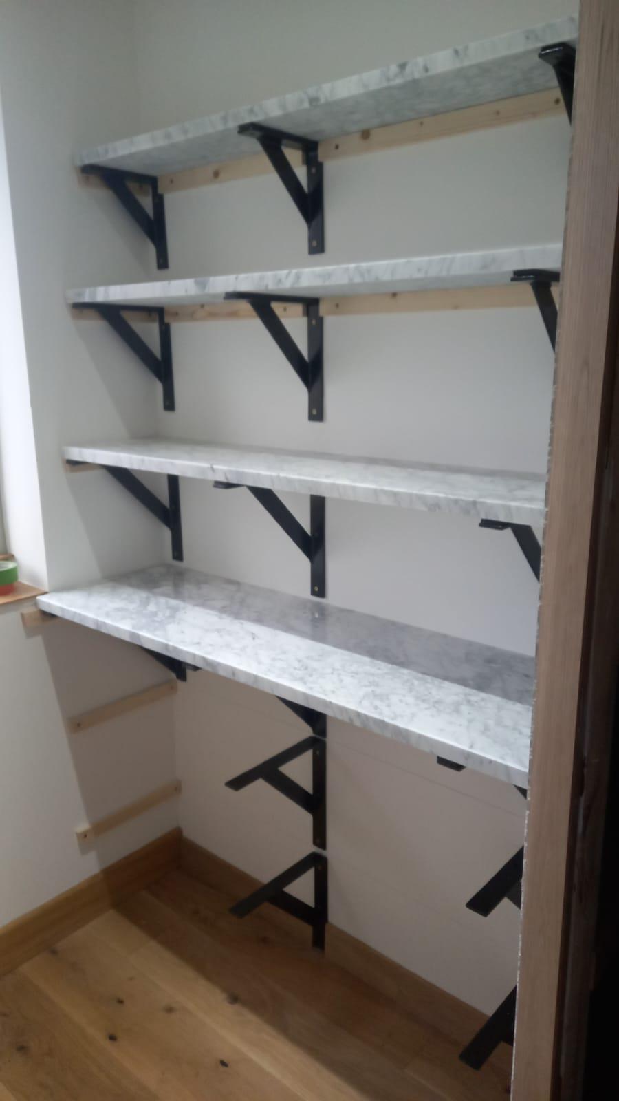

ProDave Posted November 22, 2023 Author Posted November 22, 2023 This is progressing reassuringly slowly. Mainly due to taking a long time to make up our minds just how to proceed. But today was a milestone, we collected the stone shelves and lifted them straight into place. Unfortunately the bottom one was supplied wrong, it should be a little deeper. They are re making that one. The bottom 2 shelves will be painted wood. Until the correct bottom shelf is fitted I can't put the door on or else it would be in the way. Now we have another design problem. The wall opposite the main shelf wall, we want some shallow shelves, big enough for tins and jars, so shelves big enough for a standard baked bean tin, with a lip to stop them getting knocked off. Preferably something ready made as a shelf unit. But i can't find anything. Looking for something like this which you can buy from some kitchen suppliers as a shelf unit fitted to the back of a kitchen cabinet door But I can only find those as an option to buy with a kitchen unit. I just want something similar to screw to a plain flat wall. any ideas? 1
Onoff Posted November 22, 2023 Posted November 22, 2023 (edited) I'm amazed you're not making them yourself! Something like this? They make to order: https://www.silverapplewood.co.uk/products/solid-pine-spice-rack-5-tiers-shelves Edited November 22, 2023 by Onoff
markharro Posted November 22, 2023 Posted November 22, 2023 1 hour ago, ProDave said: we collected the stone shelves and lifted them straight into place. That stone looks nice - and expensive or did you manage to get a deal! We have a very similar space to outfit so interested in your ideas. Where did you source the brackets?
ProDave Posted November 22, 2023 Author Posted November 22, 2023 The stone wasn't cheap, too big to be a cheap offcut deal. but SWMBO wanted stone so she got stone. the compromise is the two bottom shelves being wood. Wanted good solid brackets that can take the weight without bending and bought these ones https://www.etsy.com/uk/listing/644302988/heavy-duty-shelf-bracket-industrial?ga_order=most_relevant&ga_search_type=all&ga_view_type=gallery&ga_search_query=metal+shelf+brackets&ref=sr_gallery-1-13&frs=1&organic_search_click=1 They come as plain bare steel and had 2 coats of black hammerite. With this being a small room with a big cost, it is definitely the most expensive bit of the house in £ per square metre.
