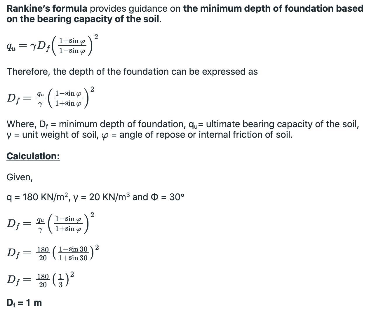

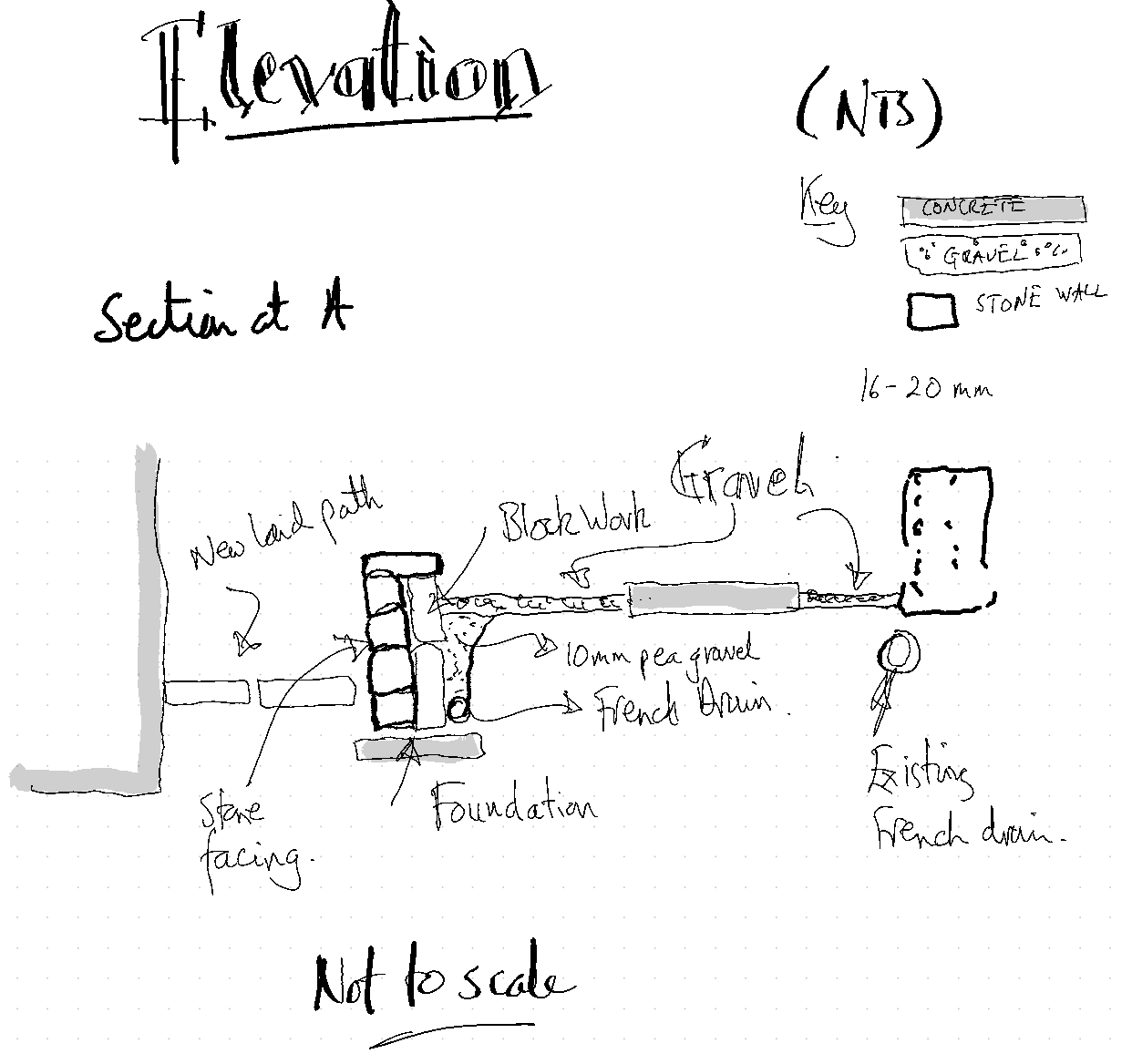

ToughButterCup Posted September 13, 2023 Share Posted September 13, 2023 I need to prepare our carpark: one edge of it has a low wall which supports part of the parking area. The stone (local stone) wall forms the border to a footpath. I would like to calculate the minimum depth of the foundation. I need to take the wall down, dig out the back of the wall to make space for the foundation [ and the shingle drainage and french drain] , then put a block wall up, and face that block wall with the stone I took down. The wall height varies between 450mm and 700mm. The ground is medium clay, and it's fairly damp most of the year. (I think its glacial till ) Wet Clay repose is (say) 20 degrees or so. This is the first site I googled that gives me a formula to calculate the minimum depth of the foundation The formula is given as where p = the soil bearing capacity w = density of the soil and the angle of repose is that funny phi (or is it summat else ?) looking thing That means p = 250 kN per square meter w = 1760 kg per cubic meter Angle of repose is 20 ish 1 - sine 20 is 1 - .342 = 0.658 1 + sine 20 = 1.342 Minimum depth is ( 250 / 1760 ) * ( 0.658 / 1.342) = 0 .1420 * 0.490 = 0.6958 Here's where I'm stumped ---- is that 0.6958 mm or is it 69.58mm or is it something else ? Thats the trouble with google: a little knowledge = danger. hence this post I 'feel' the foundation needs to be 100mm of C25. But it would be good to know why I'm wrong - or, more rarely, right. Link to comment Share on other sites More sharing options...
Bonner Posted September 13, 2023 Share Posted September 13, 2023 Can’t comment on the validity of this formula however the result should be 0.06958 and the unit is metre, therefore 69.58mm so you were right! 1 Link to comment Share on other sites More sharing options...
ToughButterCup Posted September 13, 2023 Author Share Posted September 13, 2023 Cheers @Bonner..... Link to comment Share on other sites More sharing options...
markc Posted September 13, 2023 Share Posted September 13, 2023 I don’t have anything to do with groundwork’s or geotechnical but Just looking at this and my first thought is that the calculation would be for the minimum depth below the lowest point to prevent a slide or shear down the slope. that aside, min foundation depth is generally to get below a level that will be affected by movement from shrink, heave or frost etc. 1 Link to comment Share on other sites More sharing options...
SteamyTea Posted September 13, 2023 Share Posted September 13, 2023 By the looks of it you started in mm, rather than converting to m. So the answer will be in mm. And it is Phi. 1 Link to comment Share on other sites More sharing options...

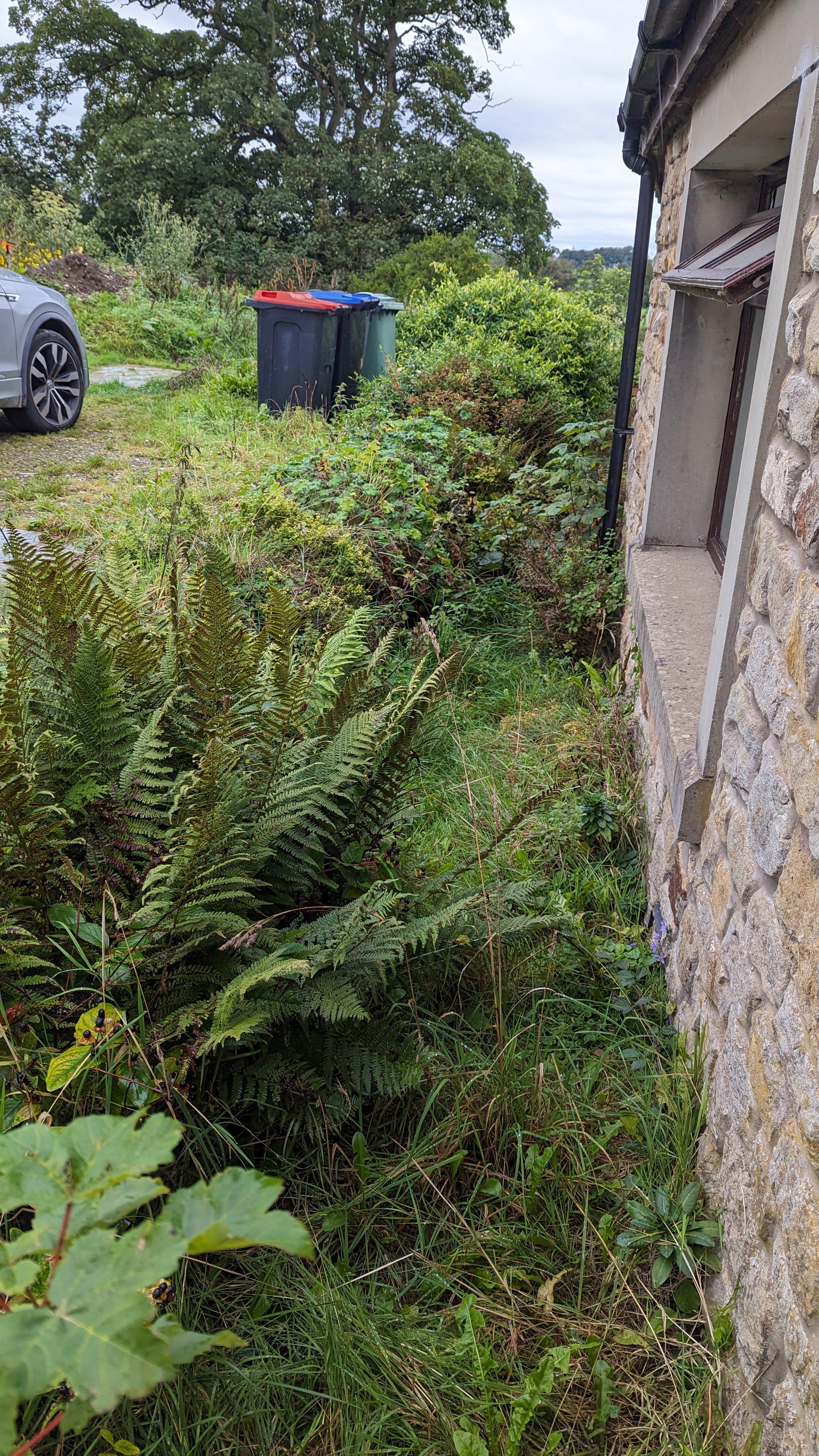

Russell griffiths Posted September 13, 2023 Share Posted September 13, 2023 Show us a picture buttercup. Link to comment Share on other sites More sharing options...
ToughButterCup Posted September 13, 2023 Author Share Posted September 13, 2023 .... of the intended design..... and the reality of what's there now .... erm, needs a bit of strimming maybe 🫣 Link to comment Share on other sites More sharing options...
LnP Posted September 13, 2023 Share Posted September 13, 2023 9 hours ago, ToughButterCup said: I need to prepare our carpark: one edge of it has a low wall which supports part of the parking area. The stone (local stone) wall forms the border to a footpath. I would like to calculate the minimum depth of the foundation. I need to take the wall down, dig out the back of the wall to make space for the foundation [ and the shingle drainage and french drain] , then put a block wall up, and face that block wall with the stone I took down. The wall height varies between 450mm and 700mm. The ground is medium clay, and it's fairly damp most of the year. (I think its glacial till ) Wet Clay repose is (say) 20 degrees or so. This is the first site I googled that gives me a formula to calculate the minimum depth of the foundation The formula is given as where p = the soil bearing capacity w = density of the soil and the angle of repose is that funny phi (or is it summat else ?) looking thing That means p = 250 kN per square meter w = 1760 kg per cubic meter Angle of repose is 20 ish 1 - sine 20 is 1 - .342 = 0.658 1 + sine 20 = 1.342 Minimum depth is ( 250 / 1760 ) * ( 0.658 / 1.342) = 0 .1420 * 0.490 = 0.6958 Here's where I'm stumped ---- is that 0.6958 mm or is it 69.58mm or is it something else ? Thats the trouble with google: a little knowledge = danger. hence this post I 'feel' the foundation needs to be 100mm of C25. But it would be good to know why I'm wrong - or, more rarely, right. I don't know anything about foundations, but I was curious ... as I recall, one way to answer this question is to do dimensional analysis on the equation. Working through the dimensions on the RHS should give a dimension of L (depth of the foundation), but it doesn't so I'm wondering if there's something wrong with the equation .. here is the dimensional analysis: p has dimensions force per unit area, and force=mass*acceleration, so p has dimensions M LT-2L-2 w is density which has dimensions ML-3 The expression in the bracket is dimensionless. So the RHS has dimensions (M LT-2L-2)/(ML-3). If you cancel that through, you end up with dimensions for the RHS of L2T-2, but it should have dimensions just L for the depth. So we need to get LT-2 out of the RHS. LT-2 are the dimensions of acceleration, so the dimensions would come out right if p was in kg/m2 rather than N/m2. So I would say that if you put in a number for p in kg/m2, your answer will be in m. Willing to have my maths homework corrected if I got this wrong 🙂 1 Link to comment Share on other sites More sharing options...
saveasteading Posted September 13, 2023 Share Posted September 13, 2023 11 hours ago, ToughButterCup said: is that 0.6958 mm or is it 69.58mm or is it something else If anyone remembers slide rules: digits were shown as an answer, but we had to know ourselves where the decimal point went. In a complex sum, it required a bit of working out. But with this sort of calculation, it is common sense. What sort of number do I expect to see? 7mm or 70mm or 700mm or 7m? The answer here is fairly obvious and it usually is. Assuming the calcs are right and the fundamental principle is valid.* For example, I offer each school client a practical maths class. the first challenge is how much concrete do i need to order for he floor slab. H x L x th. decimal places are always the biggest challenge. So I help by asking how many concrete lorries feels right? for example is it 3 or 30 or 300? some kids immediately feel what is right, but others don't. It's the way our brains are wired i guess. Now, from a quick look at your link... *Rankine's formula doesn't, as I recall, apply to foundation depths. But he did a lot of stuff so..@Gus Potterhelp please. There is no such thing as The Institute for Civil Engineers, not in UK and Commonwealth anyway, It is the Institution of Civil Engineers, and these are not they. Who knows who wrote this googled page? So to your wall. I wouldn't calculate this, as its not exactly a motorway where disaster could result. 700mm seems very deep to me. 450? /500? just do what feels right. If it fails it will be by falling over, not settling. 1 Link to comment Share on other sites More sharing options...
LnP Posted September 13, 2023 Share Posted September 13, 2023 This website gives a different version of the equation, which does check out OK by dimensional analysis, so perhaps your equation is wrong. Caveat again, I know nothing about foundations! Link to comment Share on other sites More sharing options...
ToughButterCup Posted September 14, 2023 Author Share Posted September 14, 2023 A depth of 1 m of C25 concrete -- wow! Thats a lot, @LnP Debbie suggests we use RAAC. Ever the bright spark...... I suppose I could get my Paddle Mixer out and whisk it up into a bit of a froth. Its the autoclave I'm struggling with I'm with you @saveasteading - it'll fall over rather than sink..... Does that imply that the foundation design should anticipate that force - maybe tilt it a bit to the right (away from the path in the image above). The deepest the wall gets is 700mm or so - not much. Just waiting for @Russell griffiths to say that I'm overthinking it (again) Link to comment Share on other sites More sharing options...

Conor Posted September 14, 2023 Share Posted September 14, 2023 As a general rule, if a wall is, or is in part, retaining, then the width of the footing should should be equal to the height of the retaining portion of the wall. In your case, about 600-700mm? In these cases the footing acts more like a beam, so depth is less important as the load is spread out over the soil, rather than down through it. I'd dig down deep enough to firm ground, the full width of the path, and pour 25nm concrete to the depth that allow you to pave directly on top with about 30mm mortar. You'd want a wee bit of steel in there as well. Even just dowels for the first course. Our retaining wall founds are only 250mm thick and about the same under the surface. But they are 1200-1700mm wide with a fair bit of steel. In fact, one is at FGL and forms the base of a "shed". This wall is 100mm RC tied in to the slab, bricks and block used as shuttering. 1 Link to comment Share on other sites More sharing options...
ToughButterCup Posted September 14, 2023 Author Share Posted September 14, 2023 22 minutes ago, kandgmitchell said: .... What's the difference in height between levels? 450mm at one end and 700 ish at the other 1 hour ago, ProDave said: .... Just dig until you hit hard undisturbed ground,.... Bit this is not any old wall, it is a retaining wall, if I am reading it right to keep your driveway from sliding down into the [ footpath in the image above ]? If so I have not seen discussion of the height of what it has to retain and the forces trying to overturn the retaining wall. I know from our piling trial pits (one was right next to this wall) that we have glacial till under about 700mm of MOT1 (put there during the build ) Height : 450 to 700mm ish and the forces are the weight of the MOT1 and gravel next to the wall and any cars parked close to the wall.... I assume that a car parked one car-width away from the wall will have no real effect on the wall. At best, only two cars will be able to park right next to the wall: and by right next to the wall I mean one car-door width plus a bit next to the wall. Link to comment Share on other sites More sharing options...

kandgmitchell Posted September 14, 2023 Share Posted September 14, 2023 Well, when there's a vertical load the rule of thumb difference in height allowable is 4 x thickness of wall - 750mm would suggest 187.5mm. However, this is a pure retianing wall with no vertical load, only a horizontal one, however unless a really heavy truck was to be parked alongside the wall I would have thought a total of 100mm block plus 150mm stone = 250mm would do. If you wanted more certainty without involving a structural engineer then how about a strip of horizontal mesh in the foundation with vertical bars at intervals. Make the vertical rods L shaped and wire the "foot" to the mesh. When set, use 225mm hollow concrete blocks with the vertical rods threaded up the voids and backfill the voids with concrete. Face with stone. I can't see that being pushed over easily. 1 Link to comment Share on other sites More sharing options...

ToughButterCup Posted September 14, 2023 Author Share Posted September 14, 2023 1 hour ago, kandgmitchell said: ... If you wanted more certainty without involving a structural engineer then how about a strip of horizontal mesh in the foundation with vertical bars at intervals. Make the vertical rods L shaped and wire the "foot" to the mesh. When set, use 225mm hollow concrete blocks with the vertical rods threaded up the voids and backfill the voids with concrete. Face with stone. I can't see that being pushed over easily. Top idea. Thanks. Cheque's in the post. Link to comment Share on other sites More sharing options...
