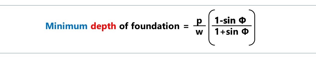

I need to prepare our carpark: one edge of it has a low wall which supports part of the parking area. The stone (local stone) wall forms the border to a footpath.
I would like to calculate the minimum depth of the foundation.
I need  to take the wall down, dig out the back of the wall to make space for the foundation [ and the shingle drainage and french drain] , then put a block wall up, and face that block wall with the stone I took down.
The wall height varies between 450mm and 700mm. The ground is medium clay, and it's fairly damp most of the year. (I think its glacial till ) Wet Clay repose is (say) 20 degrees or so.
This is the first site I googled that gives me a formula to calculate the minimum depth of the foundation
The formula is given as
where p = the soil bearing capacity
w = density of the soil
and the angle of repose is that funny phi (or is it summat else ?) looking thing
That means
p = 250 kN per square meter
w = 1760 kg per cubic meter
Angle of repose is 20 ish
1 - sine 20 is 1 - .342   =  0.658
1 + sine 20                    = 1.342
Minimum depth is ( 250 / 1760 )  *  ( 0.658 / 1.342)
= 0 .1420 *  0.490
= 0.6958
Here's where I'm stumped ---- is that 0.6958 mm or is it 69.58mm or is it something else ?
Thats the trouble with google: a little knowledge = danger. hence this post
I 'feel' the foundation needs to be 100mm of C25. But it would be good to know why I'm wrong - or, more rarely, right.
That formula is for non-cohesive soils so isn't applicable here anyway.
A formation level a minimum of 450mm below finished ground level is good for most of the UK. For capacity, in the absence of ground information, go 150mm into good virgin ground. For mass concrete, foundation thickness a minimum of half the width (although depends a bit on the wall - part A rules should be ok for a small retaining wall). For retaining wall, top of concrete ideally 200mm below low side ground level.
