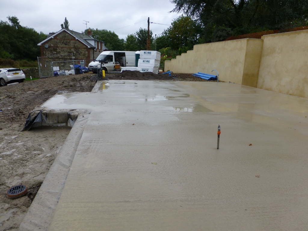

Jeremy Harris Posted September 18, 2017 Posted September 18, 2017 On 18/09/2017 at 09:37, Silage said: Just planning out service runs for DHW/CW to the kitchen island. What is required to run under or through an MBC slab that has mesh/ufh? I also need to to get the UFC into the plant room that is outside iof the the foundation footprint. Expand I only needed to get a length of 6mm² T&E to the island, plus a run of 2.5mm² T&E for a single socket, so I bent a length of 25mm plastic conduit and cable tied it to the reinforcing fabric, before the pour. Here are some photos, the yellow paint marks where kitchen units and the island will go and you can just make out the black conduit that comes up under the island right at the back of this photo (with a bit of red tape around the top): This photo was after the pour, but before the slab was power floated, and you can see the bit of conduit sticking up where the island will go:
