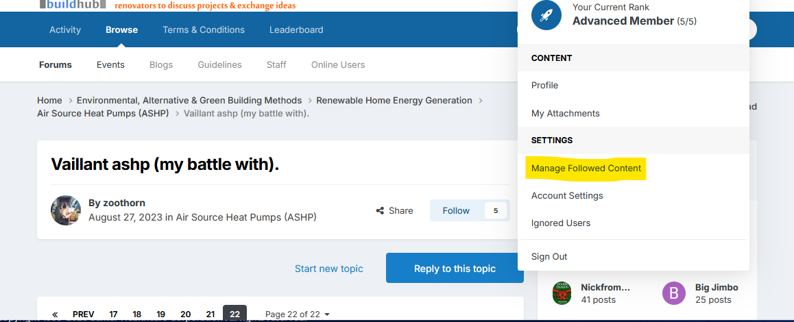

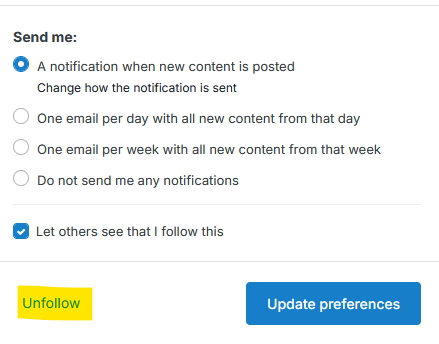

@saveasteading @Nickfromwales@SimonD
Alternatively go to your profile
Manage followed content
Find the "Unfollow" this thread and update preferences

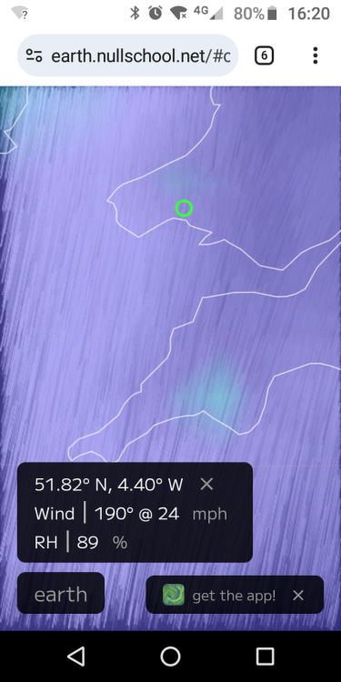

Secondly. I remember a situation which is the BEST example of this OTT wet climate atmosphere thing, which you all ridicule & so certain simply cannot be true..
One job my builder did (along with the 2021 extention, thankfully well-built) was put in a new back door & frame. Bought from Howdens in town, with a basic hardwood frame. Now, my builder was reknown as the best around, most experienced. My extension proof enough.
Door opened outwards (giving me more room in my back hall), & all fine. Swung open great. Nice solid heavy feel, quality hinges & handle. I painted 3x with Sadolin stuff he recommended. 4x coats on the top edge, & bottom edge.
1 month later the door was sticking, a week on, it was jammed shut. He trimmed a bit off edge, I repainted, rehung. I saw a good gap now. 6mm min. 6 weeks later, door was jammed solid again. Builder called, now a bit 'welsh angry' forced it open. Jigged it. Door was ok. 2 months on, again, it had jammed solid. Builder refunded me for the whole door job! Very decent of him, as it wasn't his fault. I took it off, trimmed another 5mm, rehung it, now at max possible trimming area. I noticed it had also got a slight bow in it too. It opened ok.
2 weeks ago, first open since winter proper, jammed solid again. It hasn't jammed solid, each time, due to any dampmess within the cottage/ in the immediate area: IE the door back entrance area to my (cold yes, but perfectly dry) 80's exention. I have never had any damp issues in the extension. Not the kitchen, bathroom, the small hall, nor any evident in the loft area above. It is quite simply, a dry extension.
Now. The cause of the door doing this. You will list a,b,c as possible/ probable causes. But you'd do so as excuses, rather than accept the blindingly obvious: the local particularly & unusually damp atmospheric conditions, seeped into the fabric of the door, swelling it. A ludicrous ammount. Not only width, but warped it. As a consequence, it's NOW useless/ junk/ needs replacing again. It was a decent-quality door when new, but within a very short timeframe has --become-- junk. Because it has changed, structurally. It has been ruined. No iffs, no buts. That is an absolute fact.
This was HOWDENS. And treated especially well, especially carefully by me 1) because it it was my door, & B) because I was aware of the damp (local area air) facet. I knew it existed. I did my utmost to keep it at bay, keep itmout of the structure of this door, but even this was a fruitless exercise. THAT is how pervasive, it is. How ruinous. How it leeches into every aspect of your life here. Without respite almost 365 days a year you feel it.
This is absolute proof of it. This & the always-wet feeling limp post, I collect each day, from outside my front door/ that I collect from outside my dwelling........ are categorical proof.
Whatever you guys say. You guys, some migjt be builders, most let's say very experienced amateurs/ &/or semi-pro standard. Without any question far above my level of knowledge. But look, so was my builder, when he said "oh no, I wouldn't want to do that/ no sorry I'm not happy with that idea" & refused the job of pouring 2 large concrete foundation 'pads' for my log cabin's base. I got a local guy to do the job. And with help from BH, the job was done, cabin is a success.
So, the builder 65 yrs old, hugely experienced & known as the best around (& with it a premium in his quotes), who knows the area like back of his hand, whose ancestors lived in my very cottage 1855 or so... he was wrong. And you guys (not up to his standard)... were correct.
And so by the same token, I am correct with regards to this strange & indescribable local wet air facet, & you naysayers who say it doesn't exist.... you all of you who club together singing from the same denial-hymnsheet on it.. are purely & simply wrong.
