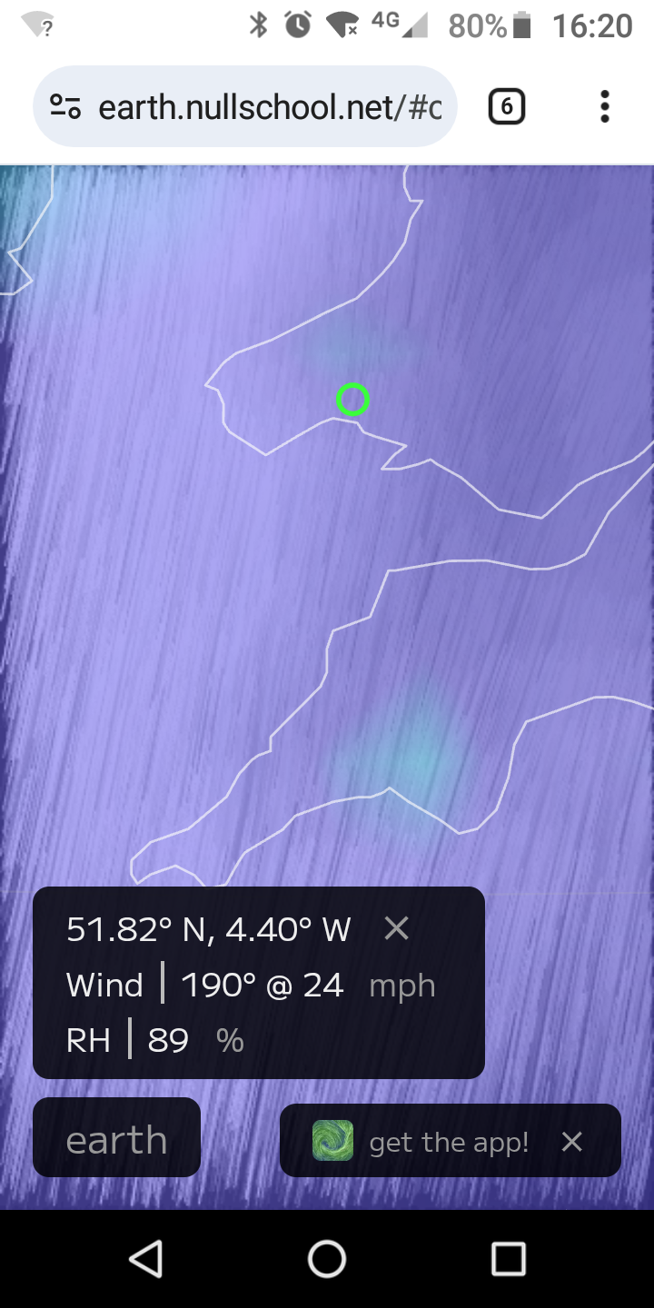

10 minutes ago, zoothorn said:
Why I include this phenomenon, aspect, whatever the hell it is, is because I know there is a causal LINK between IT & the near impossibility of heating stone cottages, in this locale.
This is bollocks.
Here are some cold hard numbers.
Maximum possible humidity is 100%.
Assume your outside air is saturated (100% humidity). Assume its 10C outside.
If you heat your indoor space to 20C the air, holding exactly the same amount of moisture will be at 50% humidity, which is perfectly fine for an indoor climate.
No dehumidifiers needed, just heating the house to 20C vs the outside air of 10C. If the outside air is 0C then you only need to heat to 10C to get the humidity down to 50%.
This all assumes you aren't introducing more humidity into the air (which of course we all do as living beings) but the point stands. To solve humidity issues in a house, warm it up.
3 minutes ago, -rick- said:
This is bollocks.
Yep. We had rain for nearly month, mostly at or near 100% humidity, (in fact the year we have high humidity outside) house stays at 40% humidity, not by magic, because its heated.

This is the highest RH I could find in South Welshland.
89% @ 9.8°C.
So 6.9g of water to every 1 kg of air.
A large mug of tea holds 300g of water. That is 43 times more water.
