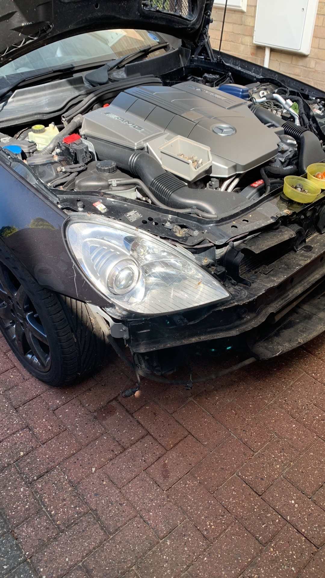

I was fixing headlights so bumper had to come off ;)
Edited by marshian
Explaination of why it's in bits
We digress, but that's my next job as the loom in the headlight of the GLS has dropped a core, canbus going nuts every now and then. ffs.
