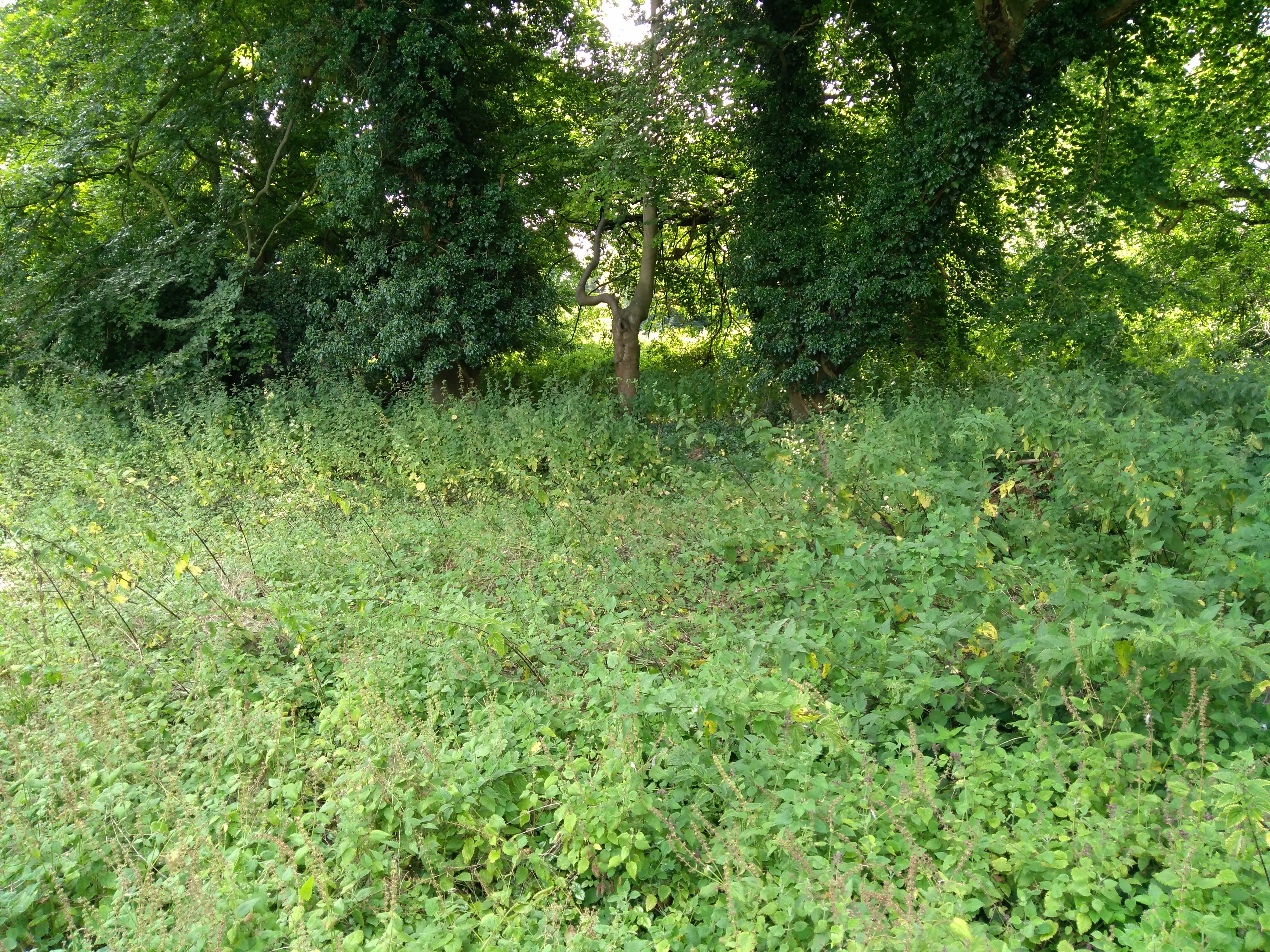

ToughButterCup Posted August 30, 2017 Posted August 30, 2017 A few photos would help, or a Google Maps reference....

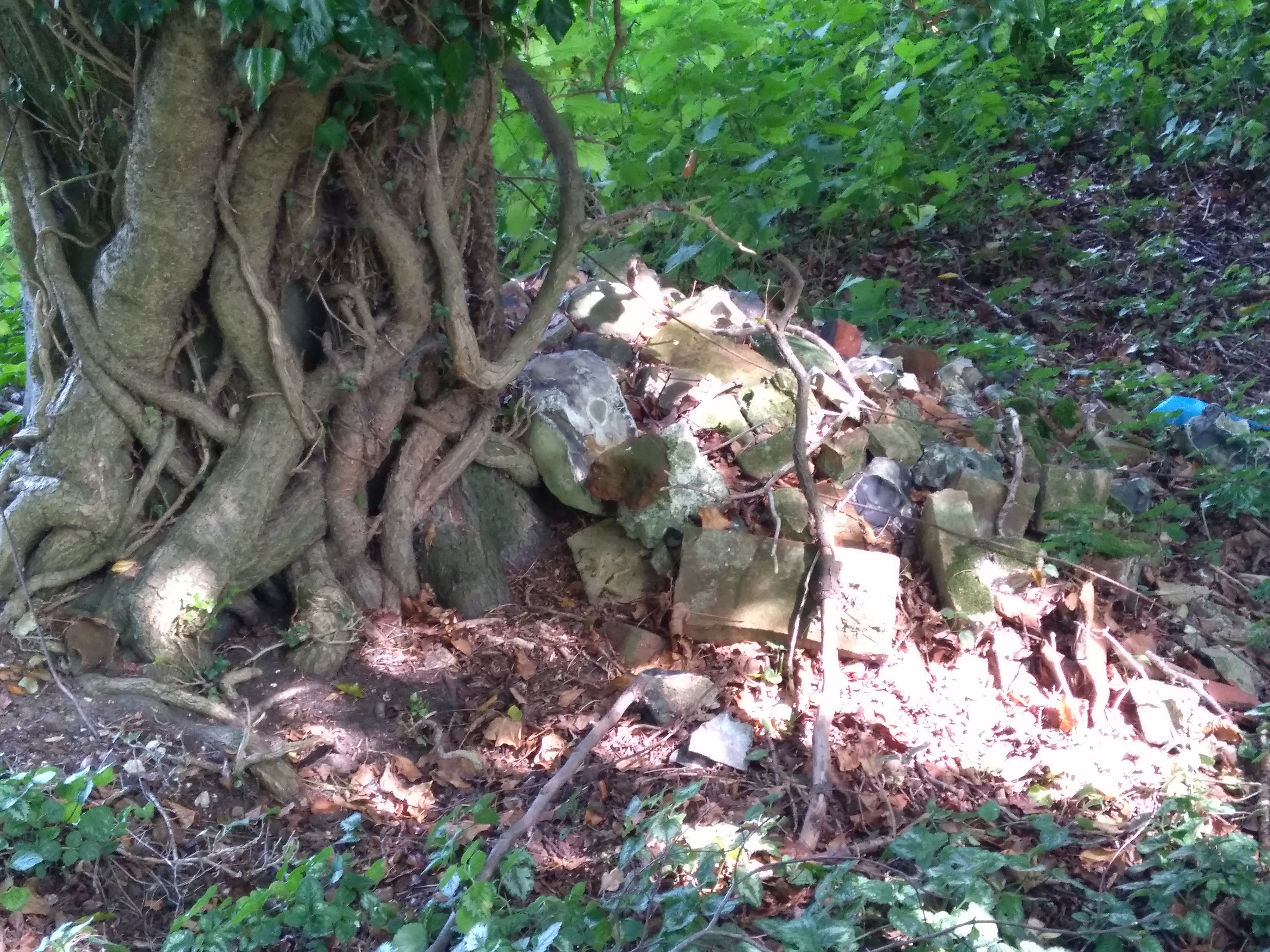

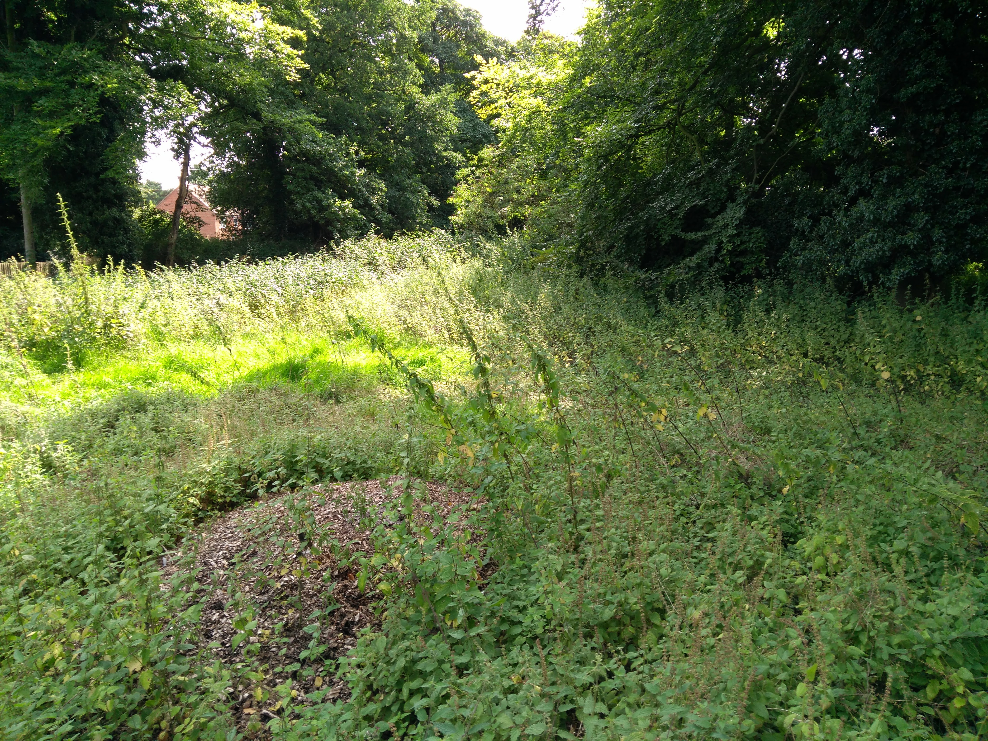

v4169sgr Posted August 30, 2017 Author Posted August 30, 2017 (edited) On 30/08/2017 at 06:01, recoveringacademic said: A few photos would help, or a Google Maps reference.... Indeed. Just getting the hang of Google Photos ... View over the center of the site, looking south: And to the western edge Derelict shed: Small spoil heap Site from the road. Parts of the two TPO beeches are shown to the edges of this photo Edited September 1, 2017 by v4169sgr getting the hang of the forums lol
