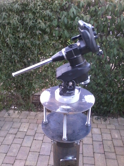

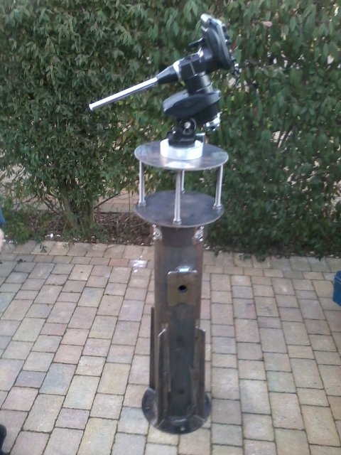

Dark skies? Here's one I made earlier...and FINISHED! :)
I'd post more pics but they were on Photofucket before it got all restrictive to 3rd party links.

@Onoff Yes, I did say "dark skies" :P Thanks for the photos: nice plinth! How do you drive your mount? Where's the OTA? :) And is that a thermal gap you've got there, or am I seeing things ?

I'm NOT the astronomer. That's my big brother...the barrister...the one who could jump on a plane to watch the elipse in the States.
I'm the younger, thicker, less successful one, generally not referred to by name by our parents rather as "...the one who likes wood, metal and playing with wires!"
OTA's a Celestron something. It's got motor(s) in it is all I know. Will try and find a pic. Thermal gap, wtf? You'll do well on here talking like that! :) The plinth is one I copied from photos of an Altair one. I just scaled the photos in CAD and started cutting metal. Sits on a 1200mm cube of mass concrete with a duct for the electrics coming up through into the plinth.
