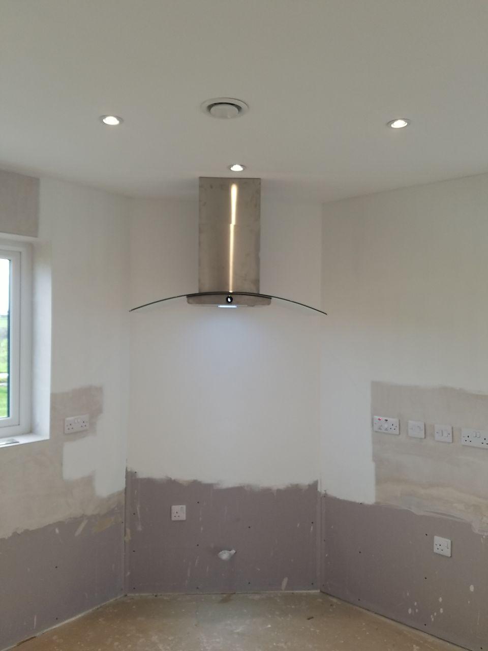

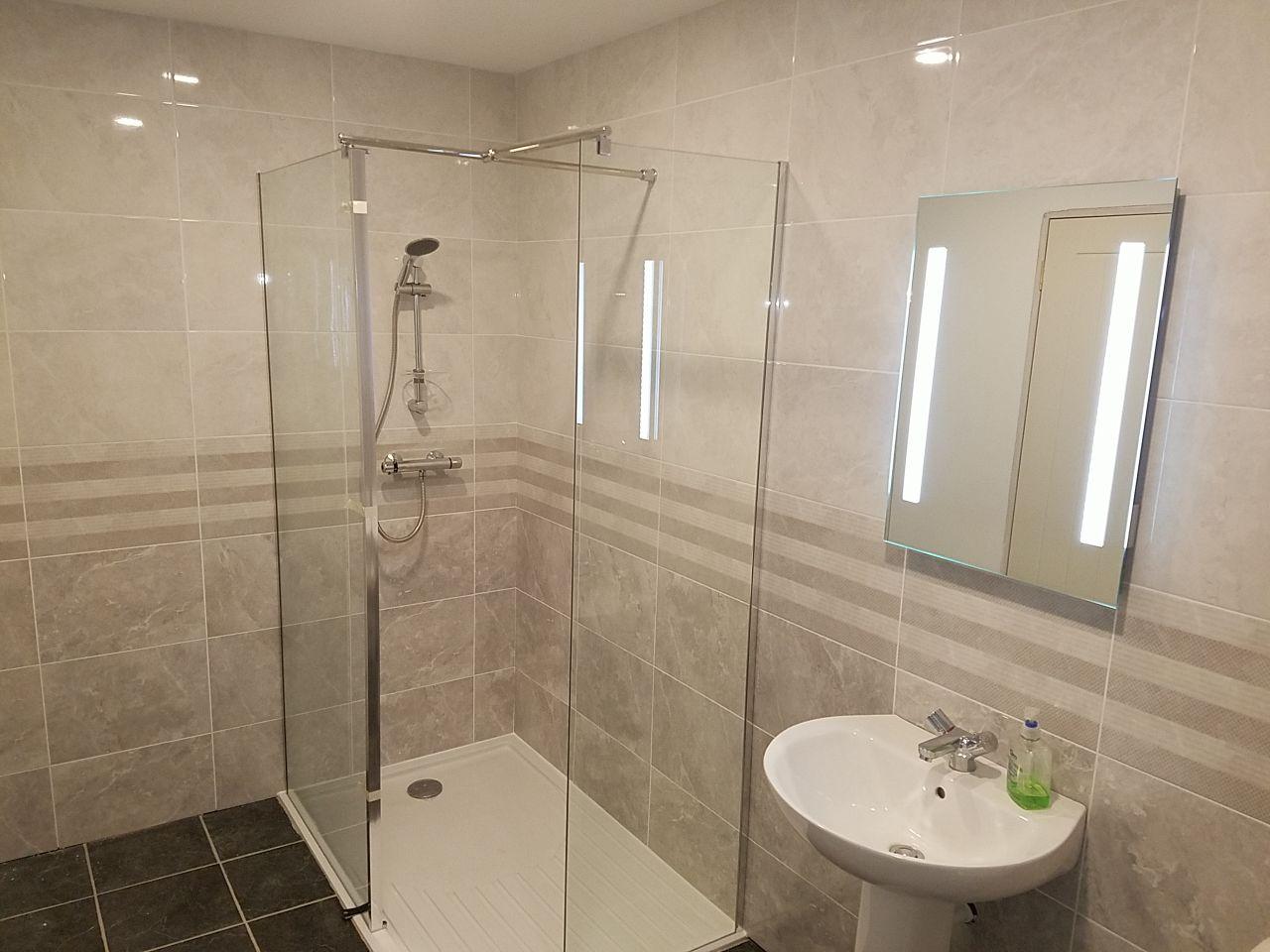

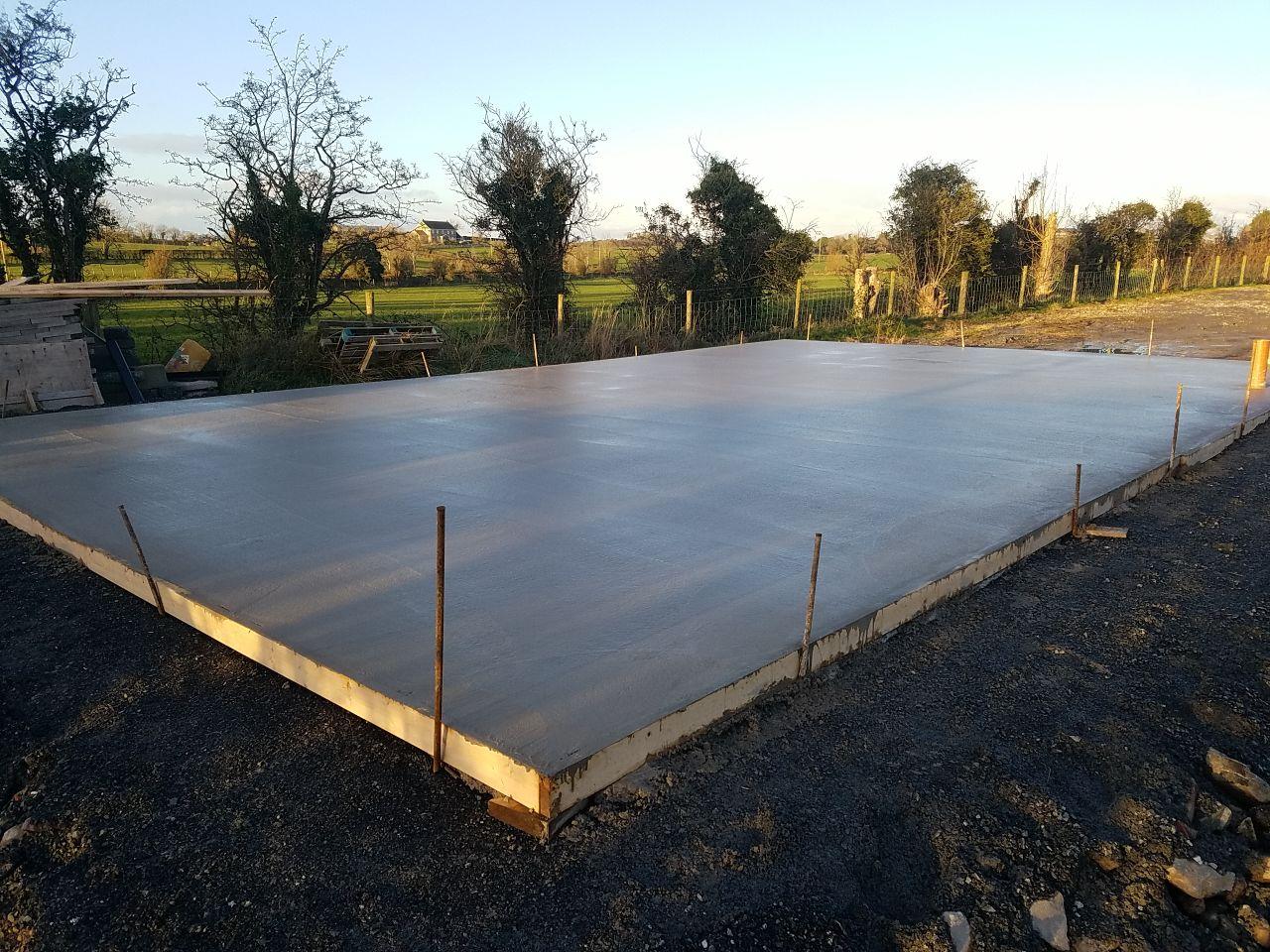

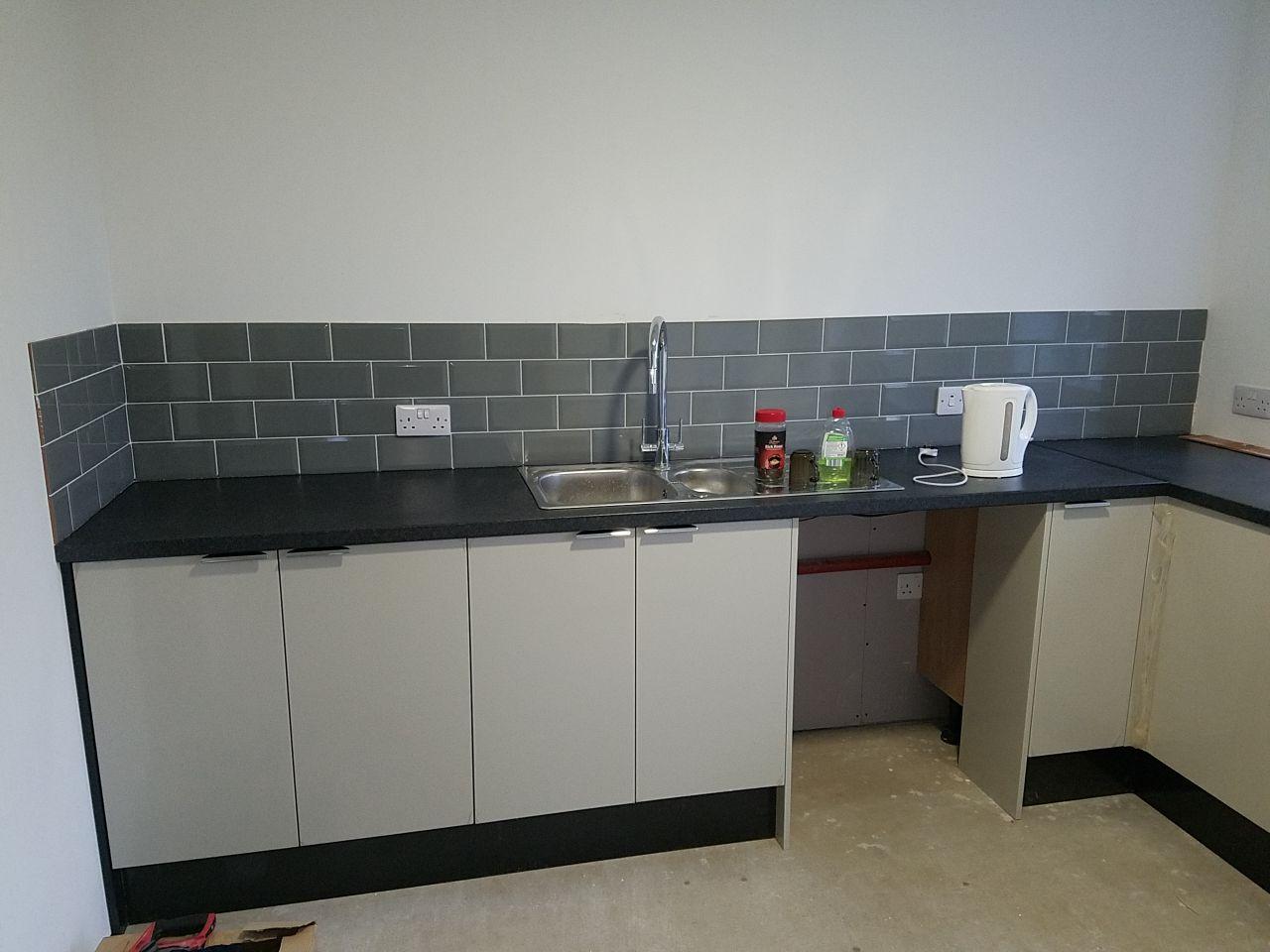

dpmiller Posted December 11, 2021 Author Share Posted December 11, 2021 Has all this time passed since I updated last? Wow. The plasterers were back, and we have now only the two small bedrooms and the entrance hallway left to do. Utility is habitable Ensuite near complete bar some tiles round the window, The other two bathrooms are useable but not quite as complete Cooker hood in, and subsequently a couple of units thrown into the kitchen too, just temporary mind. The hood was a mare to install, it's a heavy old bus and not being able to lift by the glass made it "awkward". Impressive airflow from it however so I'm chuffed on the whole. I'm hoping to test it at Christmas as we would like to have the festive meal down here. But that may or not happen as I'm at the whim of hauliers (yay brexit!) getting my range cooker over here in a timely fashion and in one piece... And yesterday got the slab poured for the forthcoming shed. Now, energy numbers stuff. Sure I've has the ASHP in since Feb or so but it's only in the past six weeks or so that it's been working for it's money. UFH is currently a big single zone with the control stat in the entrance hall at the mo, the rads in the two big bedrooms upstairs together with the towel rails, have their own control. Heating flow is 32C, DHW tank is 48C, and the tank sensor is about 3/5 down the 270l tank According to Jeremy's heat loss calculator monthly heat energy requirement is somewhere between 1250 and 1700kWh depending on the ambient temp. Total metered electric consumption for the past 30days is 600kWh Daily consumption by the ASHP according to the meter I've put on the supply is between 17 and 25kWh, the average appears to be about 22kWh which matches pretty well. So I'm pretty happy with that. COP looks acceptable, but I might be able to improve matters slightly still by altering the flow at the UFH mixer as the delta across the ASHP tends to be a wee bit higher than I want and I can happily slow down the floor response a bit. 1 Link to comment Share on other sites More sharing options...
Gone West Posted December 11, 2021 Share Posted December 11, 2021 It's looking good, smart ensuite and that's going to be some shed. Link to comment Share on other sites More sharing options...
ProDave Posted December 11, 2021 Share Posted December 11, 2021 Don't you normally fit a cooker hood without the glass, and the very last thing you do is lift the glass into place? Link to comment Share on other sites More sharing options...
Onoff Posted December 11, 2021 Share Posted December 11, 2021 That shed's massive, got to be at least half the size of @Big Jimbo's! 2 Link to comment Share on other sites More sharing options...
dpmiller Posted December 11, 2021 Author Share Posted December 11, 2021 @ProDave I dunno, but on this one the glass sits down onto the housing @Onoff 10x6m give or take. ? Link to comment Share on other sites More sharing options...

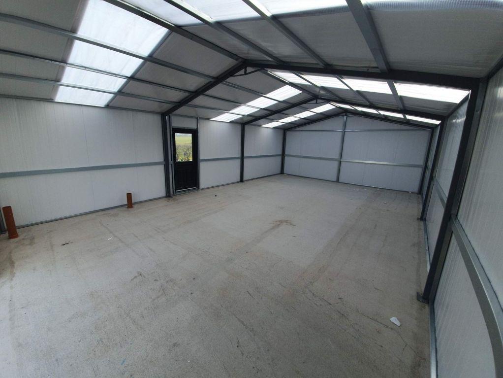

dpmiller Posted March 23, 2022 Author Share Posted March 23, 2022 Shed arrived yesterday. Yay! Roller door being fitted today. Now to get stuck into wiring it up and getting some racking sorted 2 Link to comment Share on other sites More sharing options...
Conor Posted March 23, 2022 Share Posted March 23, 2022 BIG shed Link to comment Share on other sites More sharing options...
SteamyTea Posted March 23, 2022 Share Posted March 23, 2022 37 minutes ago, dpmiller said: Shed arrived yesterday. 20 minutes ago, Conor said: BIG shed Looks bigger than my house. Link to comment Share on other sites More sharing options...
Gone West Posted March 23, 2022 Share Posted March 23, 2022 1 hour ago, dpmiller said: Shed arrived yesterday. That looks good. If you don't mind me asking what size is it and what make. I'm looking for something similar. Link to comment Share on other sites More sharing options...
dpmiller Posted March 23, 2022 Author Share Posted March 23, 2022 it's 6x10, from C&S in Tullamore. 40mm insulated, insulated roller door. 1 Link to comment Share on other sites More sharing options...
Onoff Posted March 23, 2022 Share Posted March 23, 2022 Very jealous. Link to comment Share on other sites More sharing options...
SteamyTea Posted March 23, 2022 Share Posted March 23, 2022 14 minutes ago, dpmiller said: it's 6x10 Yes, bigger, by 28 m2. So allowing for my upstairs, about the same size. Link to comment Share on other sites More sharing options...
