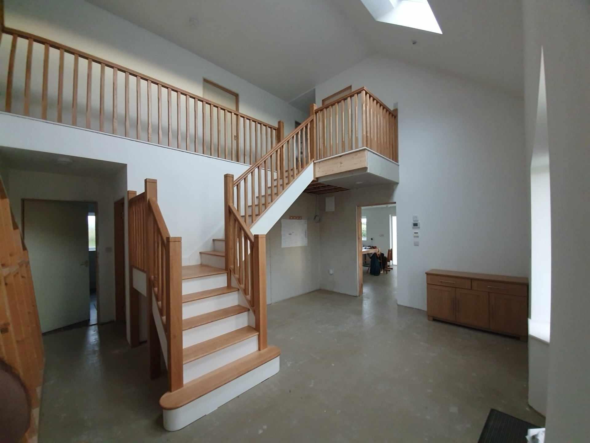

well after a year of notdoingverymuchreally this week marked a milestone- final stairs.
384523357_1369696210638348_9183737004370415899_n.thumb.jpg.d7c5066b52fe35ab6730956580b7d035.jpg
Get some gloss on that woodwork and it'll look stunning! ;)
Are you just trying to get your painter daughter a job, miles from home.
I've not seen wooden treads and painted risers before, but it looks good.
thanks all. Yes we thought all oak would've been too imposing (never mind the cost implications, lol) and we're well chuffed with the outcome. Just need to insert the last bit of stud wall under the stair now to make a cloak cupboard.

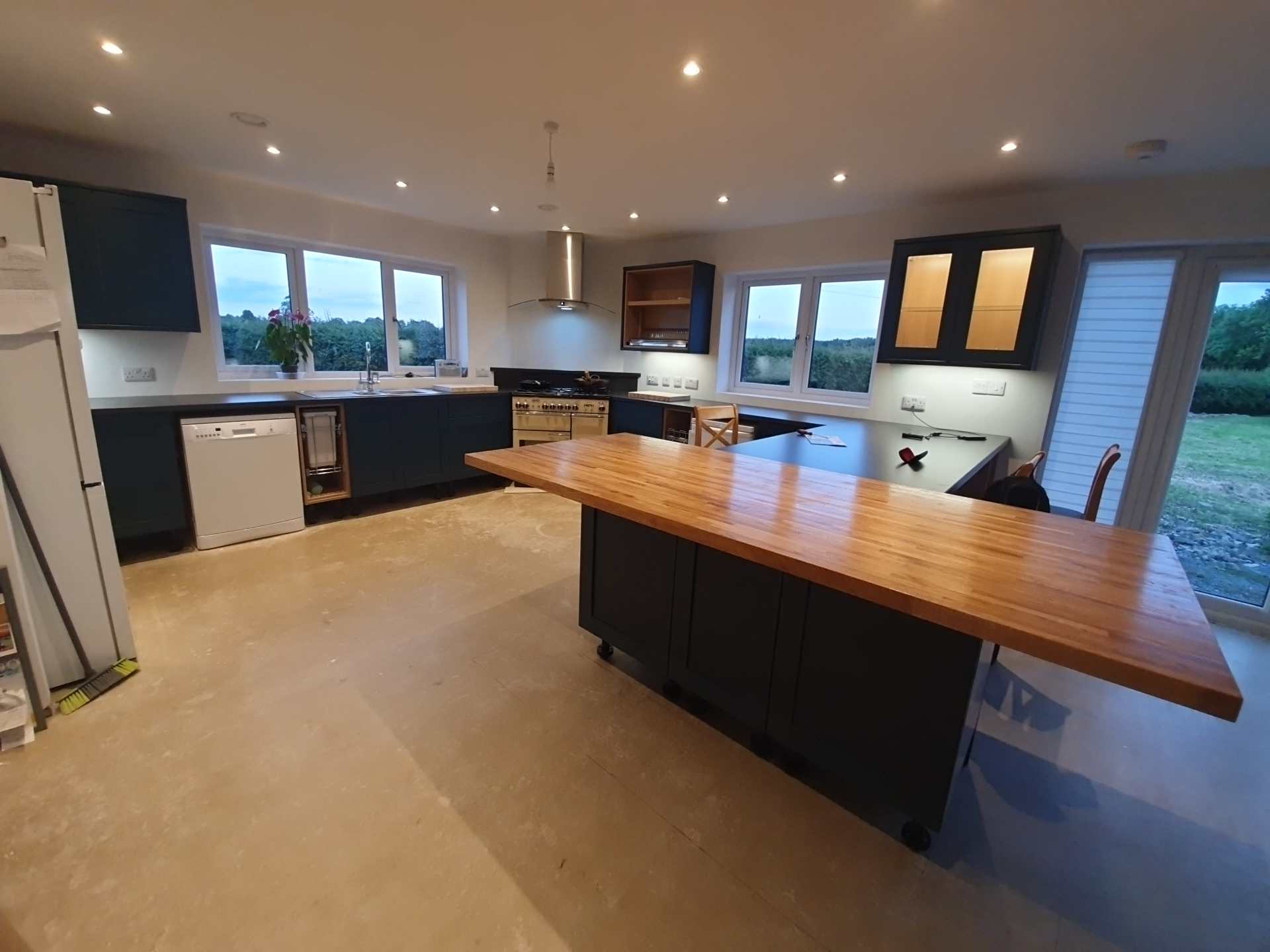

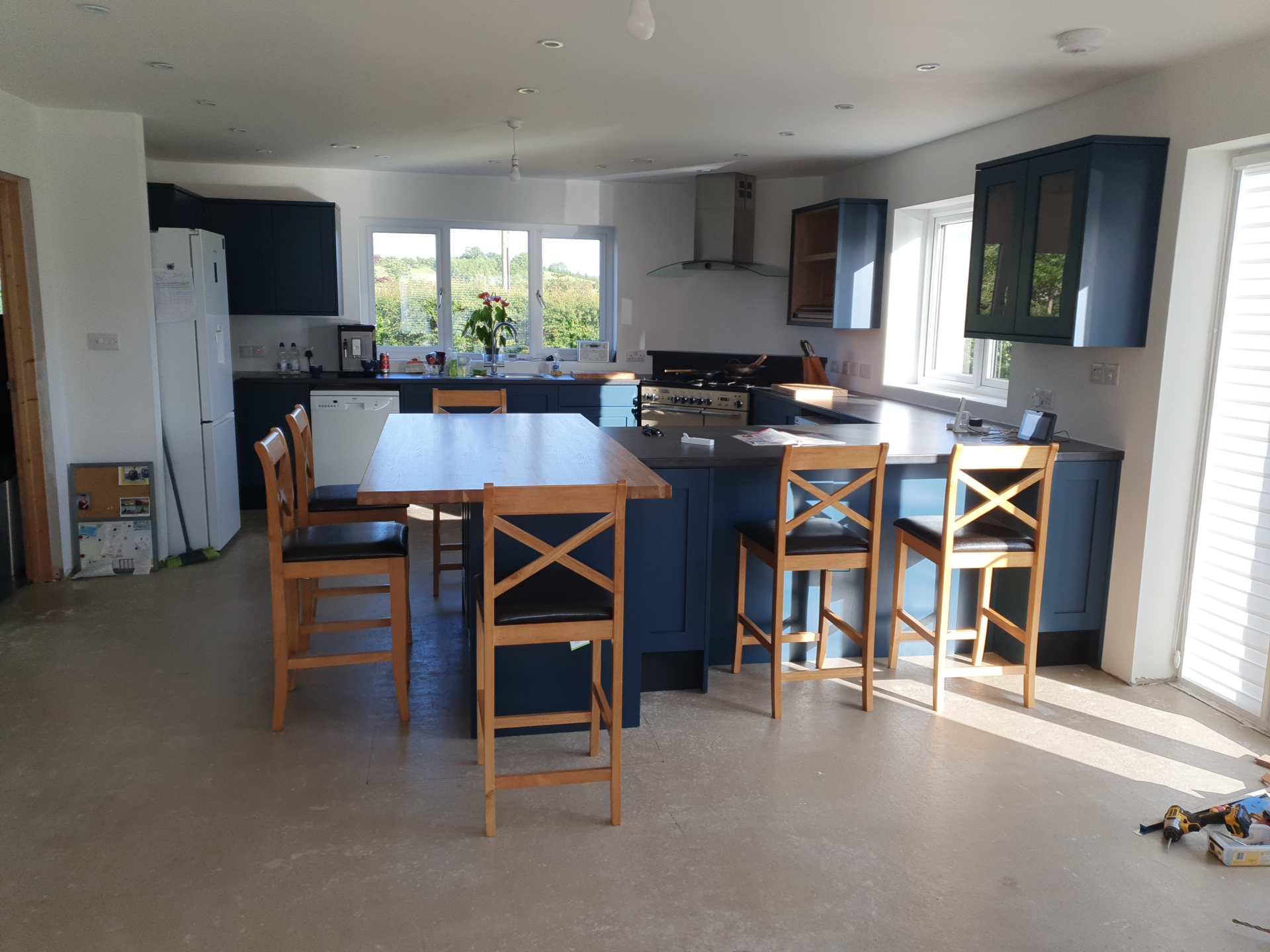

Sitrep 01/25
Kitchen in during the summer, tiling on the to-do list
2024-06-04_21-37-26.thumb.jpg.e48bc5dff76c8be5556b819336448a85.jpg2024-06-10_19-23-12.thumb.jpg.17dfff580ac5fa92b0f5ba77e715148e.jpg
