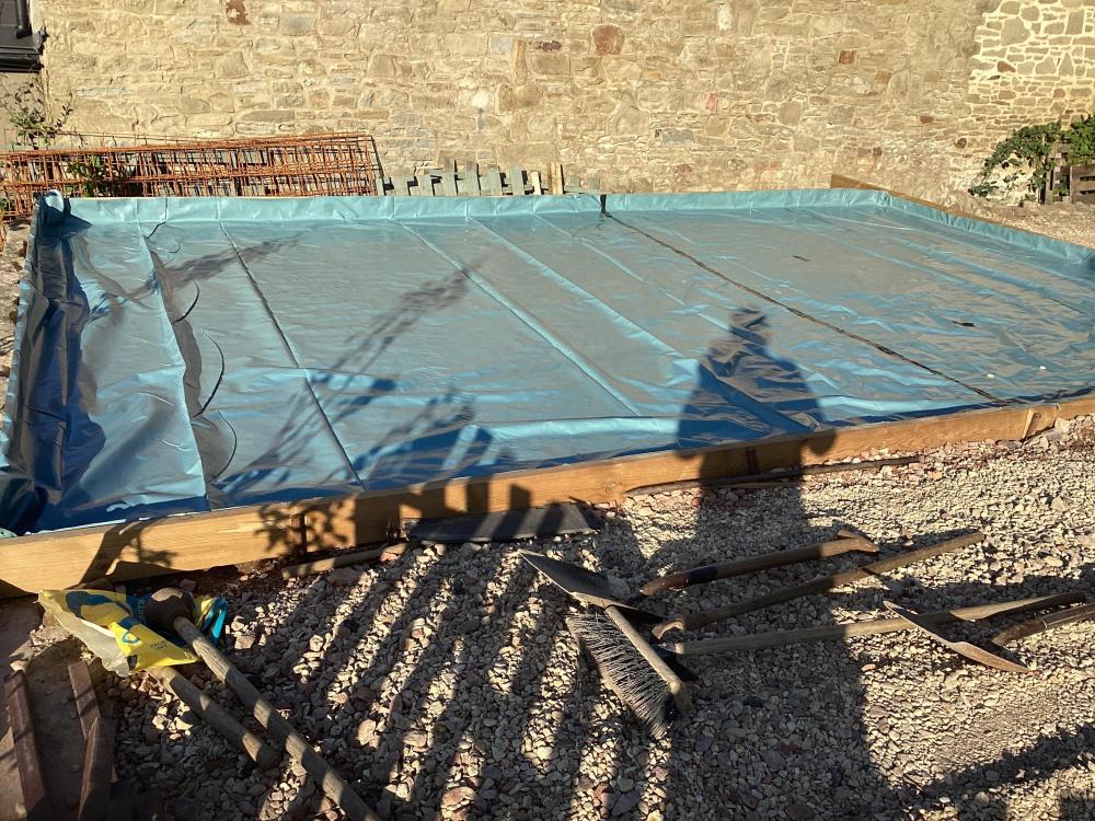

joe90 Posted June 25, 2023 Share Posted June 25, 2023 As I cannot find a contractor to lay my garage base (they are all very busy or don’t want to know). I think I will have to lay it myself with two strapping lads to do the hard work shifting it around. My last garage floor was rough (don’t ask) and I want a proper flat sealed floor this time. My slab is only 24 sq m (6 x 4m). My question is is it worth hiring a power float (nearly £100) fir such a small area when I can hire a bull float for a lot less. Answers on a postcard……… Link to comment Share on other sites More sharing options...

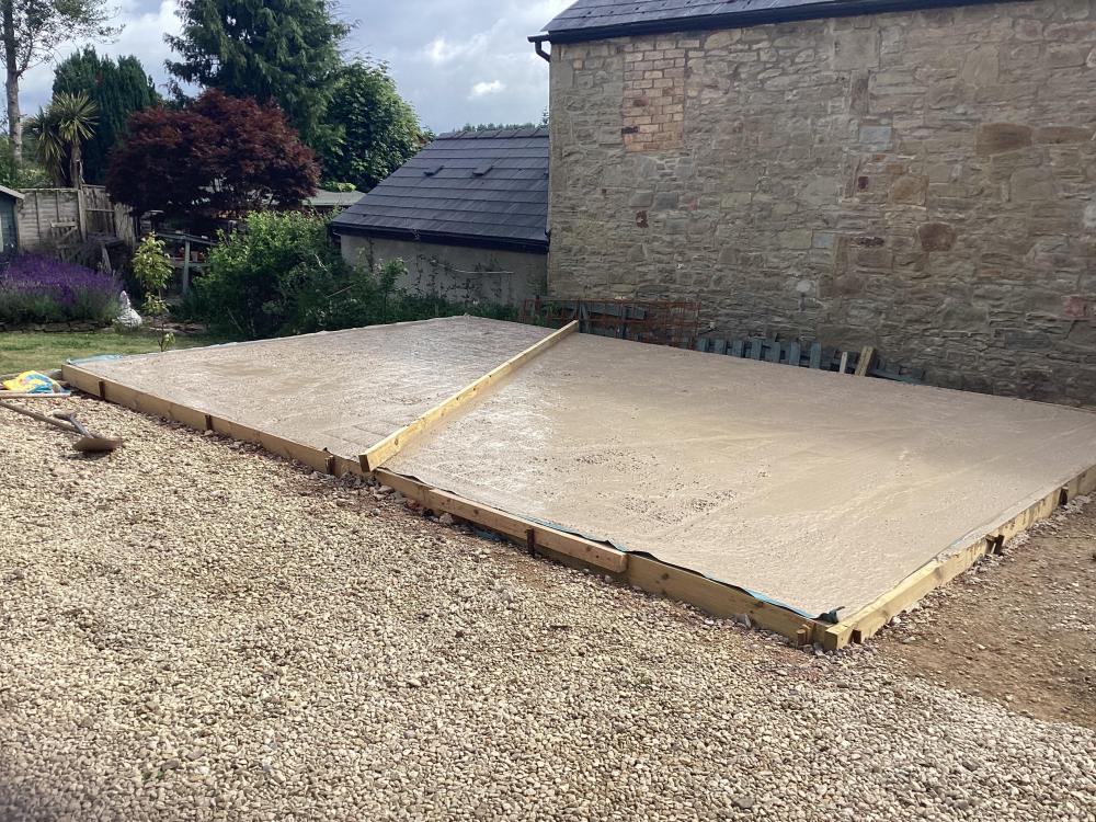

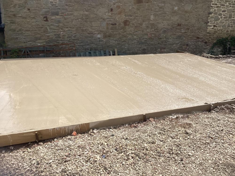

joe90 Posted June 27, 2023 Author Share Posted June 27, 2023 (edited) Sit rep, finally got some labour jacked up for Saturday to lay the concrete but no suppliers will deliver on a Saturday unless I have a full truck load 🤯. Trying to arrange labour for a weekday. I am going to manually tamp with 2x4 then bull float, I can always trowel by hand any imperfections when nearly dry. Edited June 27, 2023 by joe90 1 Link to comment Share on other sites More sharing options...
