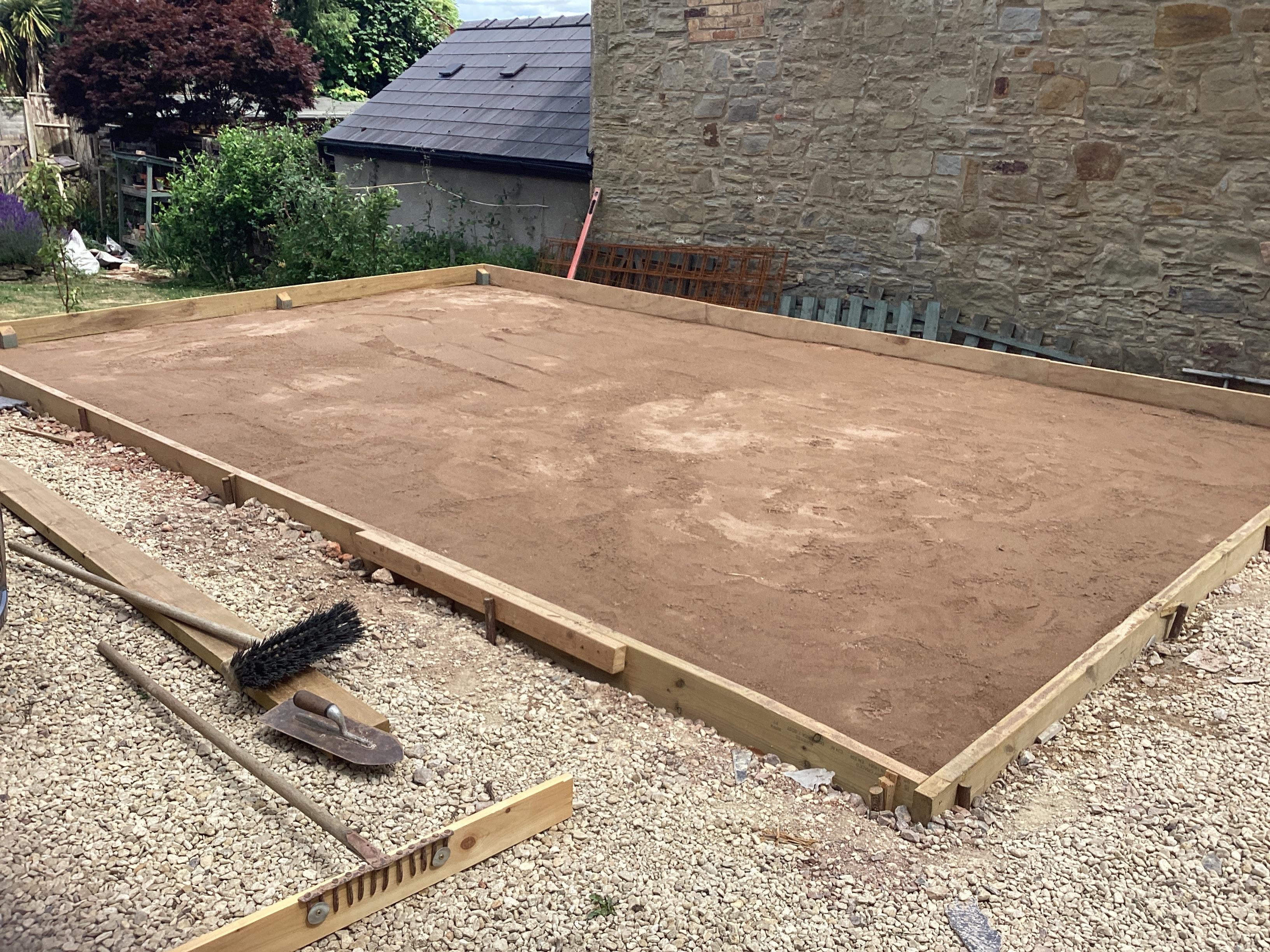

  • Already for concrete being delivered in the morning. I roped my daughters boyfriend and his mate to shovel it for me whilst I “project manage “ (make the tea) and trowel it off with an “easy trowel” o
  • saveasteading
    saveasteading
    No. There are 2 kinds  the turning blade which us the norm on big slabs. They take a lot of learning and strength and aren't much use round the perimeter. Vibrating tamp. Yes this would

5 minutes ago, joe90 said:
full truck load
What size truck? Some depots have 4m3.
I don't think we know the slab thickness, or if you can use any surplus for garden gnomes.
Just to be sure.....are there any volumetric suppliers in your area. Suits small pours in so many ways.
The concrete plant will only open on a sat  fir a large full truck load minimum, yes truck is small (my access problems).

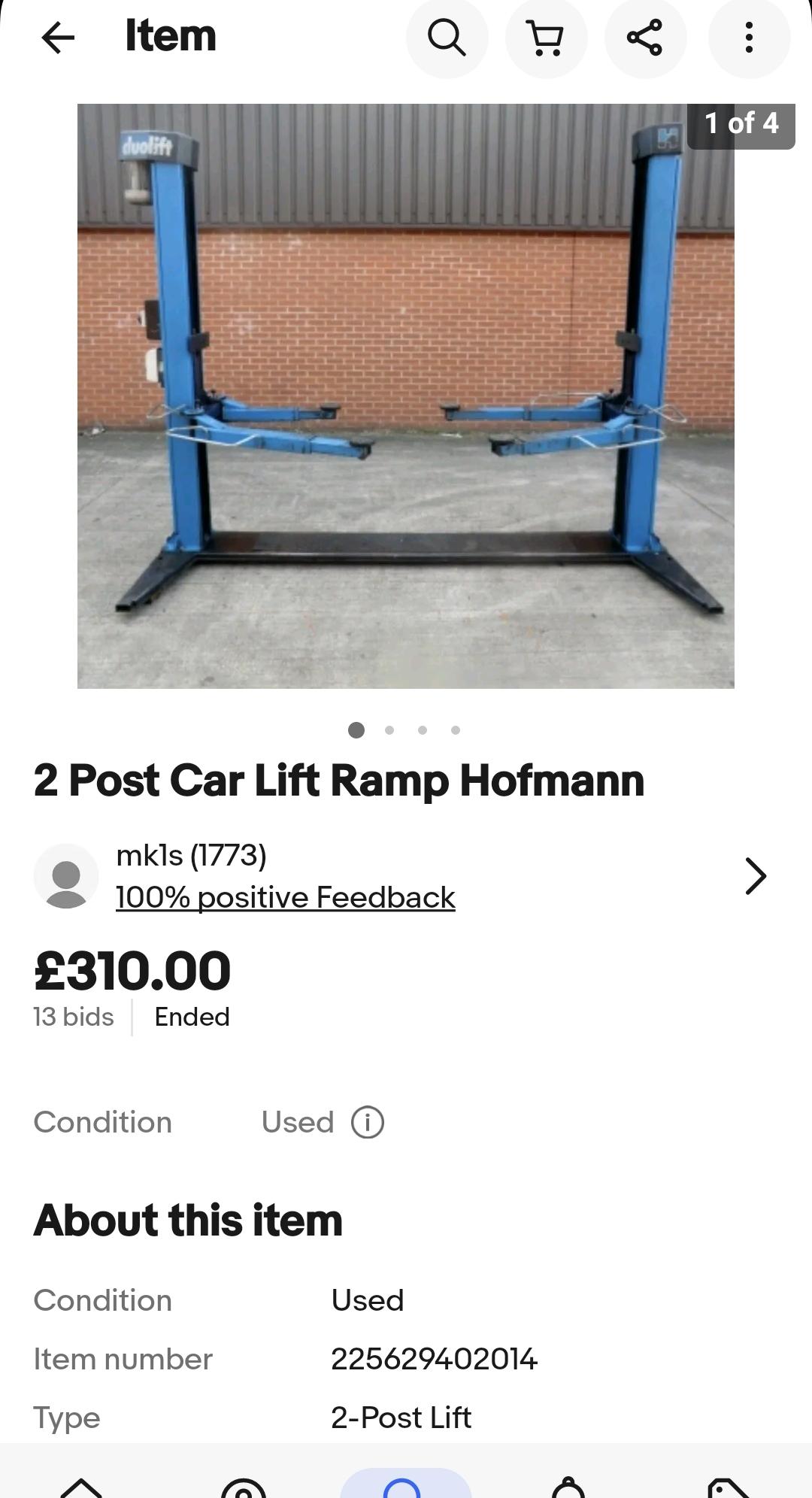

Screenshot_2023-06-27-11-37-12-206-edit_com_ebay.mobile.thumb.jpg.e33cb4c39607680e41ccee7df08af7c0.jpg
I wouldn't bother with a pit given the prices you can pick up a serviceable lift for. No chance of gas death either.
I would wager a DIY installed and used lift is just as dangerous as a pit.
Plenty of mishaps here.
I haven't seen any that weren't caused by incorrectly placed supports or in braked vehicles.
13 minutes ago, ProDave said:
diy nstalled and used lift is just as dangerous as a pit.
But I've also  seen a professionally installed one that had fallen over complete with truck.
Small anchors fitted that pulled out  of the concrete.
The instructions were perhaps in Italian.

Looking good, question, as the truck only has 3 shutes it only reaches half way over my 6 meter long slab, minimix offers “free flowing concrete” sound much easier to push to the back of the slab, any downsides?
As long as this is designed with smaller aggregate and a plasticiser to increase flow, then ok. Absolutely do not add water or allow anyone else to do so. Extra water reduces strength and increases shrinkage cracking...whatever anyone else argues.
Have you decided where any surplus and the washout slops are going?  As a last resort, leave it in the barrow.
