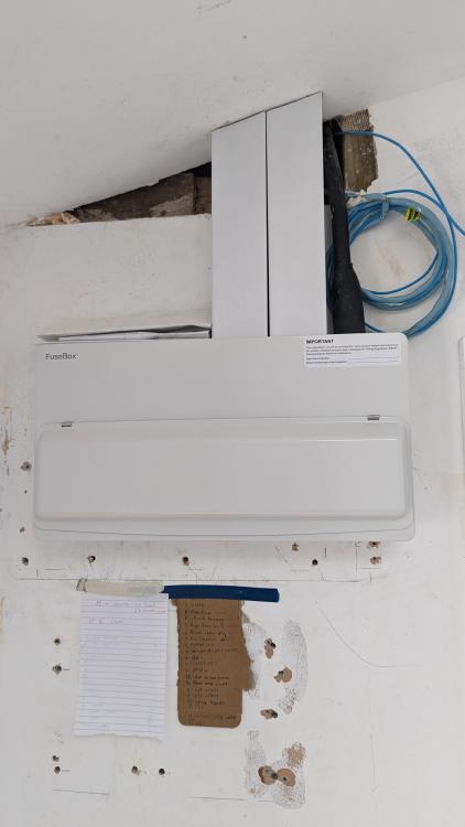

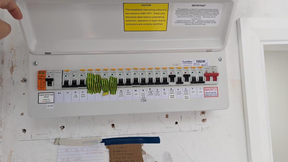

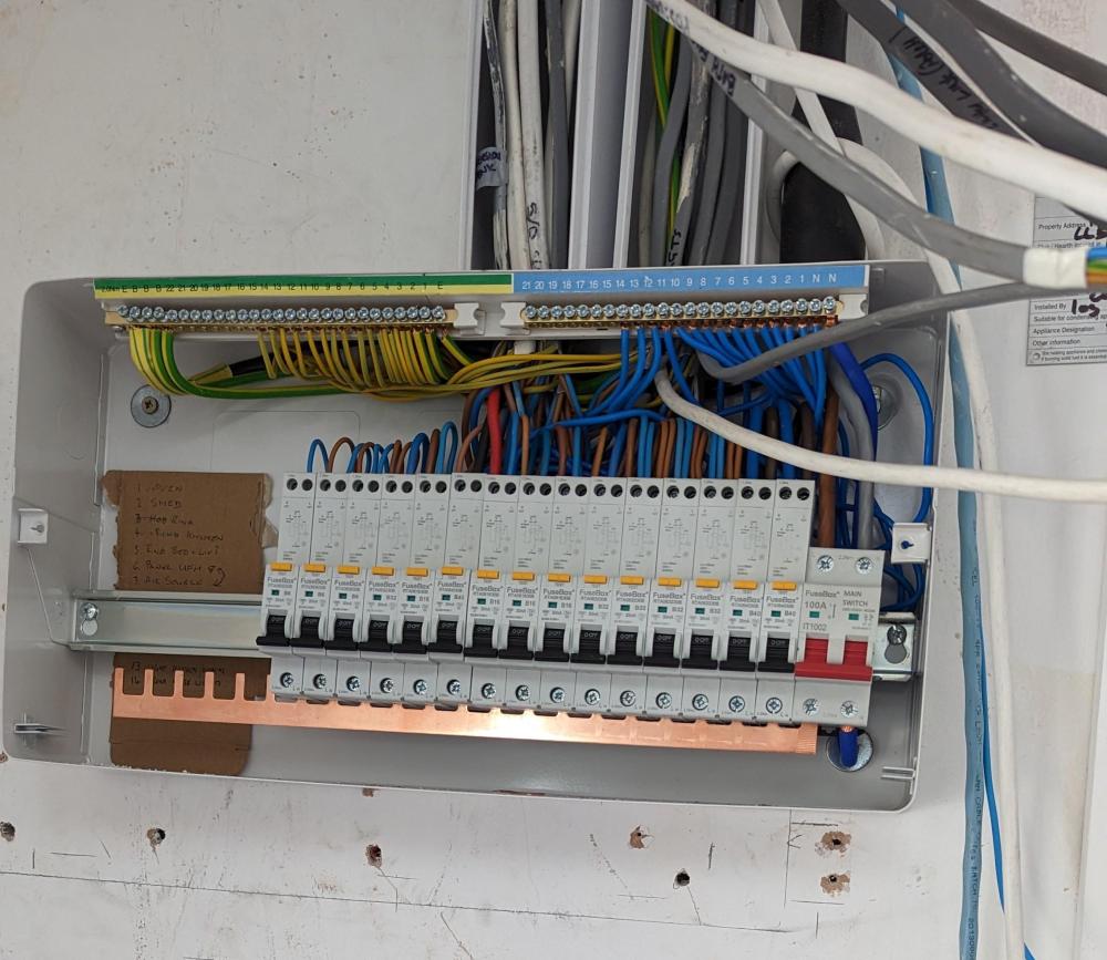

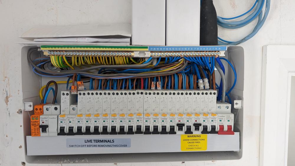

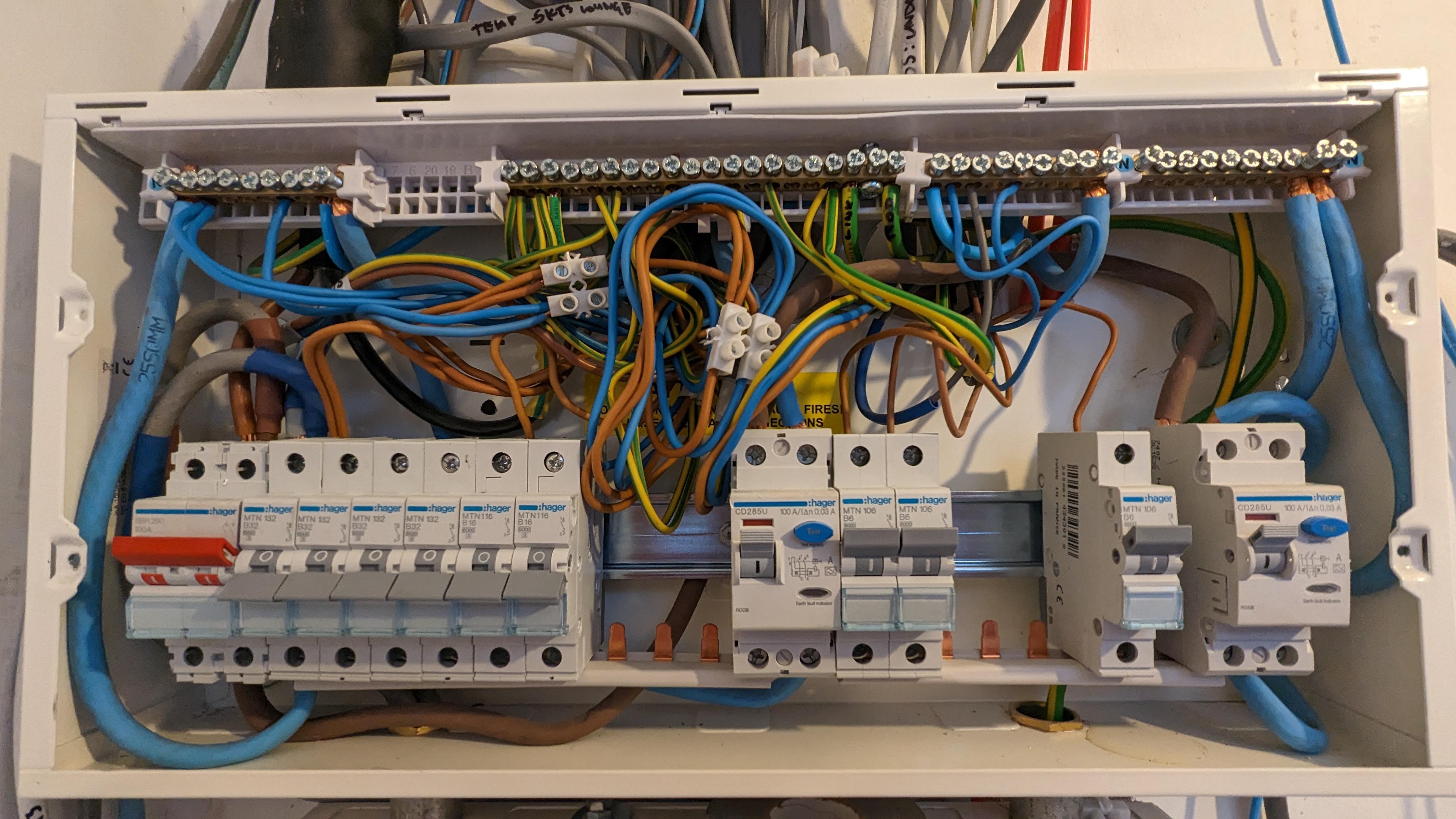

connick159 Posted May 10, 2023 Author Share Posted May 10, 2023 Pics. Looks like a bowl of spaghetti ☹️ He says "yes it's still messy at moment but will tidy up". Link to comment Share on other sites More sharing options...
TonyT Posted May 10, 2023 Share Posted May 10, 2023 What a bag of crap. Link to comment Share on other sites More sharing options...
ProDave Posted May 10, 2023 Share Posted May 10, 2023 12 minutes ago, TonyT said: What a bag of crap. The more I look at that, the more I think OMG. There is so much potential for getting things wrong there, let alone it is untidy. What an earth are choc blocks doing in a CU in a rewire? 1 Link to comment Share on other sites More sharing options...
LA3222 Posted May 10, 2023 Share Posted May 10, 2023 I'm not a spark but the first thing that smacked me in the face looking at that is the choc blocks.... I feel for you bud as you probably aren't getting the feedback you hoped for here and you're in a bind now. Do you stick or twist....the difficulty with twisting is trying to find someone that will test and certify another's work and given the reaction from one of our resident sparks, they may look at this and say no thanks. Hopefully you will get enough from the folks who know on here to allow you to sort the fault and get across the finish line with that setup working and signed off. Link to comment Share on other sites More sharing options...
Jenki Posted May 10, 2023 Share Posted May 10, 2023 This is a rewire🧐🙈. My OCD can't cope with the wires entering the CU, never mind inside. @connick159 are you sure he's an electrician😞. Did you see him using a larger tester before powering up circuits.? To help us help you can you ask him for his test results ? We might be able to see the problem, (answer will be he hasn't done it yet or doesn't do it..) The dead tests @ProDave mentioned earlier would identify crossed circuits, and or N-E faults. If your electricians fault finding is maxed out at plugging in a socket tester then he's going to struggle. Link to comment Share on other sites More sharing options...

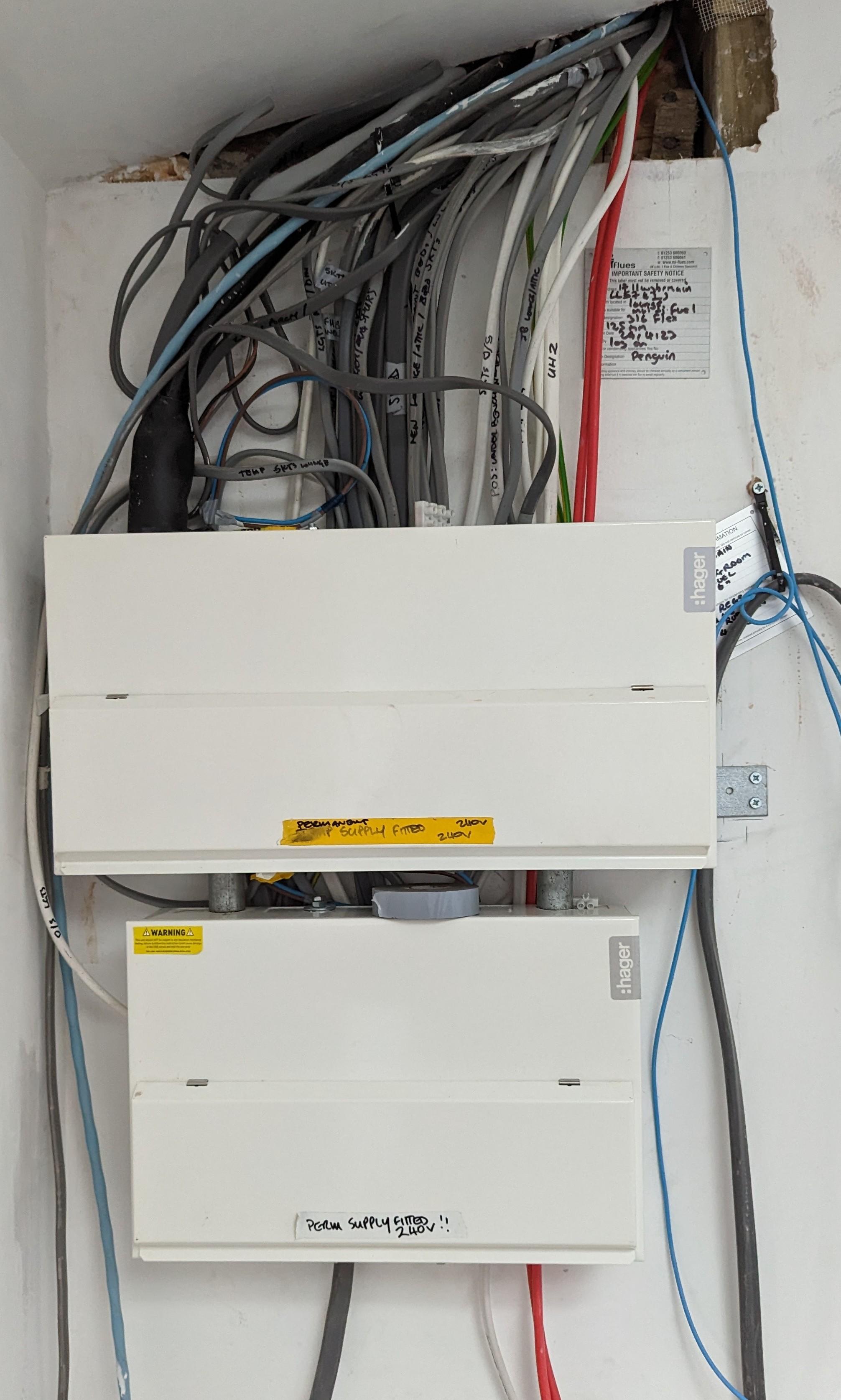

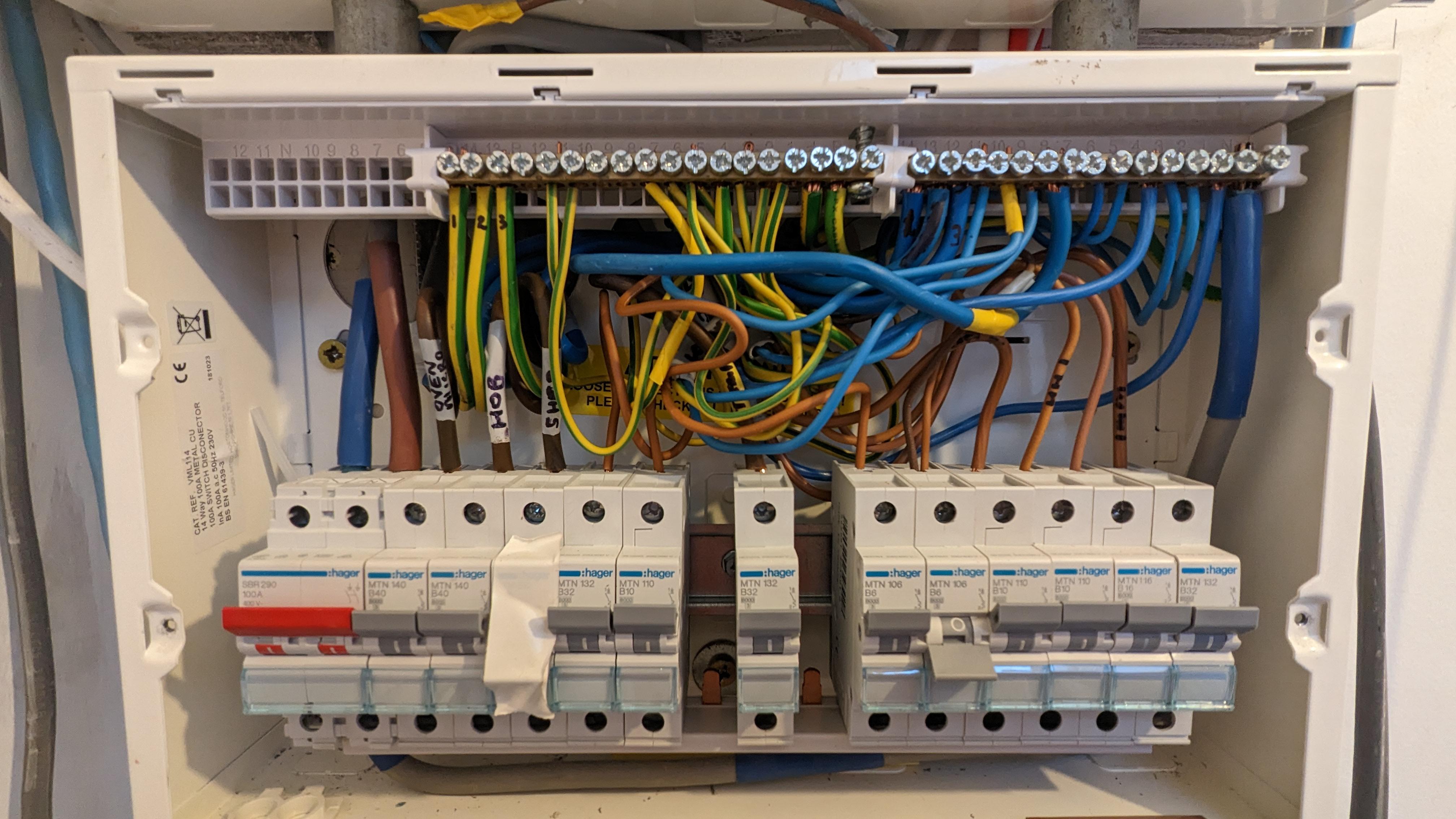

ProDave Posted May 10, 2023 Share Posted May 10, 2023 There is such a tangle in there it will be impossible to fault find it remotely. I am still trying to work out where the bottom CU gets it's feed. It must be somewhere from the top CU otherwise why no rcd or rcbo. Time for a frank discussion with your "electrician" Link to comment Share on other sites More sharing options...
Big Jimbo Posted May 10, 2023 Share Posted May 10, 2023 @Jenki hate to say, i'm with you. A socket tester plugged in is what he considers testing. Link to comment Share on other sites More sharing options...
joe90 Posted May 10, 2023 Share Posted May 10, 2023 Bag of shit. I hope you have not paid him? Link to comment Share on other sites More sharing options...
connick159 Posted May 10, 2023 Author Share Posted May 10, 2023 Re the connector blocks. He said he's using them to transfer things to the bottom CU to see if taking the rcd out of play stops the tripping. The power for the bottom CU is coming from the top cu I think. The main board is at other ond of house and an armoured is running to this point which is close to the middle of the house. It's a single story place. The added difficulty is that he is also a family friend which makes things even more awkward. Thanks for the advice so far. Tough to hear but aligns with what I've been thinking. 1 Link to comment Share on other sites More sharing options...

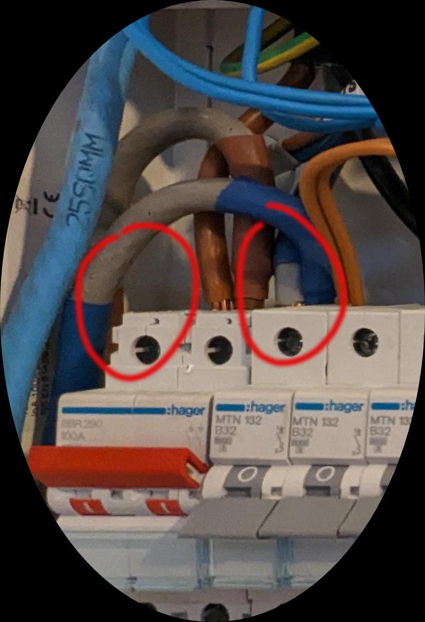

Jenki Posted May 10, 2023 Share Posted May 10, 2023 (edited) 45 minutes ago, ProDave said: I am still trying to work out where the bottom CU gets it's feed. Got me thinking. Looks like there is no neutral in the isolator, but in MCB? This will cause the tripping. Is the idea that the 32mm MCB is feeding the second CU? The Supply N needs to be in the isolator, then out of the isolator into the RCD's input. Edited May 10, 2023 by Jenki 1 Link to comment Share on other sites More sharing options...

Nickfromwales Posted May 10, 2023 Share Posted May 10, 2023 6 minutes ago, Jenki said: Got me thinking. Looks like there is. No neutral in the isolator, but in MCB? No. That's the perspective of the photo. The two browns are in the MCB. Link to comment Share on other sites More sharing options...
