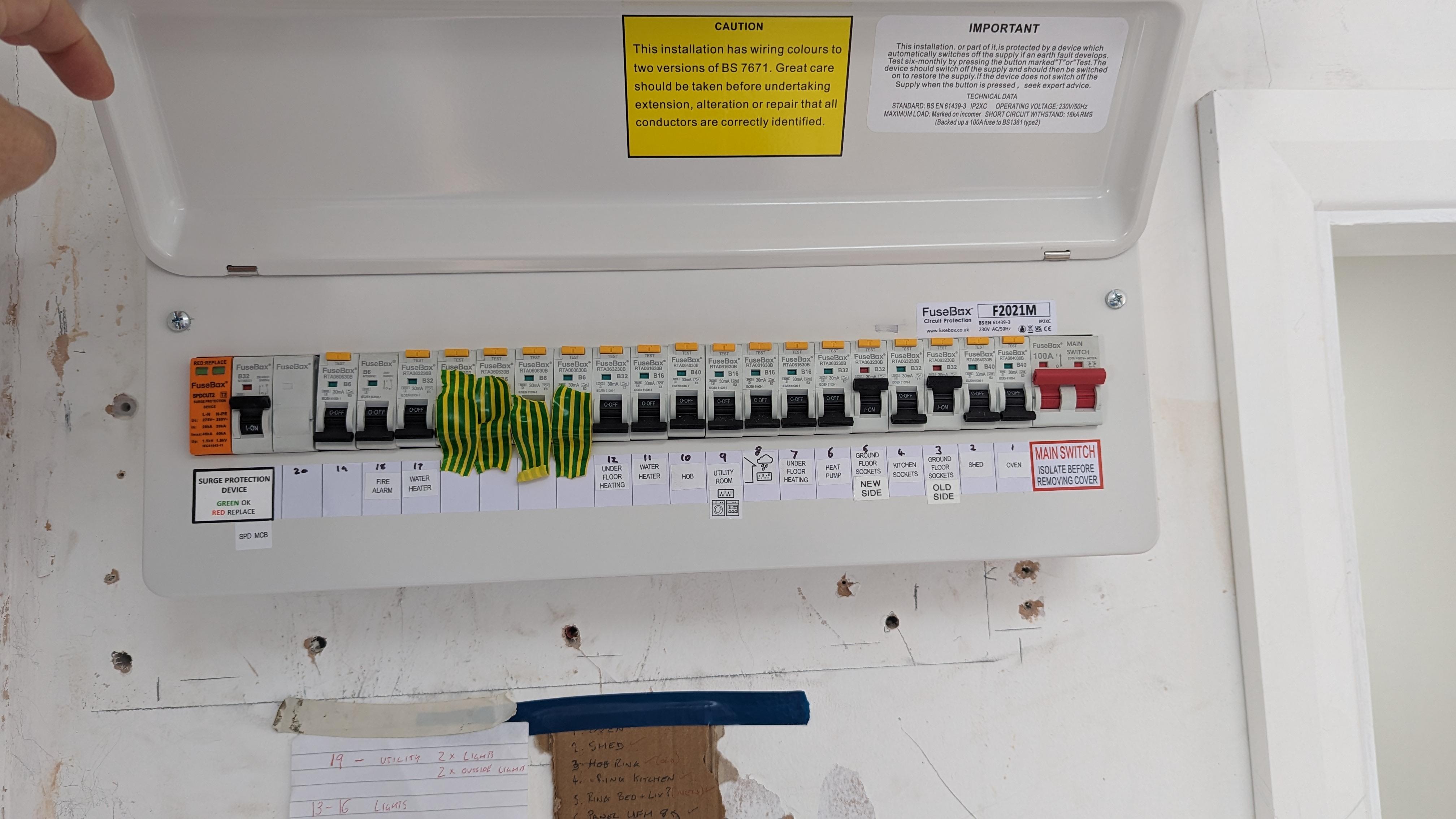

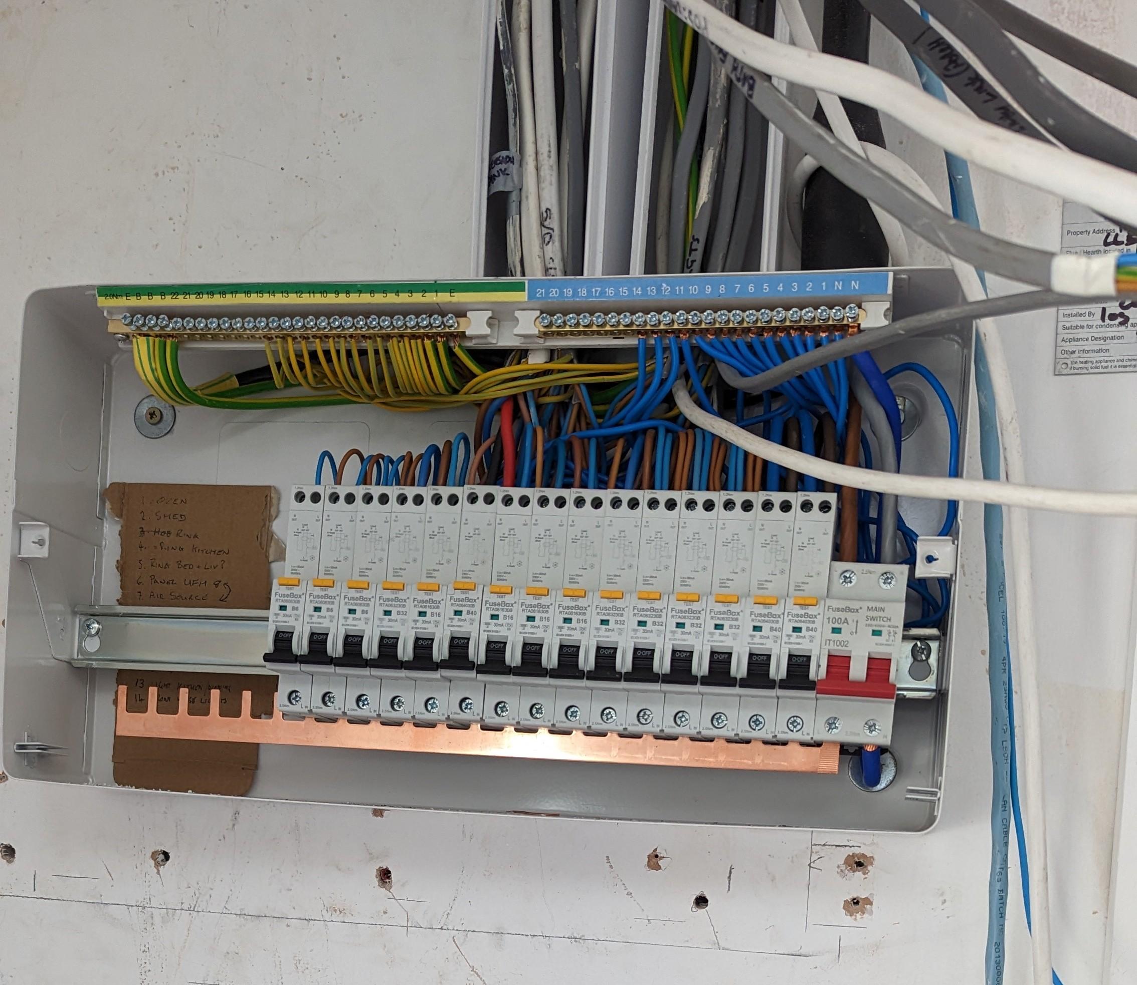

    Update: Unfortunately they couldn't finish all the testing as a fair few junction boxes in attic still need finishing and boxing off but they tested what they can and everything has passed except
  • Your electricians has neutrals mixed up between circuits or a N-E fault.  He should know how to test that, and should have done appropriate dead testing before energising.   If he is scratch

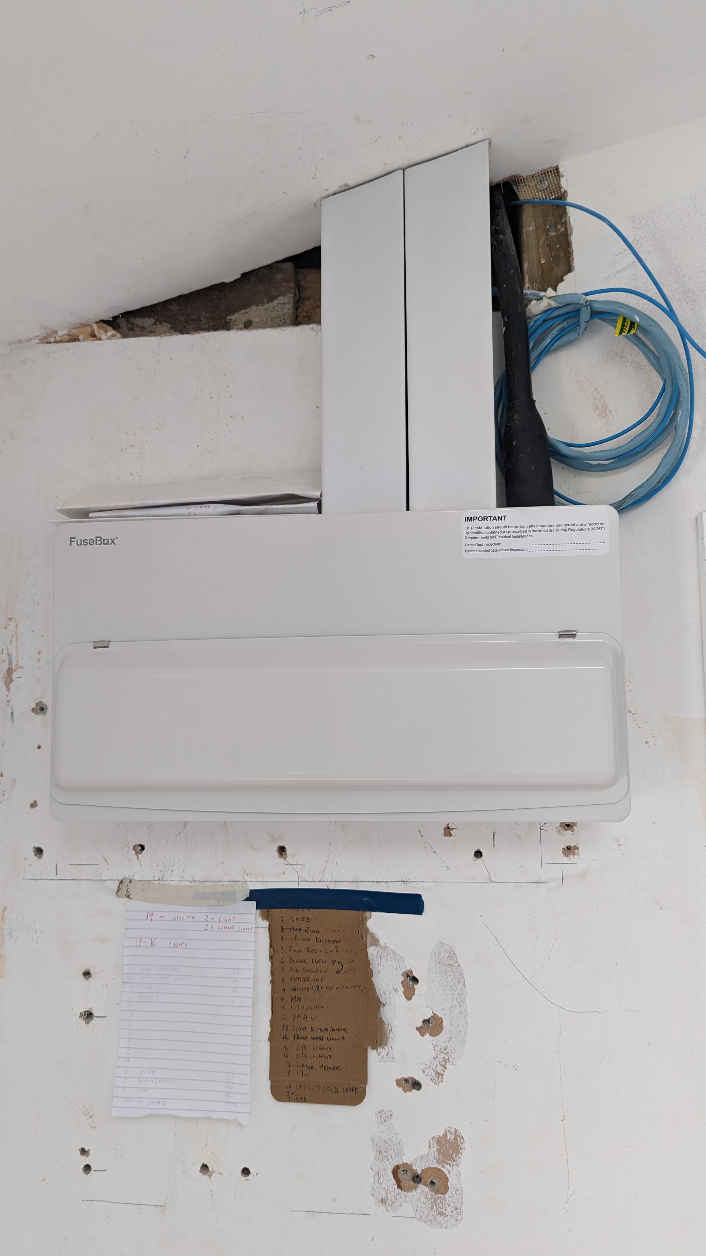

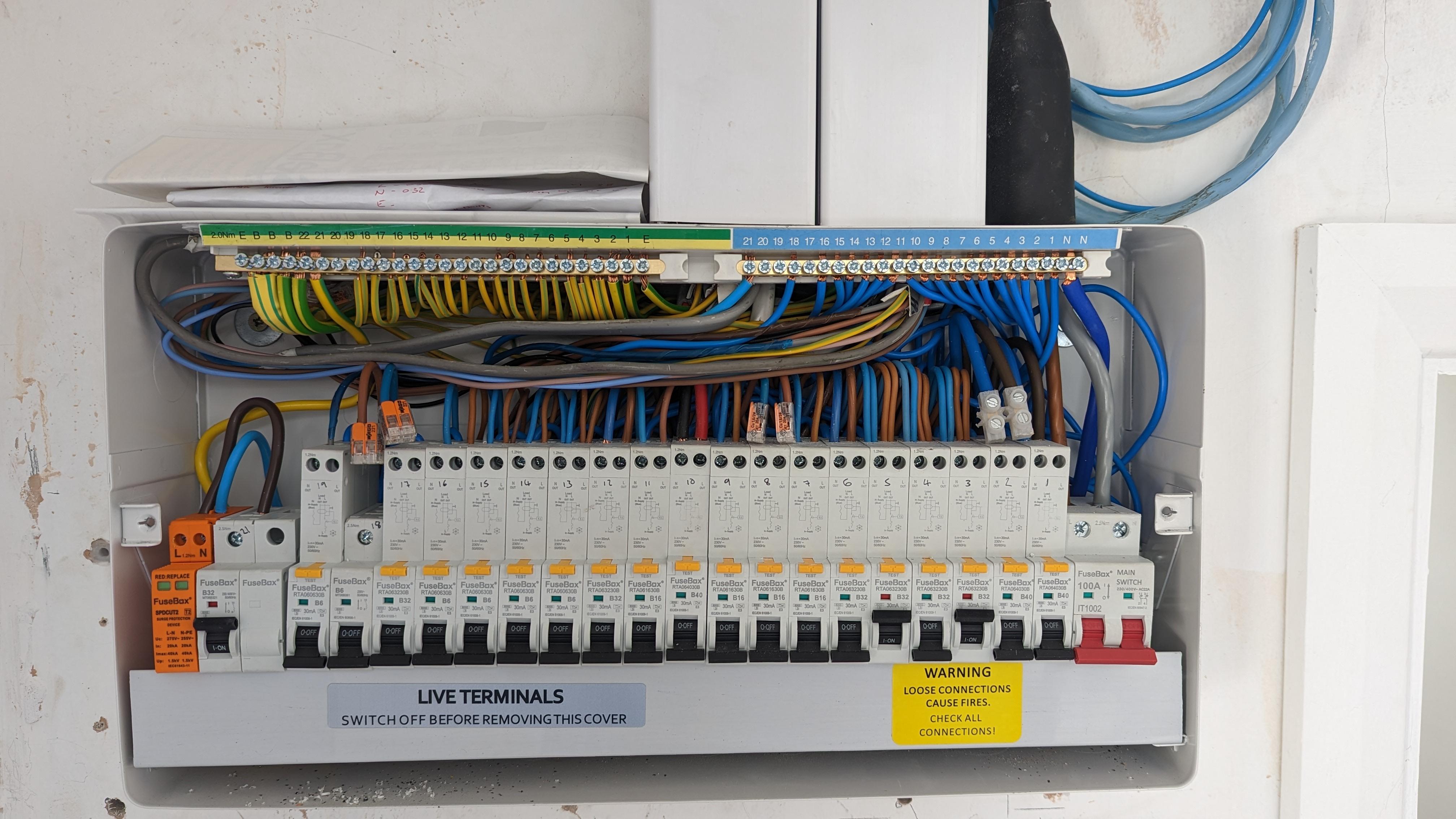

Update:
Unfortunately they couldn't finish all the testing as a fair few junction boxes in attic still need finishing and boxing off but they tested what they can and everything has passed except lighting (due to attic work required) and kitchen sockets due to an "earth continuity fault". They asked for the other guy to finish the JBs in the attic and fix the earth fault and they'll return next week to finish up and test the rest as they are working away from tomorrow.
Here are a few of the latest pics.
