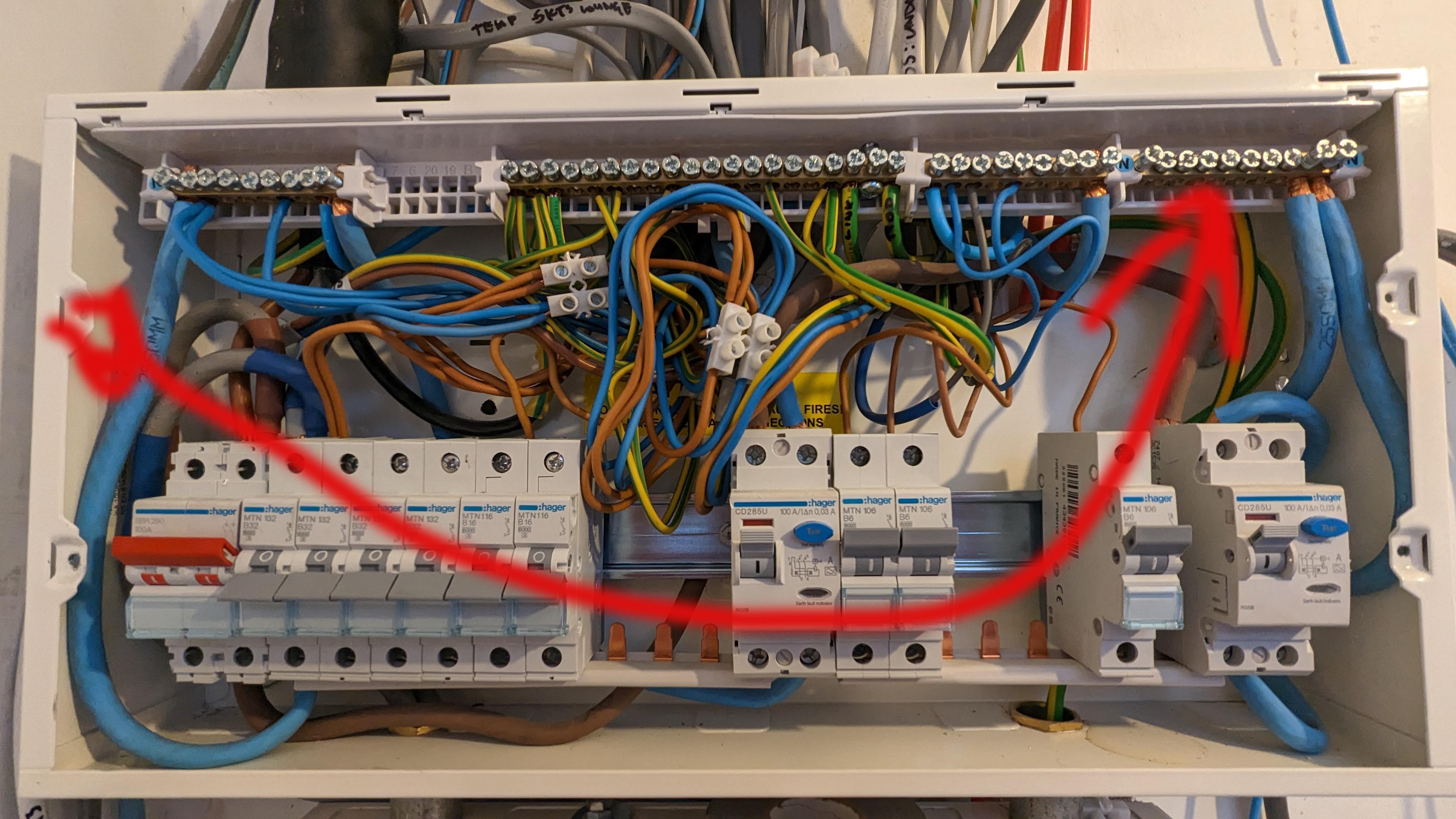

new wiring, all sockets tripping charging a phone !?
7 minutes ago, Nickfromwales said:
No. That's the perspective of the photo. The two browns are in the MCB
@Nickfromwales Ok. Fair enough.
Neutral don't look correct.
One out of isolator into neutral bar above isolator , then some circuit neutrals, and I assume a neutral tail supplying the RH N bar. This will cause the RCD to trip. Circuit cables should be correctly located  in the right hand  2 Neutral bars. Not  with the main isolator, these would be for non RCD circuits?

    Update: Unfortunately they couldn't finish all the testing as a fair few junction boxes in attic still need finishing and boxing off but they tested what they can and everything has passed except
  • Your electricians has neutrals mixed up between circuits or a N-E fault.  He should know how to test that, and should have done appropriate dead testing before energising.   If he is scratch

    Hi all, Just updating. New sparks came in today. Ripped it out and started again. Also added a new isolation switch and SPD on the feed into the armoured cable near the meter coming in.
Posted Images
@connick159.
The above image shows a blank unit. Forget the two bits on the RH side.
On the RH side, follow the blue from the isolator up to the RH N bar. From there 2 N go to the 2 RCD's, from each RCD a blue cable  goes to two separate N bars. Yours doesn't seem to do this. You have circuit cables ( on your CU you have  N bar above the isolator with circuit cables.) These should be in the empty N bar further to the Right.
It is essential that any  brown cables connected to MCBs on  an RCD, the corresponding Blue cables are  connected  the N bar of the same RCD. If not it will trip.
Hopefully this helps.
EDIT:
I think, moving this cable from the left to the right might fix the problem. But use the first photo to make sure the logic is the same.
Edited by Jenki
I think you may be on to something there.
How long it would take to sort out depends on the skill of the electrician and a bit of luck. See if moving that N cable fixes some of the issues?
My concern is he has looped the feed into the top CU down to the bottom CU.  In which case I await the explanation from the "electrician" as to why none of the circuits connected to the bottom CU require RCD protection.

If you look at the empty boards the isolator is on the RH side, and the SWA incoming on the LH side,  possibly moved the Isolator to make it easier and took the Neutral with them.  I think just moving it can't make it any worse. and might be a quick fix.   However the lack of understanding of this, would make me question the quality of the install

I'm pretty sure you've hit the nail on the head. An armoured cable brings the feed in from the main fuse and it was put in first I think from memory. The cu then came in and I think he swapped it around as the armoured was on the left. Tbh though, I'm not 100% sure as I was happy to finally be able to outsource a job rather than do it myself so kind of switched off and left them to it.
Thanks for all the help. I think I will pull the main fuse, move that N cable and run the mobile phone charger test again.
Is looping the feed from the top a "big no no"? What is a better way. To put some kind of link or splice onto the main armoured and having that go into an isolator on the bottom board?
I think there was RCD's on the bottom but he's moved some of the circuits originally on the top cu down in order to troubleshoot/test and has taken out the rcd's. Again, I'm not 100% sure though. I'll ask.
The plan originally was to have main house in top CU and then things like the ashp, garage, outside lights and power, ufh controllers on the bottom. 🤷
I am not convinced that the terminals will take two feeds like that, I would want to give them a good wiggle test to ensure they really are clamped properly and secure.
I was questioning why no RCD on the bottom CU I think you have answered it that he has removed it, presumably because it was tripping as well?
What really needs to happen is every circuit disconnected.  Confirm the CUs really are configured correctly and work properly, rcd's tested etc.  Then one at a time dead test then reconnect each circuit and then live test it.  If that works, move on to the next etc.  That is probably what a fresh electrician would do if someone else comes in to sort out the mess.
And I agree with a comment above, before re connecting one circuit at a time, agree on a sensible split of circuits between the two rcd's,

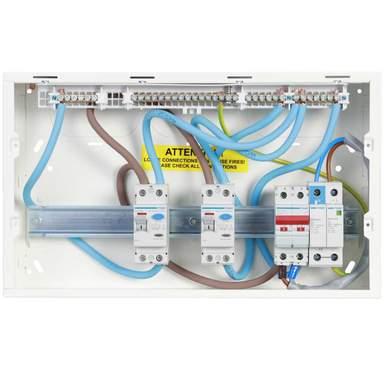

I would try and reconfigure it as a "high integrity" board so the one MCB feeding the bottom board does not have RCD protection, that would be provided in the bottom board.  It's nearly there with the 3 neutral bars, you would need one extra L jumper to do that, I keep a collection of spare CU bits that would probably yield something.
Something like this you mean?
https://www.cef.co.uk/catalogue/products/4780707-10-14-dual-row-dual-rcd-high-integrity-metal-clad-consumer-unit-with-spd?gclid=CjwKCAjwx_eiBhBGEiwA15gLN1B9KDl4I_EtiEt87vcTFCDU1e_1h0pahuWpq-aWnoGrbOvtP0dfSxoCCtkQAvD_BwE&gclsrc=aw.ds

L jumper Live Jumper.
This page explains it well  https://www.consumerunitworld.co.uk/what-is-a-high-integrity-consumer-unit-and-how-to-populate-it-331-c.asp
You already have the high integrity neutral configuration with the 3 neutral bars.  you just need to space it out as shown on that page.
The "High integrity" circuit (just one in this case) will be a single MCB right next to the main switch, so you need just a 2 prong busbar to link the L out of the main switch to this single MCB.  That will be the one that feeds to the bottom CU.
Then the 2 RCD's each have a multi prong busbar feeding their MCB's.
The bottom CU could have an RCD after it's main switch (or even instead of) or a row or rcbo's.
Picture from that linked site:
