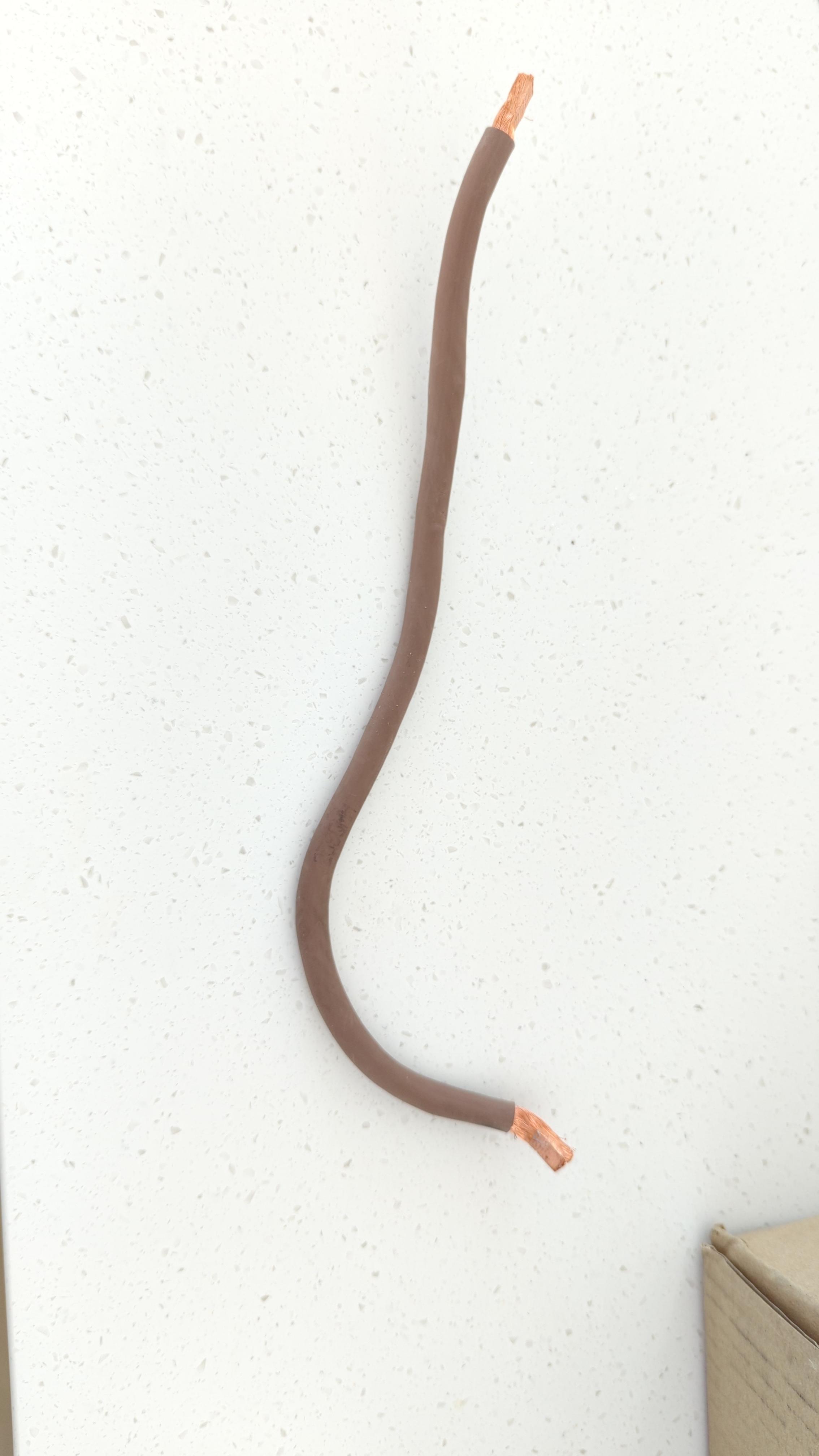

Not quite what you want.  If you set up your top CU as that picture I copied from the linked website, you just need an additional 2 prong bit of busbar

You could buy a length and cut it down, but any electircian worth his salt will have odd bits of it lurking somwhere.

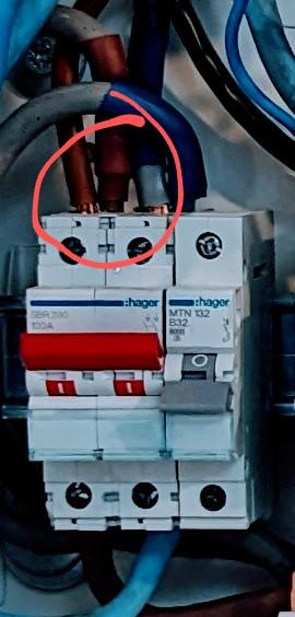

Ah yeah, got that. I meant to join the top cu and the bottom one.
At the moment he has the live from the armour going into the main switch and "daisy chained" I guess you could call it straight down to the
Main switch in the bottom cu (see pic).
What I think you are saying is to use the 2 prong busbar to join then main switch in the top to the rcb next to to it. But... From that rcb (or was it mcb) do you then run a cable down to the lower cu so can do away with that "daisy chain" set up out of the top cu's main switch to the bottom cu main switch.

You shouldn’t have copper on show at the terminals.
Is it worth glanding the Swa into a metal enclosure via some din rail terminals, transition to tails coming out straight into a pair of Henley blocks, then take 2 sets of tails from the Henley blocks to each db
assume the Swa at the other end is in a kmf fuse switch or similar as the cutout is more than 3 meters away?
that way every main switch only has one set of conductors in it and can be safely torqued to the correct setting

The main switch can only take 35mm2 max  so doubling up is against the MI.

Update: he's not back till Sunday so while main fuse was out a swapped things around. Took out some mcbs and re did the way the RCDs were connected based on advice here. (Just top CU at this stage.)
I put the lighting and socket circuits on the RCD as well as oven and hob. Put main fuse back in then turned it all on.
Sockets and lighting both work without any trips like before. Result! There was a neutral being crossed from what I could see so once each RCD was on separate N bars prob resolved (I think)
Will leave it there but thanks for all the help. Next challenge is having the WTF conversation on Sunday. New bloke coming for a look on Tuesday.

The fact your "electrician" could not figure that out shows his lack of competence.  So progress at last.
Quite probably all you have to solve now is getting a proper feed to the bottom CU without that over crowded mess in the main switch, allocating the circuits properly and testing them properly as you go, and getting some form of RCD protection to the bottom board.
