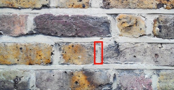

ToughButterCup Posted May 4, 2023 Posted May 4, 2023 12 hours ago, PeterW said: Make sure the brickies use full perp ends and not a smear ... What's a Perp End please?
ToughButterCup Posted May 4, 2023 Posted May 4, 2023 Now show me a smear, please....... (in other words how does a non-brickie tell the difference betwen the two [a perp or a smear])
saveasteading Posted May 4, 2023 Posted May 4, 2023 A fully mortared face between the perpendicular faces of adjoining bricks. For an amateur like me it is tricky. For some "bricklayers" also perhaps. And many will simply apply the minimum to the front edge for their ease, as they will usually get away with it.
ToughButterCup Posted May 4, 2023 Posted May 4, 2023 15 minutes ago, saveasteading said: ..... as they will usually get away with it. Which is exactly why I asked the question. For a 'Switched - On ' Buildhub Member, visiting their build once a day or so, how would she / he tell that the ends were smears instead of full 'perp' ends? I've spent a little while trying to find examples on YT. No luck.
Canski Posted May 4, 2023 Posted May 4, 2023 You can easily tell if the joints are full from the rear of the faced brickwork if it has been built prior to the blockwork. ( only possible with full fill or blown in insulation) This is (usually) the brickies preferred method. We go round the back and smear all joints full while the mortar is still wet. On some sites now they are asking for the rear of the wall to be tooled with a bucket handle. I think that is a bit over the top. 1
saveasteading Posted May 4, 2023 Posted May 4, 2023 16 minutes ago, Canski said: I think that is a bit over the top. Unnecessary with a good and thorough brickie. But it does ensure that excess is not poking into the cavity, and that it is compressed. I think I might even pay a little extra for that. Flush should suffice though. How to check? Brickwork before inner block, makes it visible. Alternatively stick a hand down the cavity and feel between the bricks. Some 'brickies' have been doing it for days (they were labourers last week) , and aren't keen on questions. Diplomacy. Others are stunningly skilled. As with many trades the best ones don't seem to be working as hard but somehow do more in the time. Again diplomacy...they would do it properly anyway.
