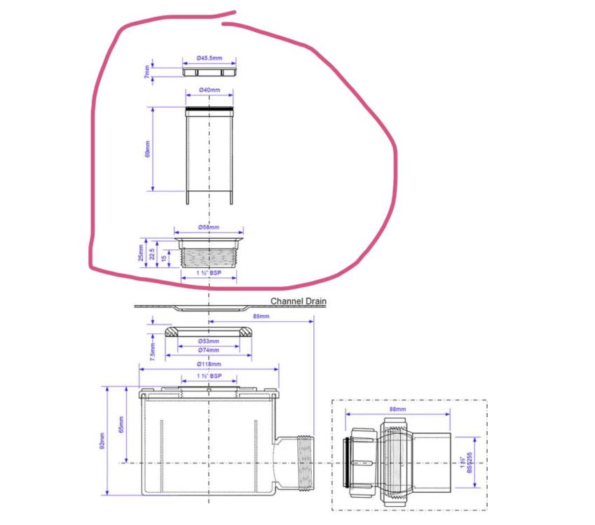

Adsibob Posted March 30, 2023 Posted March 30, 2023 We moved into our newly plumbed house in May. Some 4 -6 months in, I noticed that the shower wasn’t draining very quickly. It wasn’t flooding the wet room, it just didn’t seem to clear efficiently, which was odd, because the shower is on an external wall and on the other side of that wall, 3.5m down is our new sewer pipe taking water away to the sewer. It has progressively got worse and today a 12 min shower partly flooded the bathroom. Since I noticed the problem last year, I have been lifting up the tiled slot drain cover to inspect for anything that may be blocking it, and never found much, other than the occasional bit of SWMBO’s hair. However, today I noticed a black film of gunk all along the underside of the cover. Scraped it off into the bin. I suspect the same gunk has lined the pipes and narrowed them? Is that possible? The shower still drains fully, it’s just got progressively slower and has surprised me given we could have taken more than 500 showers there between us, and the plumbing was brand new! My pipes are plastic, so I’m nervous about using strong chemicals to clean it. But is this method, courtesy of Google, safe to do with plastic pipes? First, pour roughly a cup of baking soda down the drain (no exact measurement needed). After a few minutes, pour an equal amount of vinegar down. Leave the mixture sitting for at least an hour. Follow up with another round of boiling water, and see if the shower is draining faster.
Temp Posted March 30, 2023 Posted March 30, 2023 Perhaps try a good old fashioned plunger first. Run the shower to get the pipe full then plunge away. Use the plunger to push down and suck back the water. Surprising how much gunk can be sucked back into the tray with a plunger. The tricky bit us getting a good seal between plunger and tray. Sometimes a ring of dishcloth can help.
JohnMo Posted March 30, 2023 Posted March 30, 2023 I've tried many chemical and combinations in the past, plunger wins every time. Hair, dead skin and soap, will block anything.

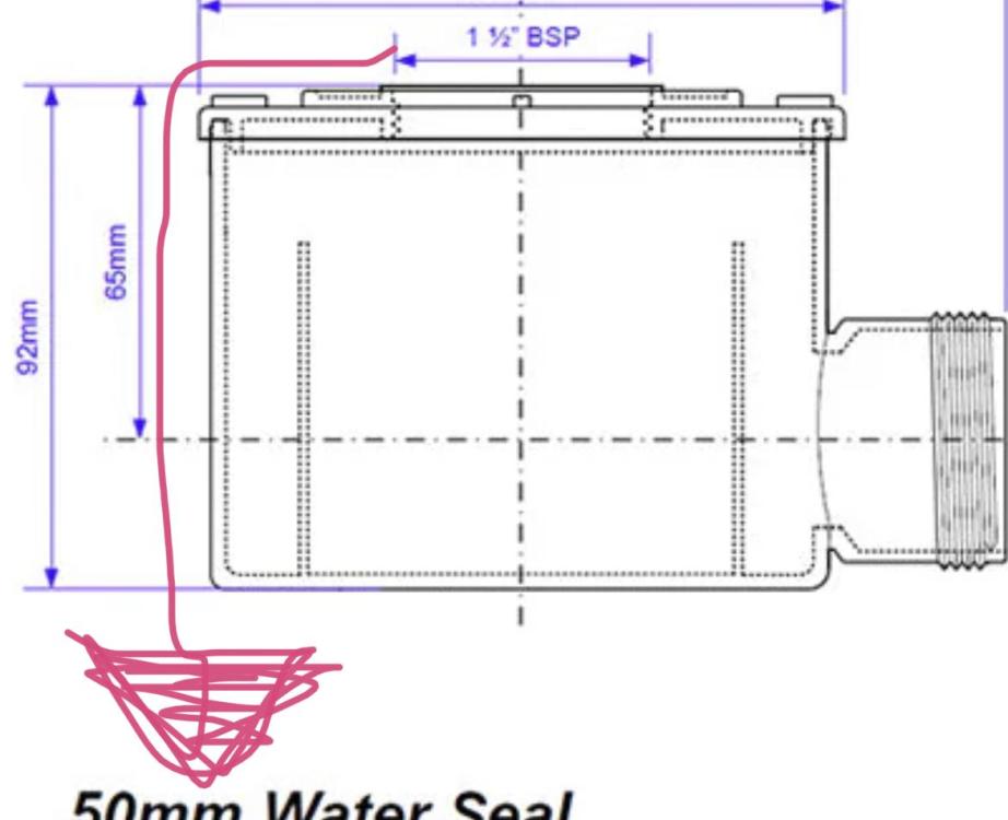

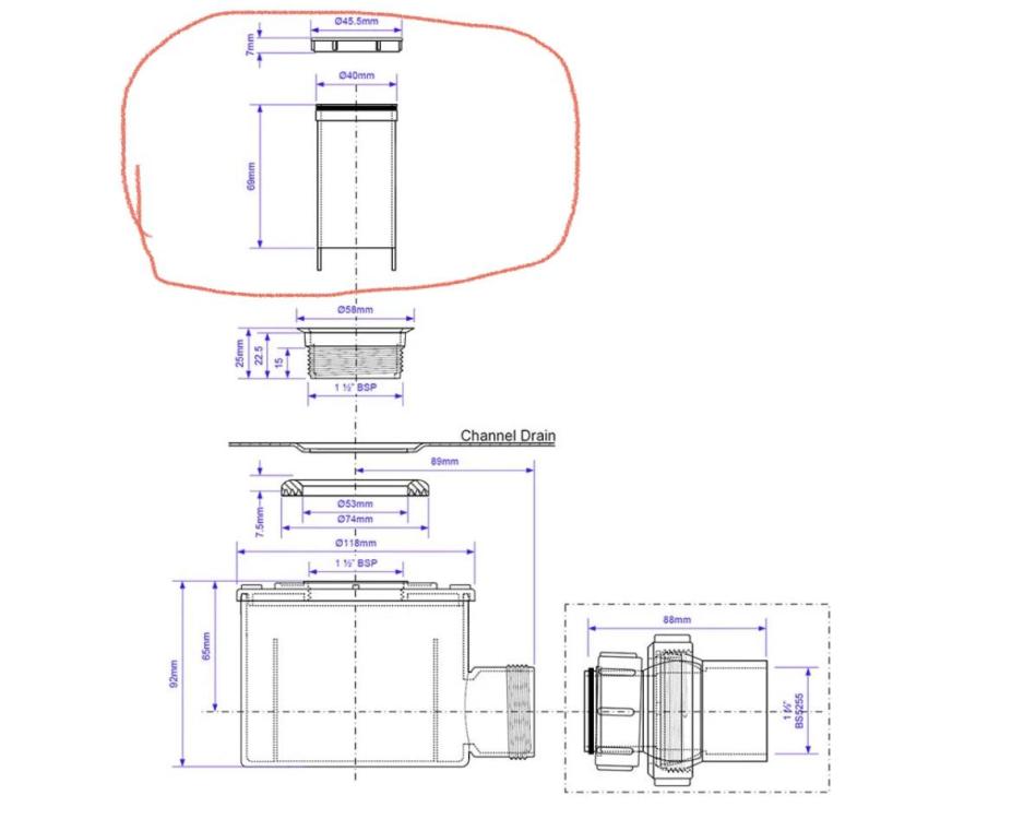

Crunchynut Posted March 30, 2023 Posted March 30, 2023 Did you just remove the grid over the outlet or did you then pull the trap out? In my experience gunk gets caught up on the exit of the trap, which you can’t necessarily get at by just removing the grid, depending on its design. Most shower traps allow you to pull the trap dip tube out and hence get at the problem area.
Adsibob Posted March 31, 2023 Author Posted March 31, 2023 4 hours ago, Crunchynut said: Did you just remove the grid over the outlet or did you then pull the trap out? In my experience gunk gets caught up on the exit of the trap, which you can’t necessarily get at by just removing the grid, depending on its design. Most shower traps allow you to pull the trap dip tube out and hence get at the problem area. i've tried removing the trap, but whilst it spins around it doesn't budge easily and I don't want to force it.
Adsibob Posted March 31, 2023 Author Posted March 31, 2023 5 hours ago, Temp said: Perhaps try a good old fashioned plunger first. Run the shower to get the pipe full then plunge away. Use the plunger to push down and suck back the water. Surprising how much gunk can be sucked back into the tray with a plunger. The tricky bit us getting a good seal between plunger and tray. The plunger technique is going to be very difficult because the trap is recessed within a channel that is covered by the tiled piece. 5 hours ago, Temp said: Sometimes a ring of dishcloth can help. I will give it a go. Need to buy a plunger first.

Crunchynut Posted March 31, 2023 Posted March 31, 2023 8 hours ago, Adsibob said: i've tried removing the trap, but whilst it spins around it doesn't budge easily and I don't want to force it. It’s probably just a push/pull fit, with an ‘o’ ring seal - a strong pull may do the trick. But I understand your nervousness.

markocosic Posted April 17, 2023 Posted April 17, 2023 Domestic shower drains can have hopelessly poor traps in my experience. Work out how to pull the trap and unbung the hairsoap from it. No chemicals required. Pipework will be clear downstream of trap.

Adsibob Posted April 18, 2023 Author Posted April 18, 2023 That’s an interesting idea. yes, this is all brand new plumbing, brand new everything in terms of water waste fittings and channels. What I find odd is that this shower is right up against the external wall that is immediately next to our pipe that connects to the sewer, so of all the wastes, it’s the one that shortest to travel. It must be the trap, as @markocosic says. I presume now that the slot drain has all been tiled into our shower wet room area, it’s far too late to change the trap? I guess I could attack it from underneath, though probably not worth it.
Marvin Posted April 18, 2023 Posted April 18, 2023 I think it will be the waste pipe from the shower trap to the external soil stack has not enough fall on it. Typically the ones I am asked to sort out have been put in with the pipe too level or going uphill, elbows rather than swept bends, and unsupported pipes that sag. If the trap is removable then plunging is a good start. M
Adsibob Posted April 18, 2023 Author Posted April 18, 2023 45 minutes ago, Marvin said: If the trap is removable then plunging is a good start As mentioned above, I can’t access the trap without cutting into the ceiling from underneath. Rather not do that.
markocosic Posted April 18, 2023 Posted April 18, 2023 Share a link / photo. The traps on these slot drains are usually removable from the top. This sort? https://www.youtube.com/watch?v=XL4XEZcmXWI It's usually a right pain to slide that grey part out and even more of a pain to slide it back in again. (tends to want to "pop out" again unless you get everything spotless) Ours has a strategically placed bottle cap wedged between the grey part and the wall of the drain to hold it into the pipe. If there's a second trap / alternative trap that's only accessible by cutting into the ceiling from underneath then that's a bit of an f-you move by the plumber. Cut in an access hatch as you'll be needing to de-wife / de-daughter that trap regularly. (short hair, pubes, soap etc sail though; it's long hair that twirls around itself then gets all kinds of non-rinsable conditioners and whatnot attached to it that really block these)
