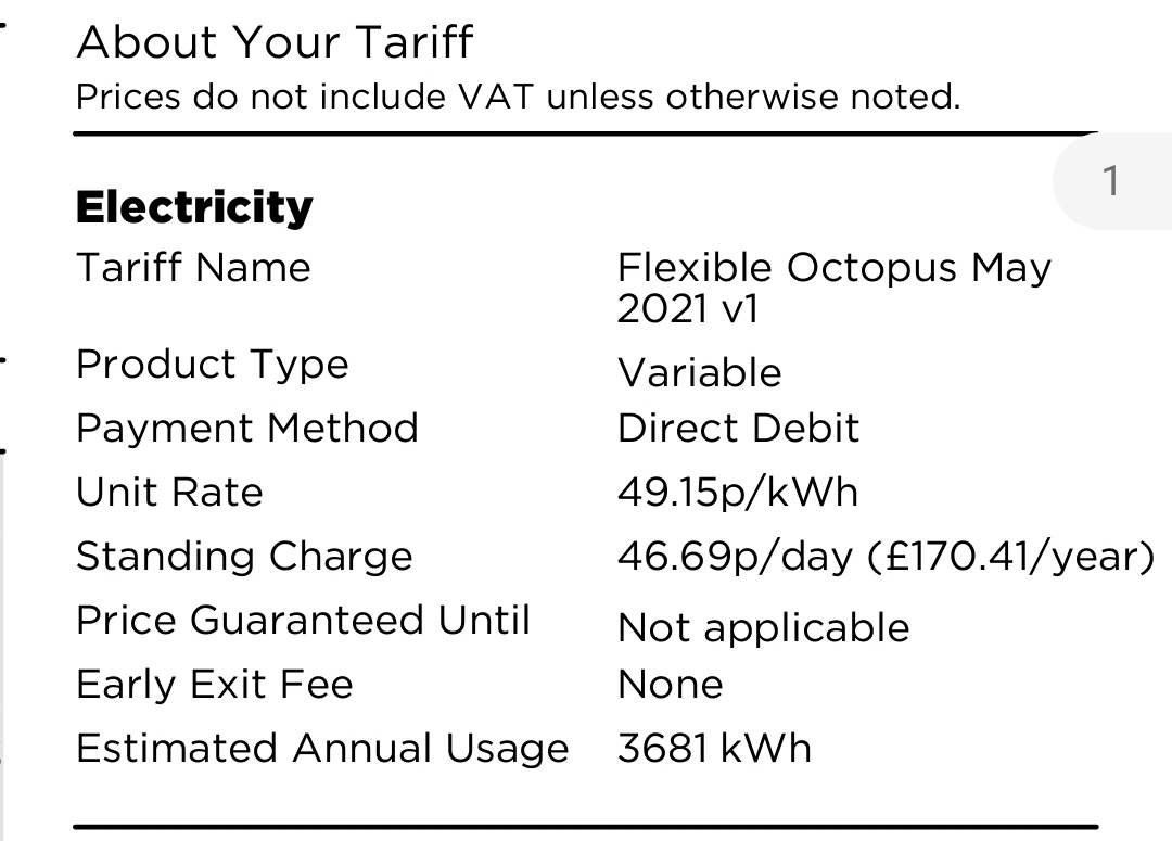

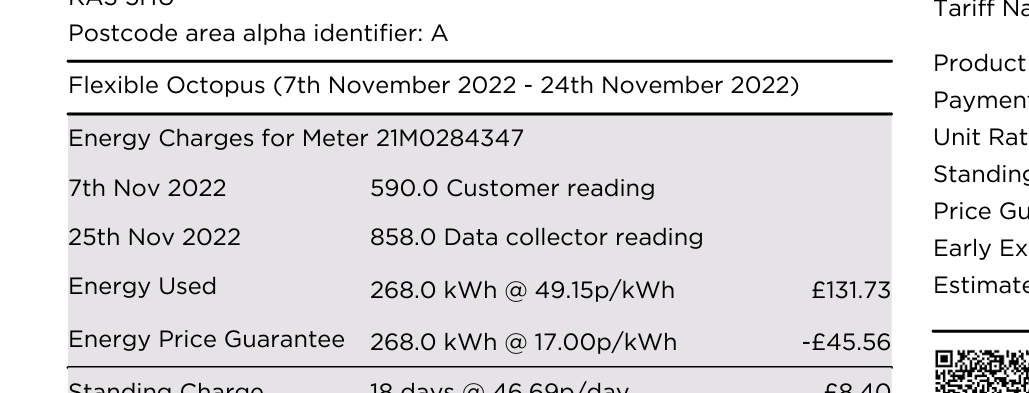

SuperJohnG Posted February 9, 2023 Posted February 9, 2023 (edited) @JohnMo @ProDave @Russdl @Nickfromwales @jack I thought you were talking just pure electricity costs. I was also forgetting about the cop, and solar gain...oops. It's not capped imo at 50p/kWh..the government is paying the gap between the 50p/kWh and the 34p and that will end at some point I think. I'm with Octopus standard variable at the moment I've attached my tariff at the moment. We have achieved 0.8 ACH at the mid build stage I hope to be even closer to 0.4 when they do the completion test. It's a SIPS house with 50mm added internally, no thermal bridges nearly and our roof is 270mm thick and walls 220mm thick. Edited February 9, 2023 by SuperJohnG Added image

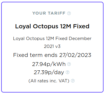

ProDave Posted February 9, 2023 Posted February 9, 2023 Why are you paying so much? commercial tariff? This ends in a couple of weeks, then I will be onto the capped rate of about 33p, no fixed rate deals on offer at the moment.
SuperJohnG Posted February 9, 2023 Posted February 9, 2023 (edited) On 09/02/2023 at 15:14, ProDave said: Why are you paying so much? commercial tariff? This ends in a couple of weeks, then I will be onto the capped rate of about 33p, no fixed rate deals on offer at the moment. Expand No this is the normal now. 50p/kWh and the government brings it back to 34p. Edited February 9, 2023 by SuperJohnG
ProDave Posted February 9, 2023 Posted February 9, 2023 Ah so you are not actually paying 50p, that is what confused me. 1
