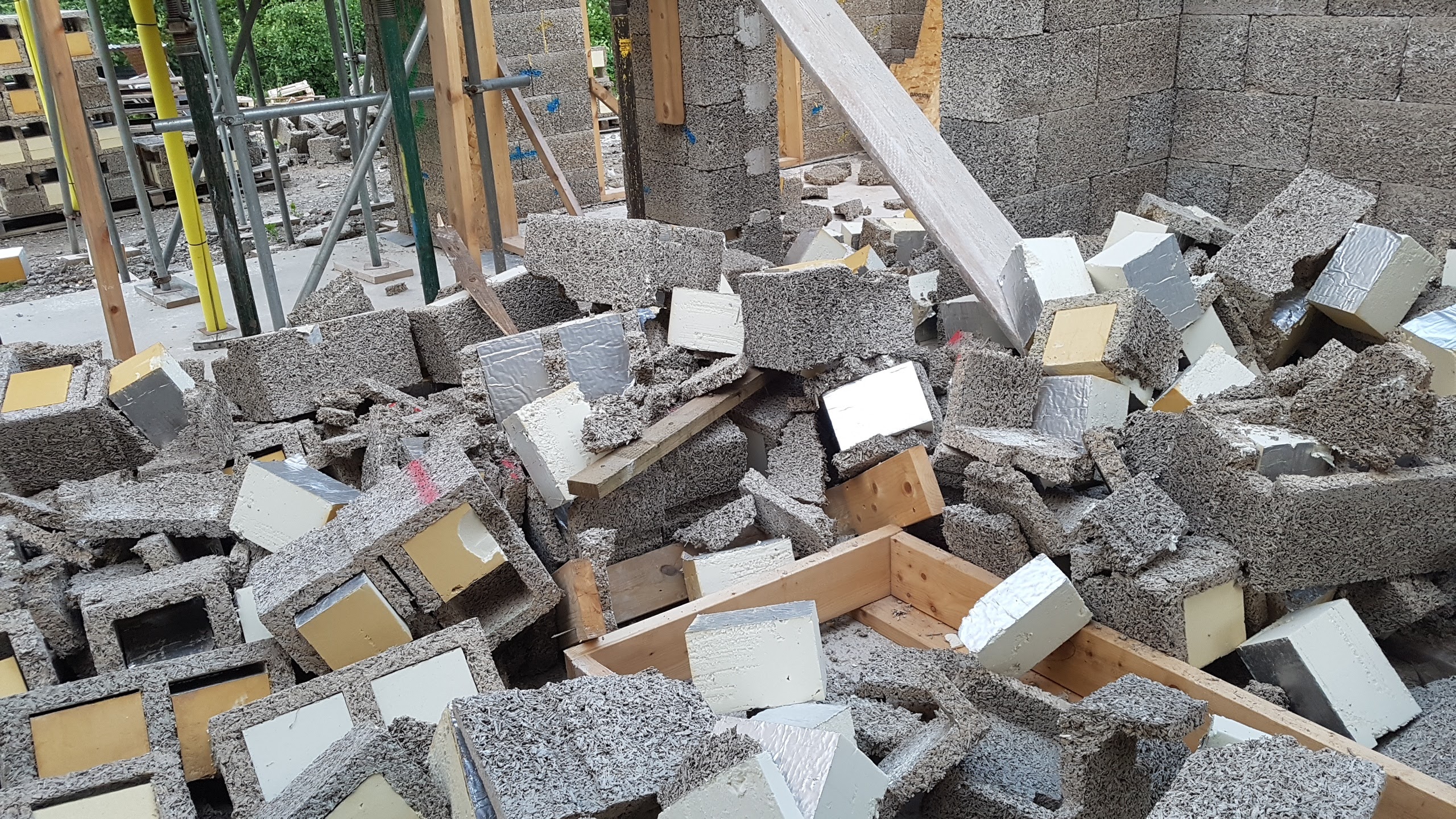

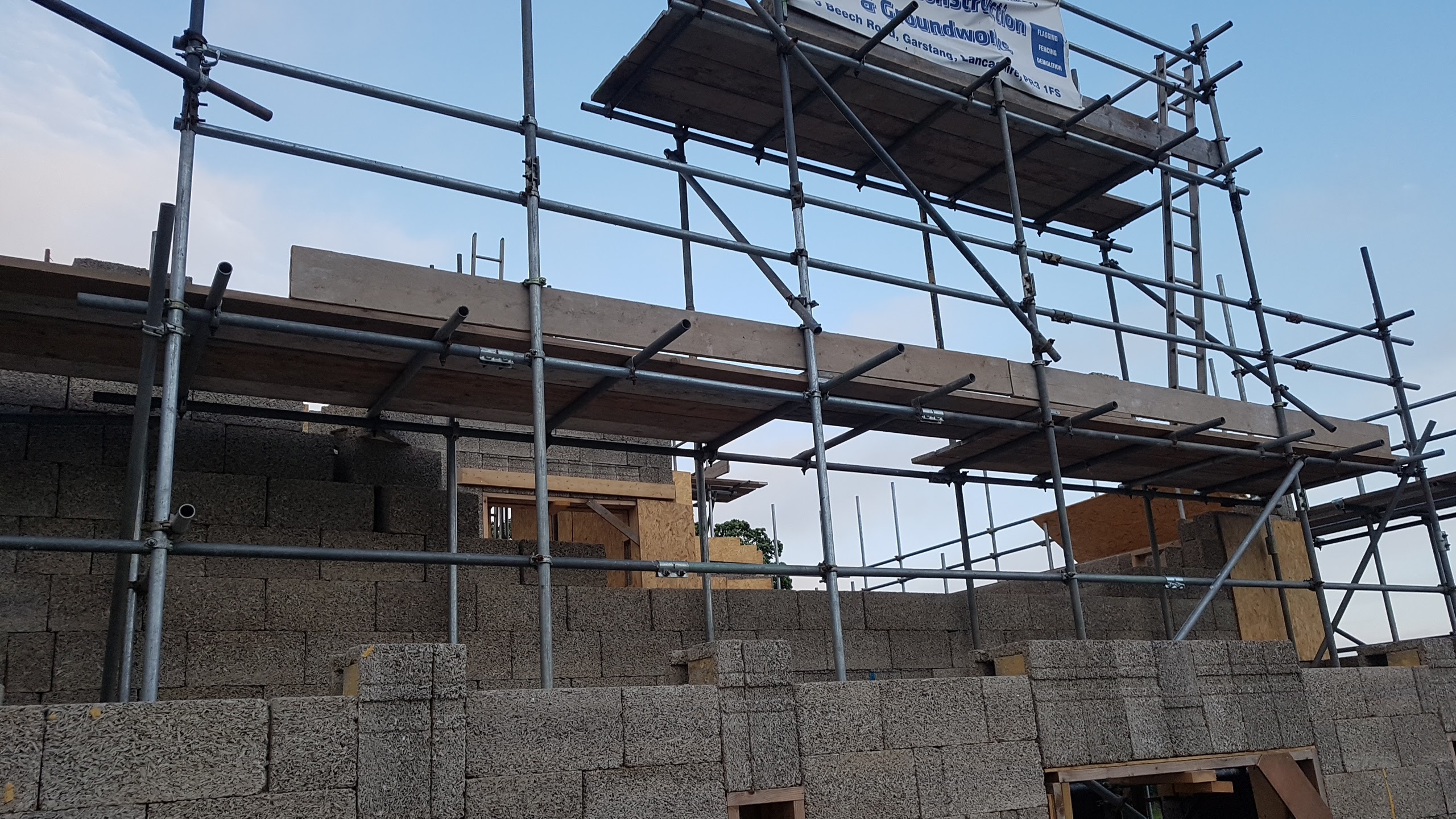

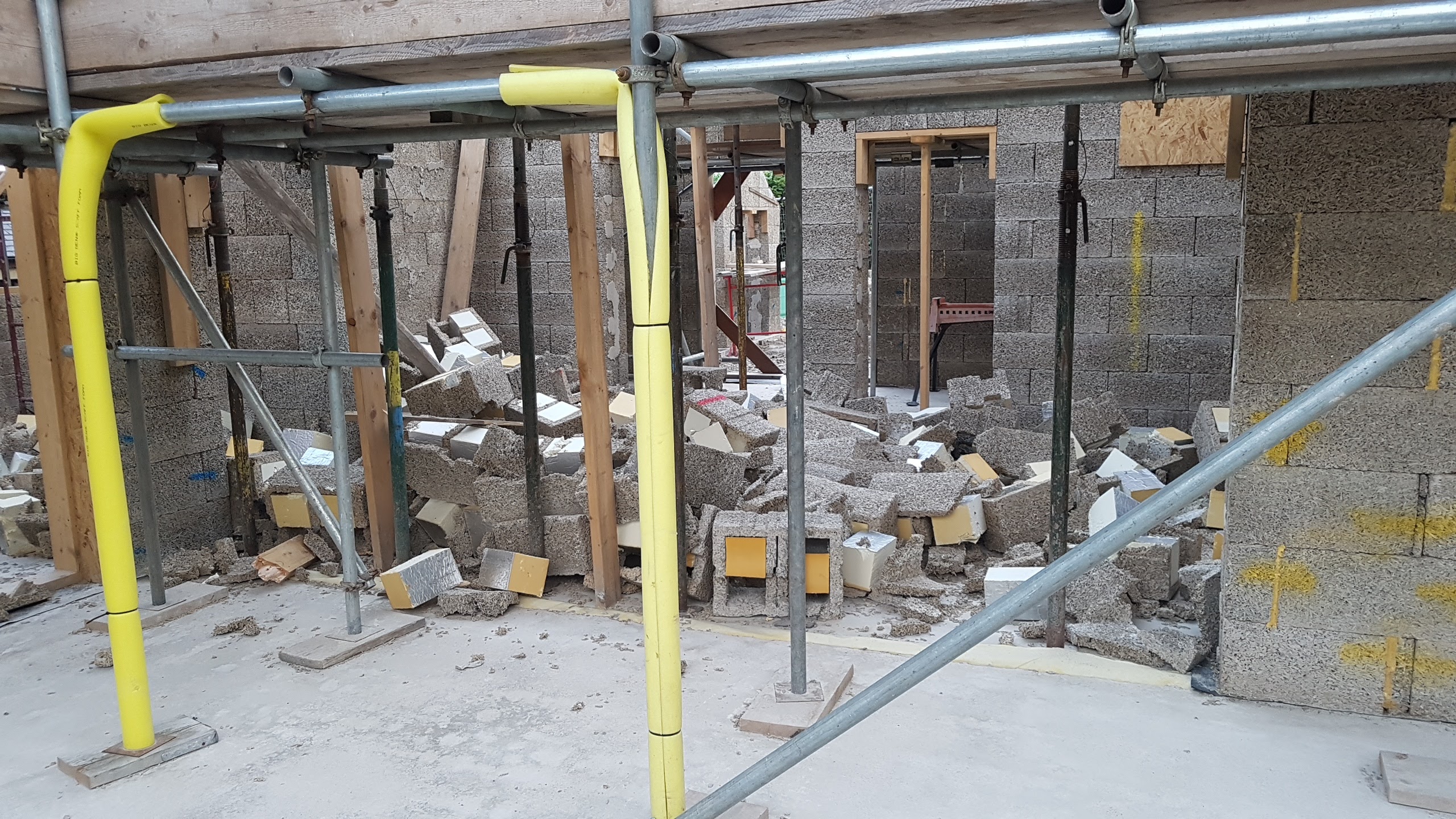

ToughButterCup Posted July 19, 2017 Author Share Posted July 19, 2017 Yes, nobody injured.... Trigger? It would be unwise to speculate in public. What's needed now is calm analysis, a plan to be formulated and then get on with it. There used to be a wall here.... and this is what it looks like from the inside I am so sick at heart. Really fed up. So much work and preparation and thought and care on our part. And I am working so hard at not being unkind. Or placing blame. All sorts of vacuous cliches bubble up in my sleep deprived head: when the going gets tough the tough get going, it'll be Ok, just you wait and see, we'll get over it, and other similar tripe. And sick, black humour - our architect specialises in disaster recovery of all things. This is going to hit us right in the bank balance. Better charge my phone; I'll be talking to a few people today, I expect. I would be really glad of some advice and insight into what to do next. And I want to keep it positive. I'm not up for criticism or inappropriate blame. I just want to get on with it safely and competently. Link to comment Share on other sites More sharing options...

Ian Posted July 19, 2017 Share Posted July 19, 2017 @recoveringacademic It looks like the Durisol blocks had been erected but not yet filled with concrete - is that correct? Link to comment Share on other sites More sharing options...
ToughButterCup Posted July 19, 2017 Author Share Posted July 19, 2017 Yes. Strong(ish) east wind: its the east face that has collapsed: to the level of the first pour. Link to comment Share on other sites More sharing options...
Ian Posted July 19, 2017 Share Posted July 19, 2017 1 minute ago, recoveringacademic said: Yes. Strong(ish) east wind: its the east face that has collapsed: to the level of the first pour. That's 'good' news then as it should be a really simple fix. Your builder should be able to sort this out very quickly and you'll be back on track in no time. The important thing will to find out why exactly it happened but from what you've said it sounds like it was simply that the builder erected too much free-standing durisol block and didn't prop it adequately against high winds. Don't let it get you down - it will seem like a disaster right now but I'm sure it's all fixable. Ian 1 Link to comment Share on other sites More sharing options...
