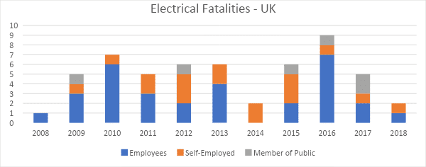

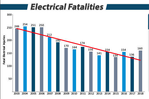

AliG Posted January 26, 2023 Posted January 26, 2023 UK workplace electrical deaths- USA So 5x the population and 30x the deaths at work. For total electrical deaths per year the UK averaged around 10-12 for the years 2012-17 https://www.ons.gov.uk/peoplepopulationandcommunity/birthsdeathsandmarriages/deaths/adhocs/009176numberofdeathswheretheunderlyingcausewasexposuretoelectriccurrentbysexandfiveyearagegroupengland2001to2017 France apparently averages around 40 and they have been complaining about people using hair dryers in bathrooms and apparently a new issue of using your phone in the bathroom while plugged into the charger. https://www.connexionfrance.com/article/French-news/French-consumer-agency-DGCCRF-warns-against-danger-of-bathroom-device-use-due-to-electric-shock The UK has very strict safety standards and seems to benefit. It is actually something we should be proud of. 1
