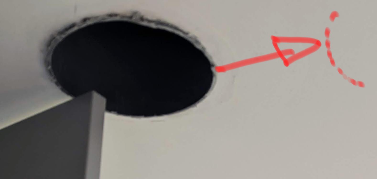

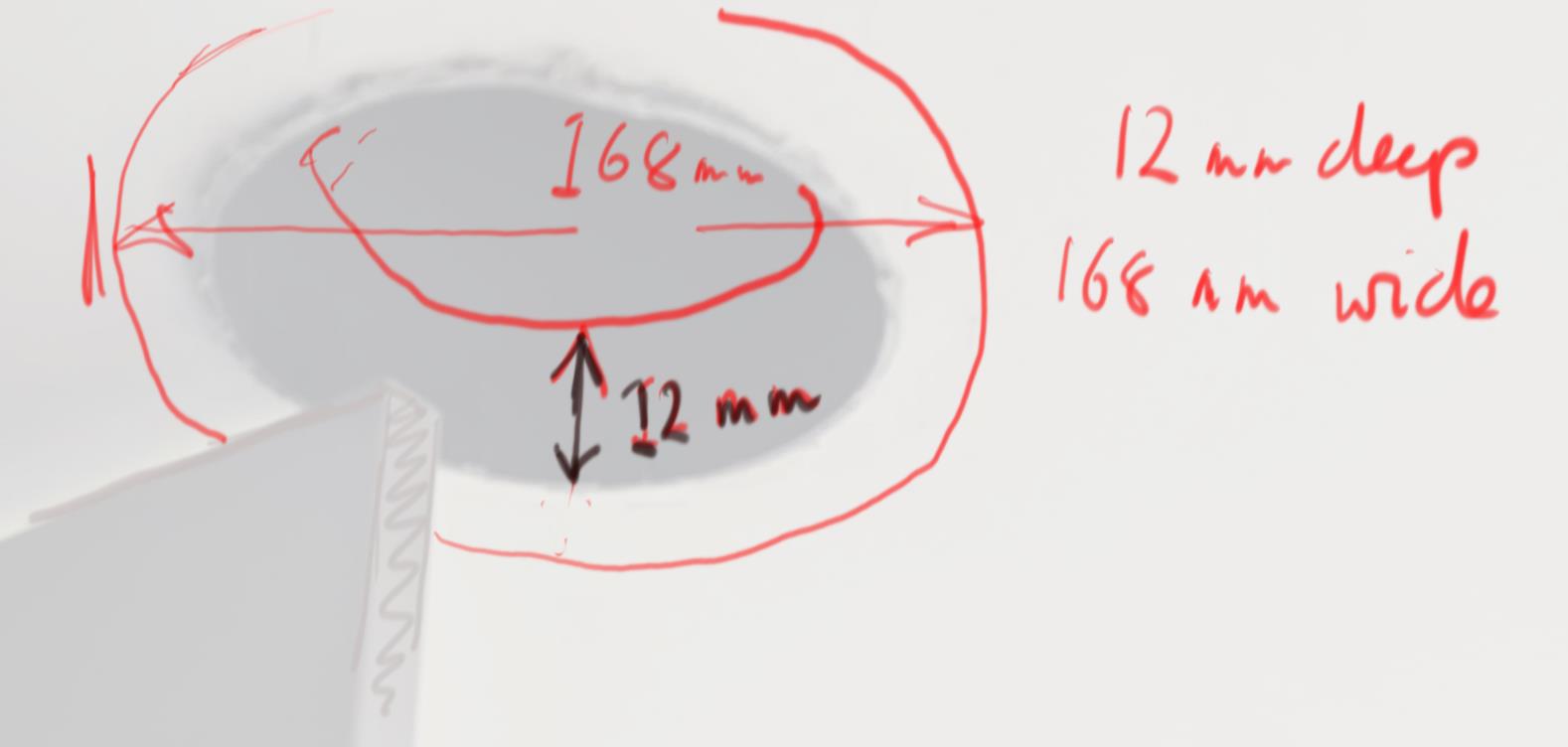

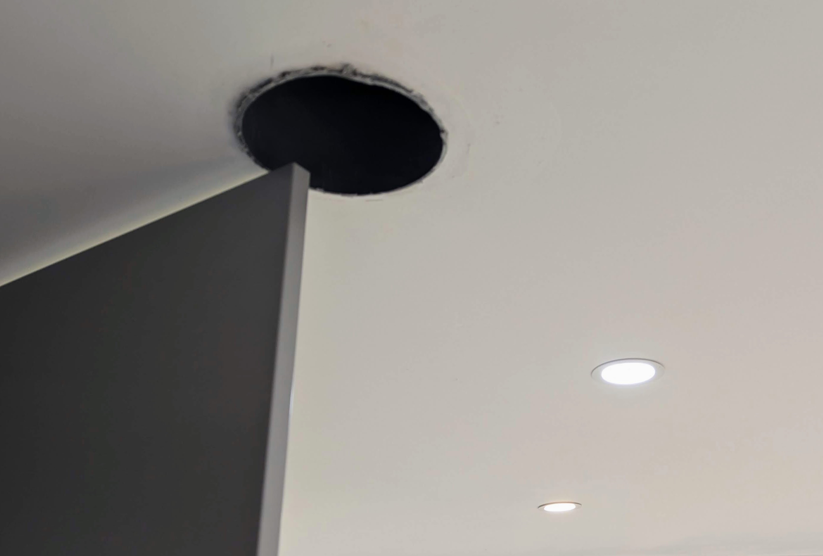

ToughButterCup Posted December 31, 2022 Posted December 31, 2022 Proper little head-slapper this one - have a look at this...... The valve assembly has been removed. It sticks out about 20mm below the ceiling. In the photo, there's about 10mm between the top of the fridge door and the ceiling. A mate popped round and when he stopped laughing, he suggested that it would be 'better' to sink the inlet into the ceiling by 12mm than Re-positioning the entire valve assembly about 500mm away from edge of the open door. (Like this) What he meant was 'You'll make a cock up of moving the whole thing easier than' ... doing this Cut the grey inlet pipe back by 12mm or so (Dremel with a cutting wheel) Cut the PB hole bigger (168mm o/a) so the 'flange' recesses into the ceiling If I do follow his idea, I'm wondering how on earth to make the cut edge of the PB look really neat - and perfectly circular. Worse, I'm wondering what I haven't thought of as a potential problem. Of course I could arrange to do the job when he comes round and make him own the follow-on problems...... Ideas? Warnings?
Thorfun Posted December 31, 2022 Posted December 31, 2022 only thing I can think of is being wary of the amount of ducting available to move it. I doubt there's any spare to pull it further so you'd have to move it along the length of the ducting. 1
Bonner Posted December 31, 2022 Posted December 31, 2022 Thought I had seen an air valve with a flat flange, 2mm or so thick … but can’t find it atm. Could you not trim your valve flange?
Russell griffiths Posted December 31, 2022 Posted December 31, 2022 (edited) Is it an illusion or is the black pipe protruding i trim them all flush to the plasterboard then a vent shouldn’t stick down more than 10-12mm. Edited December 31, 2022 by Russell griffiths 1
ProDave Posted December 31, 2022 Posted December 31, 2022 I have never seen a built in fridge door coming that close the the ceiling?
MikeSharp01 Posted December 31, 2022 Posted December 31, 2022 Recess the vent - much the most likely to work and simplest. 1
