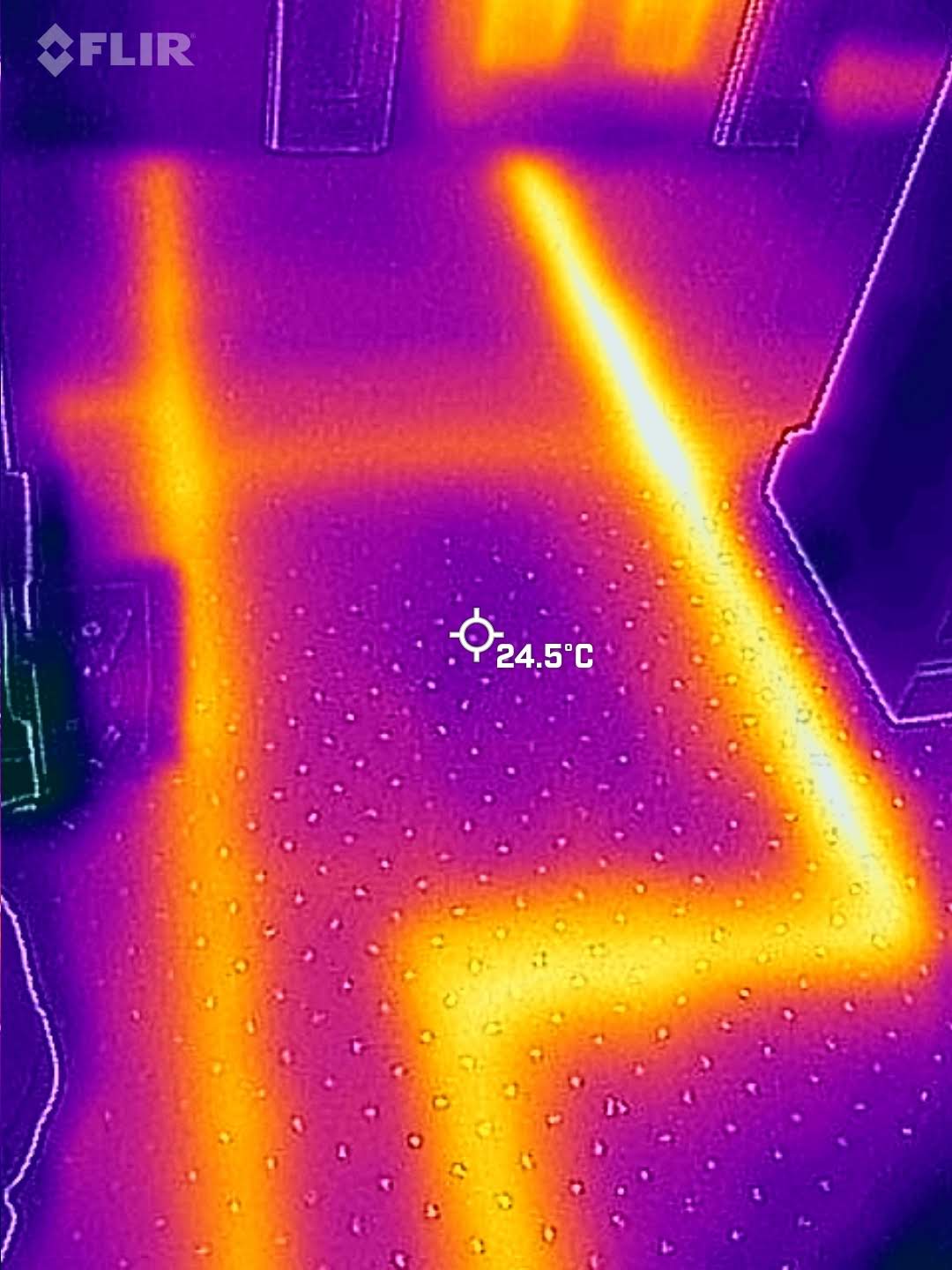

GrantMcscott Posted December 17, 2022 Posted December 17, 2022 Hi We are currently spending £40 a day on electricity with our ASHP and lighting etc but also spending £20 on wood and coal for heating. What is the best way to find the issues drafts and cold spots so i can fix them. The house still need rtedering and cladding done outside but windows and doors can not be sealed propperly Is a theremal imnaging camera the best way to go if so what is the most economical one to buy or rent Any advice would be great to reduce running costs

Radian Posted December 17, 2022 Posted December 17, 2022 32 minutes ago, GrantMcscott said: Is a theremal imnaging camera the best way to go if so what is the most economical one to buy or rent Flir One for Android smartphones for £221 is the lowest cost thermal imager I know of. If you get one you'll find it incredibly handy for all sorts of things. I've been mapping out the location of my CH pipes as well as finding air leaks: 4
