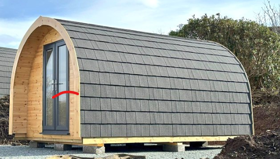

Hi I am looking to built a Pod from scratch gothic arch and was wondering were the metal tiles meet the barge board / facia if there is a flashing or not. Or it does not mater due to the overhang being out side?

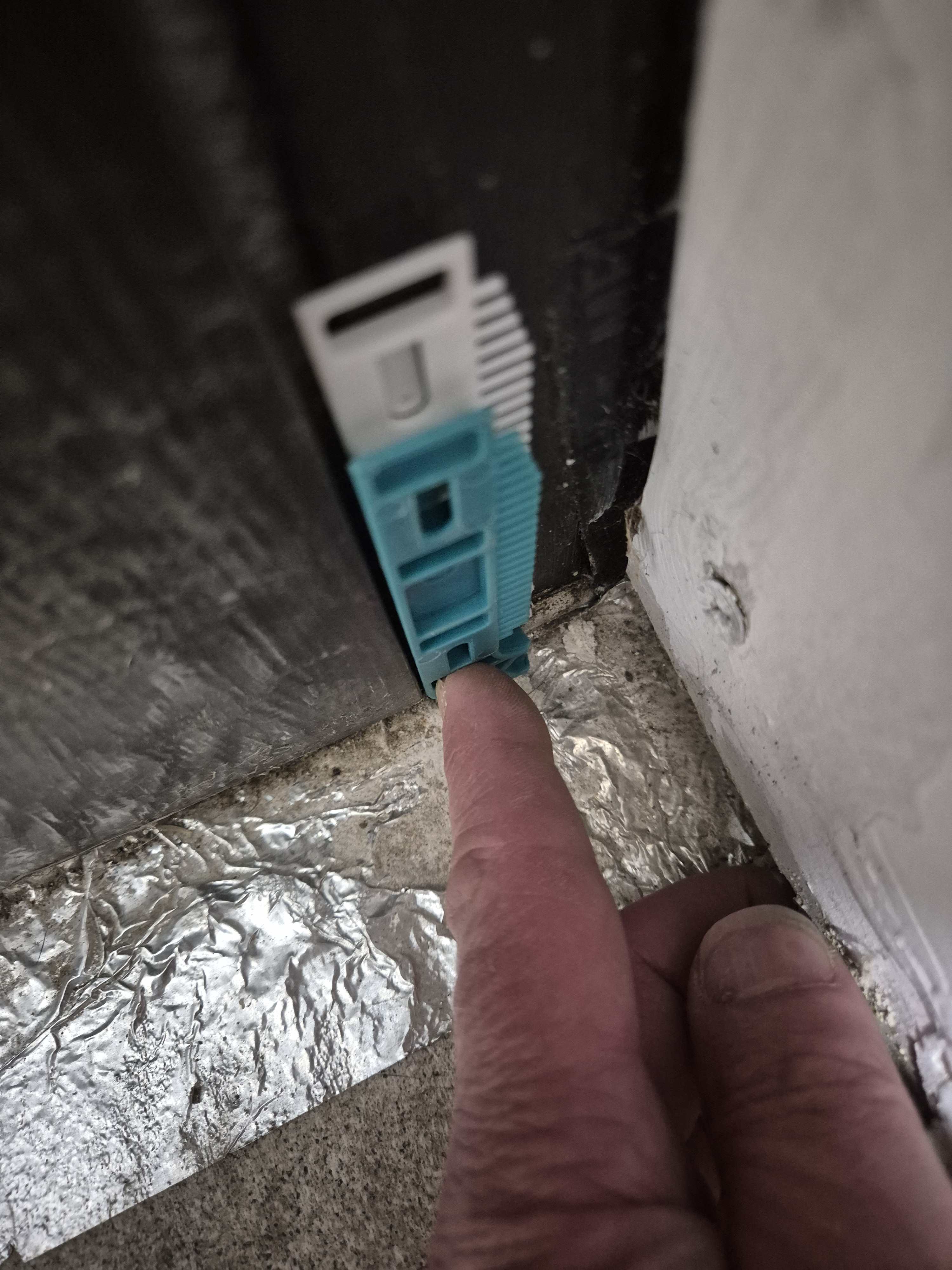

Hi i have a composite front door that has been working fine but now the bottom is not flush with frame and need to kick the bottom to lock it. Even with keeps full adjusted it doese not make a difference. It is out by 8mm and flush to the frame at the top.

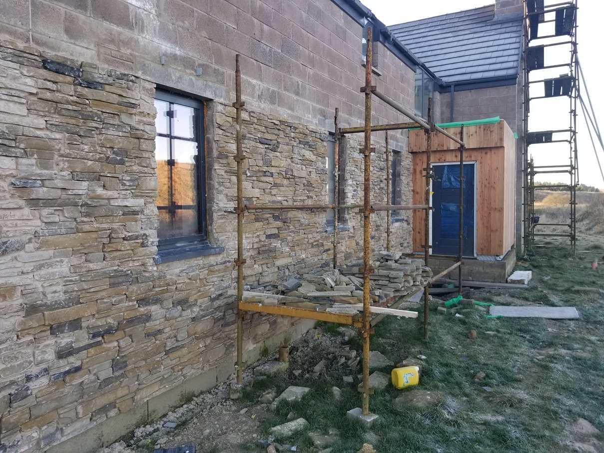

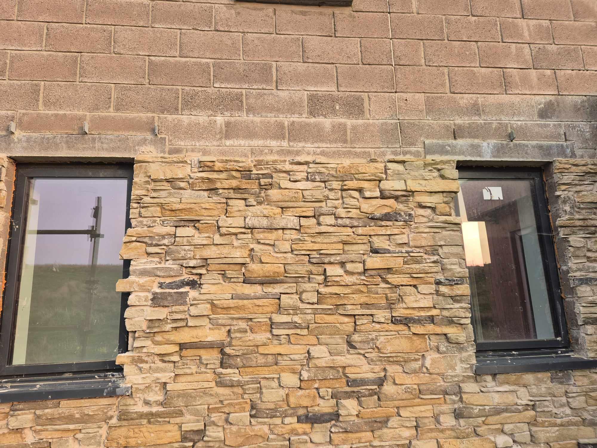

Hi part of my build has stone cladding onto block work and render above. The stone cladding has been badly fitted and I am thinking about putting timber cladding over it. My plan is to cut channels out of the stone cladding to fix wood battens to the wall and then fix the wood cladding to them with no cavity. not 100% sure if the building inspector would find this acceptable and also it would cover up the weep vents for the timber kit. Or is it best to finish the stone cladding and after sign off decide how to fix the issue? Is there any other option I could do other than chipping it off?

Recommendations for top of Stone cladding
GrantMcscott replied to GrantMcscott's topic in General Self Build & DIY Discussion
go above it to throw the water away from the wall and from seeping behind the cladding (like a flashing), -
