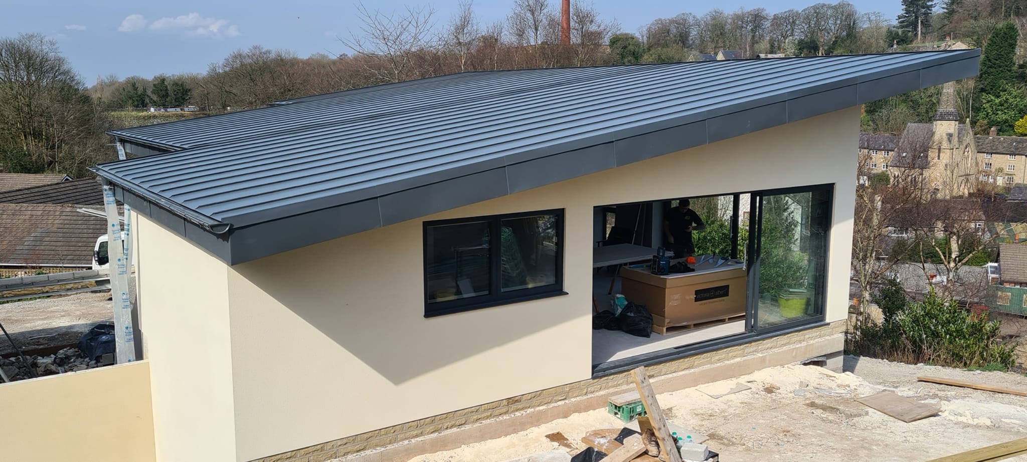

Kelvin Posted December 13, 2022 Posted December 13, 2022 (edited) Architects love zinc. They must be trading in it. I started with zinc but we are now fitting a Catnic Urban metal standing seam roof. I got a quote for Greencoat but it was much dearer than Catnic. Can you not getting a change of material? Most of our warrant says blah blah material or equivalent. Edited December 13, 2022 by Kelvin 1

Bonner Posted December 14, 2022 Posted December 14, 2022 9 hours ago, Kelvin said: started with zinc but we are now fitting a Catnic Urban metal standing seam roof This makes most sense, should be a minor amendment. Looks similar and no architectural or structural changes necessary.

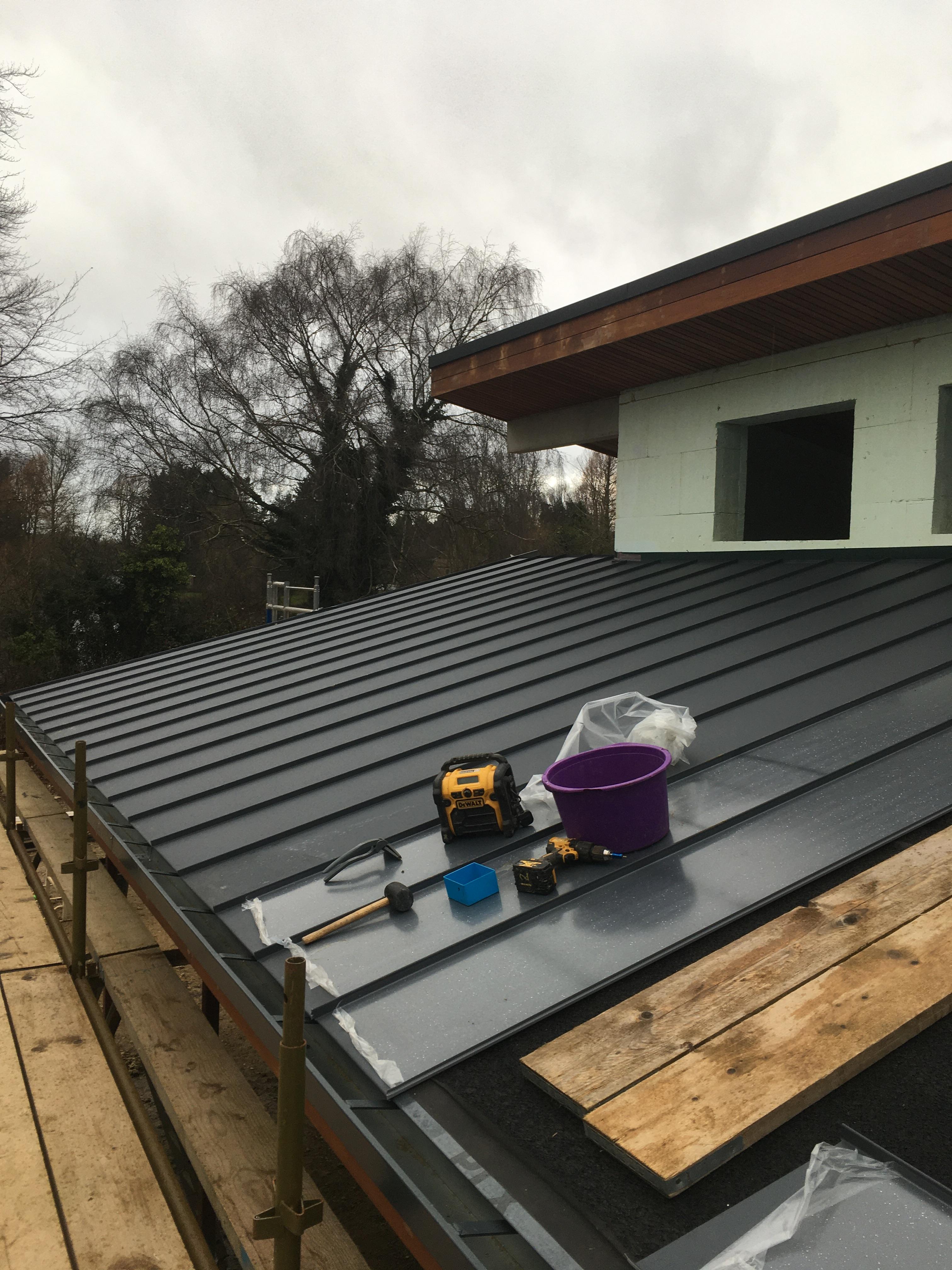

Happy Valley Posted December 14, 2022 Posted December 14, 2022 We went down the Greencoat route which was a lot cheaper than zinc. Costs more than a traditional roof but has a 50 year guarantee which should at last me!

HughF Posted December 14, 2022 Posted December 14, 2022 I've used the blachotrapez system that I bought from @Patrick of Pagurek UK - an excellent system, really nice to work with.
saveasteading Posted December 14, 2022 Posted December 14, 2022 I agree with Iceverge. I have done many a roof in sensitive locations, using steel, either grey coated, or aluzinc, and the planners have been happy that it looked like traditional zinc. The magic words were 'wide pan, low profile'. I.e. Not crinkly. I never used standing seam either because of the cost, and being difficult at joints and junctions. The screws are visible but a minor thing. Also, if ever damaged, standing seam requires specialist repair, wich simply won't happen, and it gets patched up. Does your design brief cover economical design? That would concentrate your architect's mind on getting this changed. Beware of him being prescious of the zinc, and not being very convincing with the plannners....I have had that and taken the discussion on myself. Don't tell the planner it is about cost though. Sustainability....less material, easier maintenance and repair, longer life...whatever. 2

Tosh Posted December 14, 2022 Posted December 14, 2022 We changed ours from zinc to plx. I challenge anyone to tell the difference unless its right in your face. If the colour and profile remain the same then who would know the difference, a planner? However if you were keen to keep them informed then I would think a non-material ammendment would be your best option. 1
