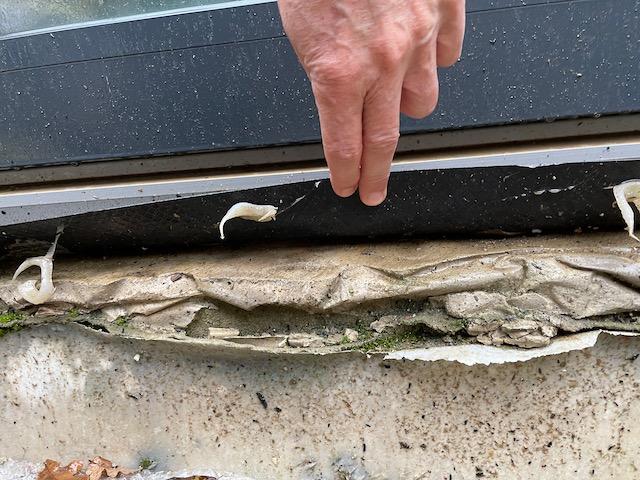

Thorfun Posted November 21, 2022 Author Posted November 21, 2022 thinking about my flooding issue some more and i believe it's obvious that the water got in to the basement from underneath the sliding doors. there's silicone between the door and the dpc but there's obviously a gap between the concrete base and the dpc that allowed water in from the outside. how could i best seal this gap? concrete? silicone? a.n.other method? the opening is approx just over 2m wide. just thinking that if this did ever happen again then if i can stop the water entering the basement the courtyard will fill up but the basement won't!
Pocster Posted November 21, 2022 Posted November 21, 2022 (edited) 44 minutes ago, Thorfun said: thinking about my flooding issue some more and i believe it's obvious that the water got in to the basement from underneath the sliding doors. there's silicone between the door and the dpc but there's obviously a gap between the concrete base and the dpc that allowed water in from the outside. how could i best seal this gap? concrete? silicone? a.n.other method? the opening is approx just over 2m wide. just thinking that if this did ever happen again then if i can stop the water entering the basement the courtyard will fill up but the basement won't! If it’s an awkward ‘gap’ then I would say expanding foam . Is there not a drain / channel outside infront the doors ? - that is what you really need that feeds into your sump . add: photo of your doors / courtyard from outside might help Edited November 21, 2022 by pocster
Thorfun Posted November 21, 2022 Author Posted November 21, 2022 13 minutes ago, pocster said: If it’s an awkward ‘gap’ then I would say expanding foam . Is there not a drain / channel outside infront the doors ? - that is what you really need that feeds into your sump . add: photo of your doors / courtyard from outside might help there will eventually be some form of drainage channel. i'm thinking short term for now just in case! i'll get a photo once it's stopped raining 1

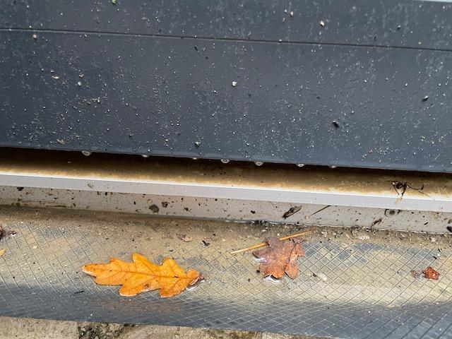

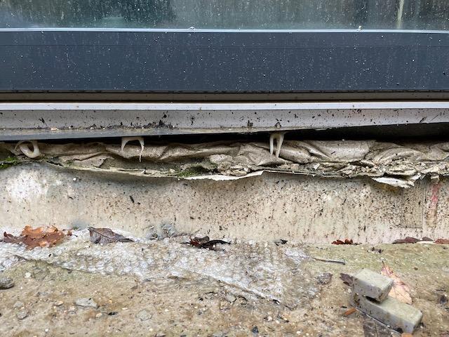

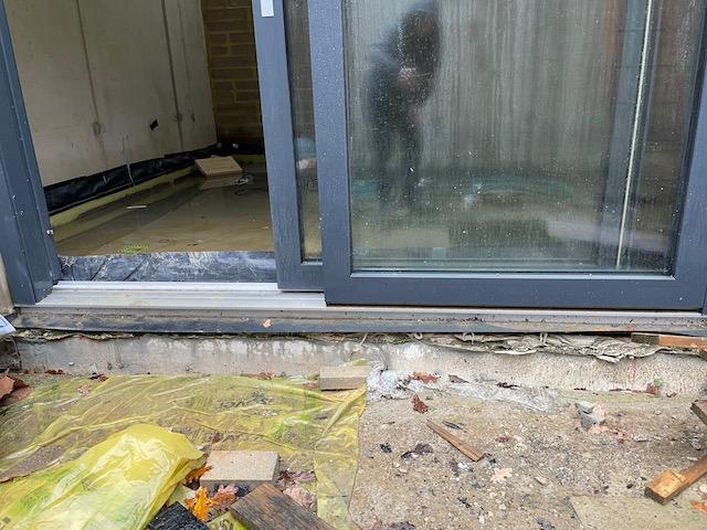

Thorfun Posted November 21, 2022 Author Posted November 21, 2022 so, not the best photos but I was getting wet. I have a step down to the courtyard as well. you can see in this photo how deep the water was internally! so despite also having a large area to 'store' water in the courtyard it was excessive. I believe the water came in under the DPC. at least I can't really think of any other real way it did. although there is a duct from the courtyard to the comms room where I guess water could've come in from as well. I'll also need to seal that up once the power cables have been put through. in the photo below you can see the line of silicone between the sliders and the dpc so I think this should be ok. I'm sure it's under the DPC that let the water in. although, with the quantities we're talking about that was in the basement it must've been coming in for quite a while. I started a new job last Monday so hadn't been in to the house since the previous Sunday and with all the rain we had I think it was a slow flooding event over the course of a number of days. it's so sad when I think that if I'd only popped out I might've noticed that the I couldn't hear the water going in to the sump which would've triggered some alarm bells. but, it's happened now. just got to get on with it all. 1
Pocster Posted November 21, 2022 Posted November 21, 2022 1 hour ago, Thorfun said: so, not the best photos but I was getting wet. I have a step down to the courtyard as well. you can see in this photo how deep the water was internally! so despite also having a large area to 'store' water in the courtyard it was excessive. I believe the water came in under the DPC. at least I can't really think of any other real way it did. although there is a duct from the courtyard to the comms room where I guess water could've come in from as well. I'll also need to seal that up once the power cables have been put through. in the photo below you can see the line of silicone between the sliders and the dpc so I think this should be ok. I'm sure it's under the DPC that let the water in. although, with the quantities we're talking about that was in the basement it must've been coming in for quite a while. I started a new job last Monday so hadn't been in to the house since the previous Sunday and with all the rain we had I think it was a slow flooding event over the course of a number of days. it's so sad when I think that if I'd only popped out I might've noticed that the I couldn't hear the water going in to the sump which would've triggered some alarm bells. but, it's happened now. just got to get on with it all. Crumbs you were unlucky . Yes a decent channel and also a decent water ‘storage ‘ facility ! . Still think expanding foam is best under there to seal it properly. That doesn’t mean of course water couldn’t get under the dpc if it flooded again though . Get those 2/3 pumps in and some method of high water / pump failure alarm in pronto !
ProDave Posted November 21, 2022 Posted November 21, 2022 Trying to seal under the door is a futile exercise. Just like people sand bagging the front door. No house it totally water tight as in swimming pool water tight. All you will do is slow down, not stop, the rate of water entering the house. 1 1
Thorfun Posted November 21, 2022 Author Posted November 21, 2022 27 minutes ago, ProDave said: Trying to seal under the door is a futile exercise. Just like people sand bagging the front door. No house it totally water tight as in swimming pool water tight. All you will do is slow down, not stop, the rate of water entering the house. this is a shame as that's waterproof concrete so it's just that small slit beneath the DPC that allowed the water in (i think!). if i didn't have that door then the basement would be swimming pool water tight. i'm sure this won't happen again but i was hoping that maybe i might find a way to reduce the ingress substantially. i might try a bit of expanding foam. i might put a couple of tubes of CT1 under there as well! surely it can't hurt?

Pocster Posted November 21, 2022 Posted November 21, 2022 8 minutes ago, Thorfun said: might try a bit of expanding foam. i might put a couple of tubes of CT1 under there as well! surely it can't hurt? Unless you can see right under there it will be tricky to fill with ct1 . Expanding foam is best . As said ; won’t stop water entering ( in a flood situation ) but will stall / slow it down . 👍 1
Pocster Posted November 21, 2022 Posted November 21, 2022 10 minutes ago, pocster said: Unless you can see right under there it will be tricky to fill with ct1 . Expanding foam is best . As said ; won’t stop water entering ( in a flood situation ) but will stall / slow it down . 👍 Perhaps when it’s dark stick a torch outside so you can see the light coming under the dpc . Foam along until no light visible . You’ve then done the best as possible .
