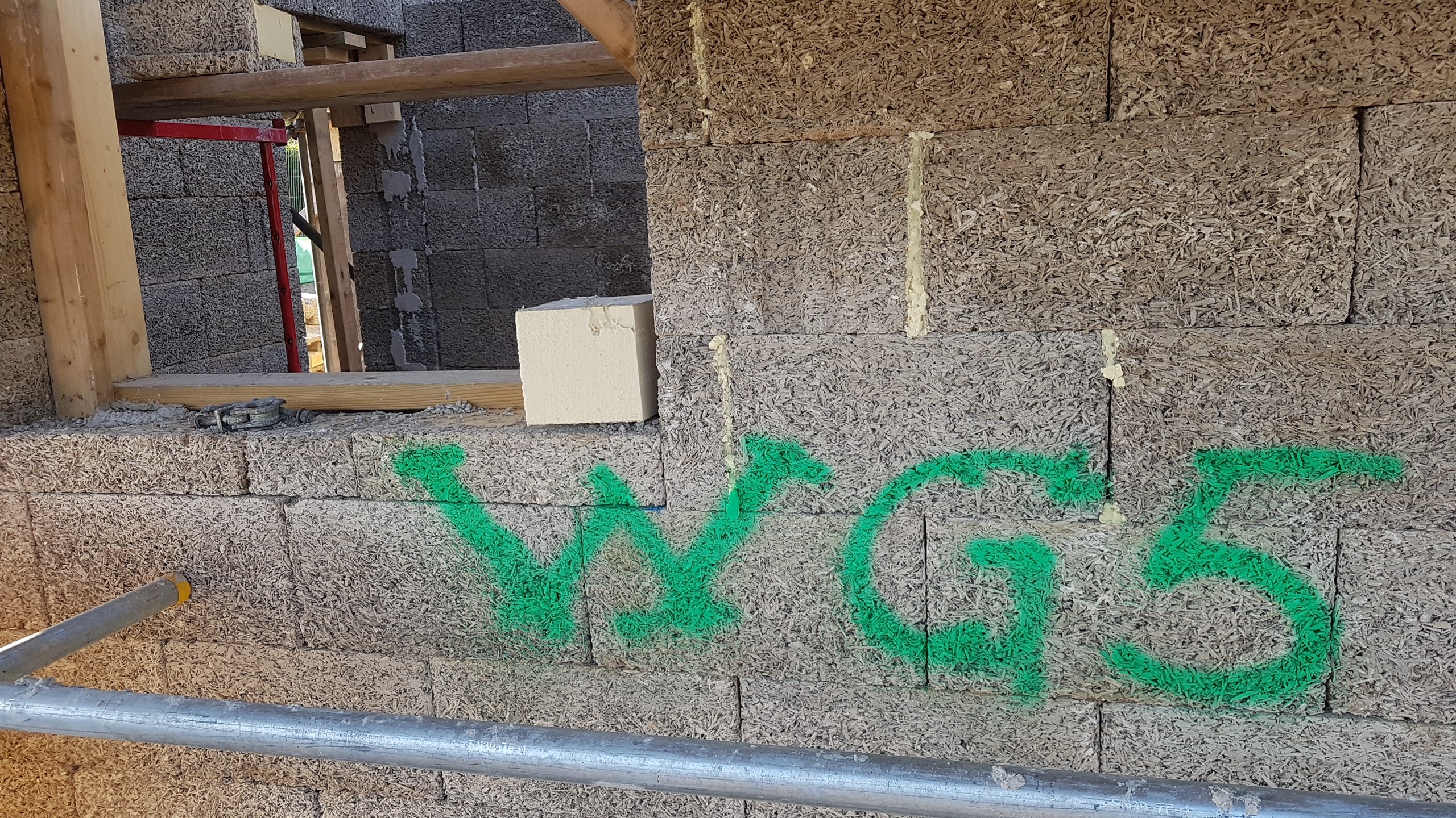

ToughButterCup Posted June 20, 2017 Posted June 20, 2017 Our windows order is important partly because of the value of the order. And so the scrutiny of detail, intense. The whole process of creating an accurate order has been made so much more difficult because of the lack of attention to detail on the part of some involved in the administrative process. Notably not in the case of our supplier. Austrian company - nuff said. I am keen to reduce the sources of error, and, among other things I have decided to spray the window designation on each structural opening. With any luck when the company comes to fit the windows, the fitters won't have to ask which window goes where...... Which simple site-based practical strategies have you used to reduce the potential for error? I'm not thinking about high level stuff like Prince2. Just nuts and bolts practical stuff.
Barney12 Posted June 20, 2017 Posted June 20, 2017 You've completely outdone me. I used a Sharpie marker:-) I also added all the dimensions, FFL detail etc so that MBC were absolutely certain what they were doing (as the upper floor openings were made wrong in the factory). Our windows arrived on a lorry 20 minutes ago! 1
bassanclan Posted June 20, 2017 Posted June 20, 2017 I chalked it on, but there's no substitute for being there walking round making sure everything is happening as you expect it to 1

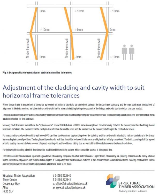

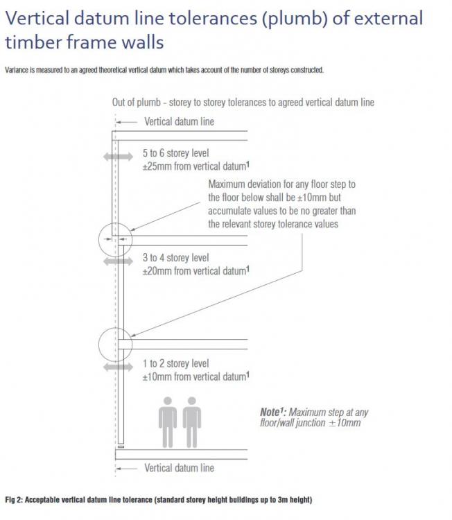

Brickie Posted June 20, 2017 Posted June 20, 2017 Heard of a great method for setting out brickwork on tf- drop a plumb line from the eaves at each corner and measure off at the frame at each floor level. This will give precisely give you your dim from frame to front of wall & allow you to correct yourself as you come up if you're wondering off plumb by a mil or 2.
