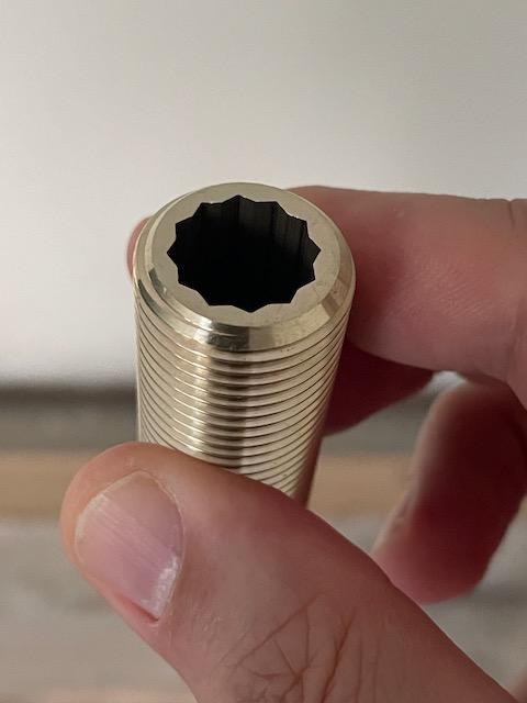

Thorfun Posted October 9, 2023 Author Posted October 9, 2023 10 hours ago, joe90 said: and is it a flat end or tapered you connect the pipe too 🤷♂️ looks tapered to me
markc Posted October 9, 2023 Posted October 9, 2023 That’s would be classed as flat face, the seal should be on the end, not the thread chamfer

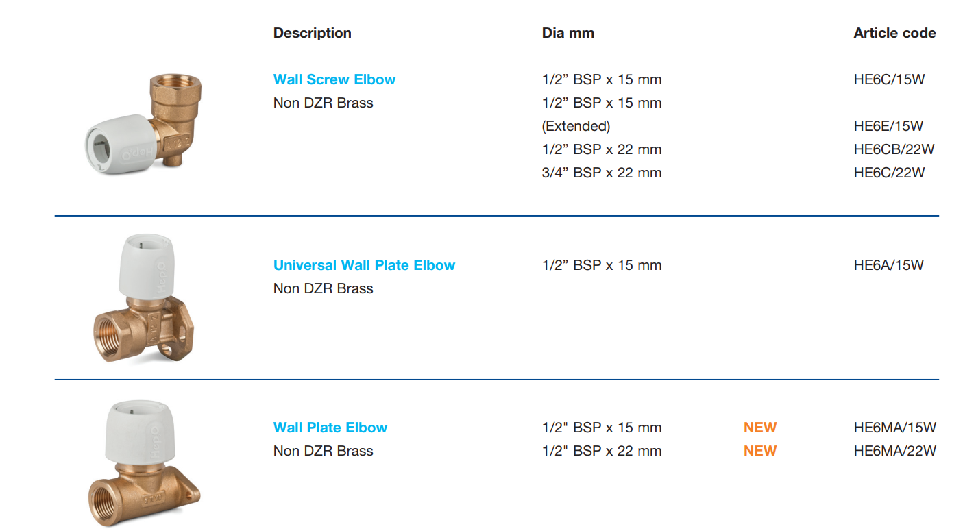

crispy_wafer Posted October 9, 2023 Posted October 9, 2023 8 hours ago, Thorfun said: Seems like the Hep2o version is plastic. https://www.screwfix.com/p/hep2o-plastic-push-fit-adapting-90-wall-plate-elbow-15mm-x-1-2-/2279f?ref=SFAppShare seems pretty strange that. Pretty sure they used to do a brass version, as I was looking the other week. I'm not sure I have too much confidence in anything that has plastic threads. As much as we don't want too many hidden connections I think I'll do the same and convert to copper. 1
Thorfun Posted October 9, 2023 Author Posted October 9, 2023 1 hour ago, crispy_wafer said: Pretty sure they used to do a brass version, as I was looking the other week. I'm not sure I have too much confidence in anything that has plastic threads. As much as we don't want too many hidden connections I think I'll do the same and convert to copper. i wonder if something like this is the ticket? https://www.wickes.co.uk/Primaflow-Copper-Pushfit-Wall-Plate-Elbow---1-2in-X-15mm/p/194595 can put a length of copper pipe joining the hep2o to this with no compression or solder.
Thorfun Posted October 9, 2023 Author Posted October 9, 2023 1 hour ago, markc said: That’s would be classed as flat face, the seal should be on the end, not the thread chamfer think i'm going to have to do a lot more research on the difference between flat and tapered as i'm confused and can't tell the difference. 1

joe90 Posted October 9, 2023 Posted October 9, 2023 7 hours ago, Thorfun said: looks tapered to me No it’s tapered the wrong way, it should be tapered inside not outside 1
Thorfun Posted October 9, 2023 Author Posted October 9, 2023 7 minutes ago, joe90 said: No it’s tapered the wrong way, it should be tapered inside not outside ok. so if fitting in to one of those 1/2" wall-plate elbows I would need a rubber washer in there? I'll have to see if one comes with the fitting.

Thorfun Posted October 9, 2023 Author Posted October 9, 2023 (edited) @Nickfromwales have you used these plastic bibs from hep2o? https://www.cityplumbing.co.uk/p/hep2o-wall-plate-elbow-black-15mm-x-12-inch-pushfit-hx615w/p/616913 I always thought that screwing brass into plastic was a recipe for disaster? it makes me wonder if these are 'special' plastics for Wavin to move to plastic over brass? I presume Wavin must be pretty confident in the product to still give it a 50 year guarantee Edited October 9, 2023 by Thorfun 50 yr guarantee
Pocster Posted October 9, 2023 Posted October 9, 2023 7 minutes ago, Thorfun said: @Nickfromwales have you used these plastic bibs from hep2o? https://www.cityplumbing.co.uk/p/hep2o-wall-plate-elbow-black-15mm-x-12-inch-pushfit-hx615w/p/616913 I always thought that screwing brass into plastic was a recipe for disaster? it makes me wonder if these are 'special' plastics for Wavin to move to plastic over brass? I presume Wavin must be pretty confident in the product to still give it a 50 year guarantee I have used these though tbh I prefer the brass version 1
Thorfun Posted October 9, 2023 Author Posted October 9, 2023 9 minutes ago, Pocster said: I have used these though tbh I prefer the brass version can't seem to find the brass versions anywhere anymore. 🤷♂️
Pocster Posted October 9, 2023 Posted October 9, 2023 (edited) 6 minutes ago, Thorfun said: can't seem to find the brass versions anywhere anymore. 🤷♂️ Sure it was jtm I got them from or even eBay ! Edited October 9, 2023 by Pocster 1
