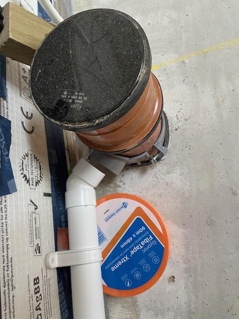

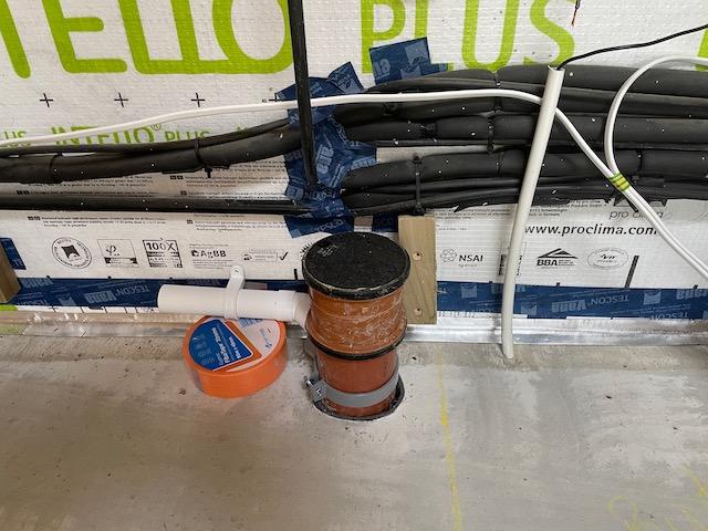

afternoon. I'm after some assistance in problem solving a waste run and I'm hoping that @Nickfromwales is in a more helpful mood than he was last night on my plastering question! 😉
we have a soil pipe coming out of our slab in the utility room but it's too far from the wall to be able to run the pipes in the service cavity and not far enough away to allow a 45° bend from a boss. as the below photo shows:
I need 2 pipes to attach to this soil pipe. one going left to the dog shower and one going right to the sink/washing machine.
I can't find anything less than a 45° bend in this Osma Wavin waste pipe! why is that?
how can I make what I need happen?

Often frowned upon by the old school boys, but mightily handy when you're in a tight spot is the good old friend, Macalpine and his flexible waste connectors. Maybe can help in this instance:

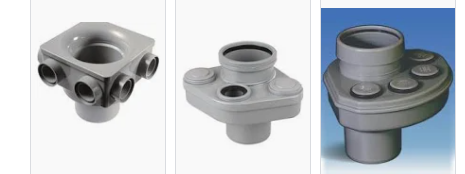

I could be way off kilter here, but would something like below be of any use
hmmm...maybe the middle one might work. depends on the distance behind the main 110mm hole i guess. do you have a link to that?
https://mcalpineplumbing.com/plastic-chrome-fittings/flexible-fittings-non-return-valves/flexcon5c-flexible-fitting-universal-x-plain-spigot
that's an interesting potential solution but i recall @Nickfromwales saying once that flexible waste is bad idea! and he used it once when the customer insisted on it (or something along those lines, although it could've been a 110mm soil pipe from the toilet he was talking about. my mind is a bit fuzzy on those details!)
