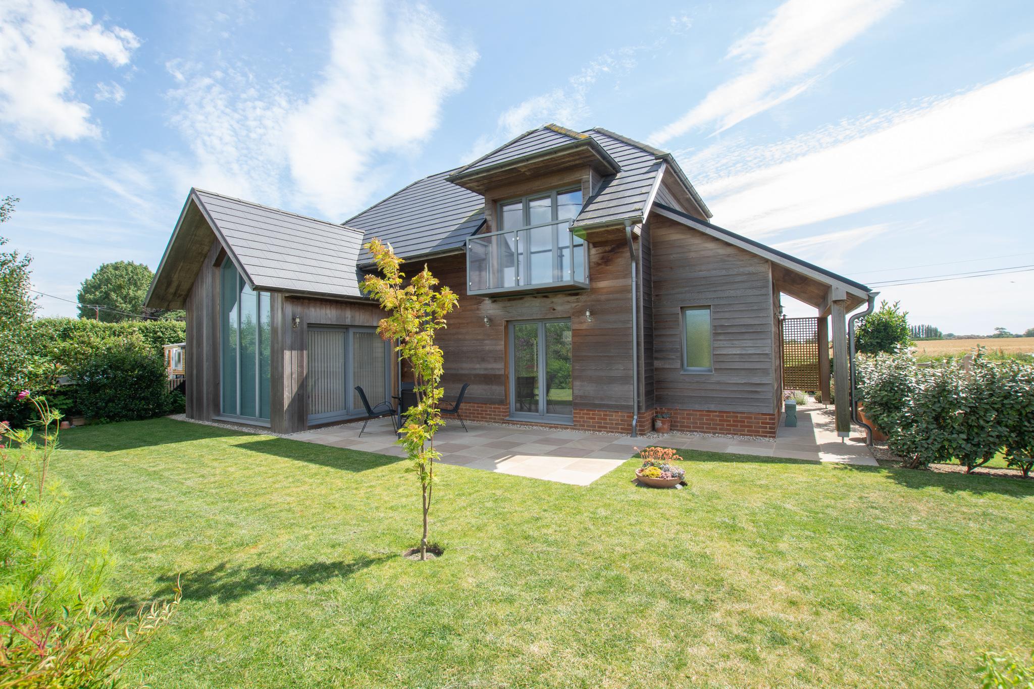

Gone West Posted October 7, 2022 Share Posted October 7, 2022 18 hours ago, CharlieKLP said: Well I’ve never seen a novice design a house that didn’t make me wince. Prove me wrong guys! When I last posted this picture you indicated that you liked it. Has anything changed? 1 Link to comment Share on other sites More sharing options...

NickK Posted October 8, 2022 Share Posted October 8, 2022 On 07/10/2022 at 08:49, Gone West said: When I last posted this picture you indicated that you liked it. Has anything changed? That looks great @Gone WestDo you have pics of other elevations and floor plan you wouldn’t mind sharing? Link to comment Share on other sites More sharing options...
Gone West Posted October 8, 2022 Share Posted October 8, 2022 3 hours ago, NickK said: That looks great @Gone WestDo you have pics of other elevations and floor plan you wouldn’t mind sharing? I moved eighteen months ago but I'll see what I can find. Link to comment Share on other sites More sharing options...
