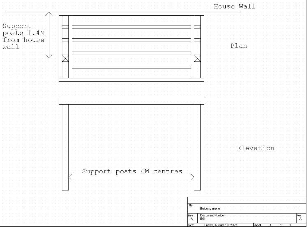

I am turning my thoughts to my own balcony, not to be confused with Zoot's balcony, though a lot of the principles will be similar.
Here are a few design constraints.  The balcony will be about 4.5 metres wide, it can't be much wider than this otherwise it would intrude on the landing window.  It will extend perhaps 2 metres out from the house, that is open to debate, but enough room to put some chairs and a table to sit out, and to be able to pass the outward opening door when it is open.
It will be planked with decking planks, set to a slight fall for rainwater to run away from the house. That dictates decking planks perpendicular to house wall, so joists running parallel to the house wall.
A fixed parameter is the bases to sit the support posts are already in place, they are at 4 metre post centres and the posts are 1.4 metres out from the house wall.  That is deliberate The idea is the posts will take more than half the weight of the balcony, but more that half way out from the wall.
Where it fixes to the wall, it will be spacers and long coach bolts so the joist adjacent to the wall is not touching the wall but spaced off a little.

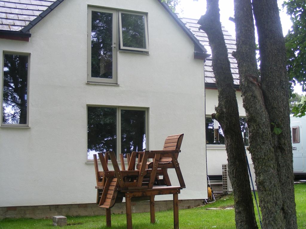

This is a general view of where it will go.

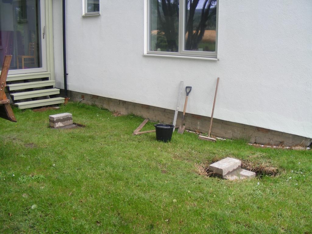

And these are the post supports, concrete blocks cemented onto concrete pads that were poured at foundation time and have only just been uncovered again.  The blocks are to ensure, particularly for the right hand post, that the bottom of the posts and the post shoes are above ground level.  That will all then be covered with decking so it does not matter these don't look pretty.
And here is version one of the frame construction.  The longest span is 4 metres so I will probably use 8 by 2 joists.

Looks good to me!, have you thought about composite decking that last longer and does not decay and rot like wood? (I have just replaced my brothers decking due to rot, but it did last 14 years 🤷‍♂️.

Apart from the joist size question, I want advice on post size.  Thinking of 6 inch square posts (150mm for our younger readers) but at the moment have not even tried looking for any, nor actually measured how long then need to be.
Are you thinking oak? I would have thought 6” softwood would be a bit too flexi. I would go for 8” posts in any case just because they would look more substantial.
that's the sort of feedback I am looking for.  I have just measured and reckon the posts would be about 2.3 metres long.  What do others think?  I am not against 8" or even 6" oak posts, but fear they will not be cheap.

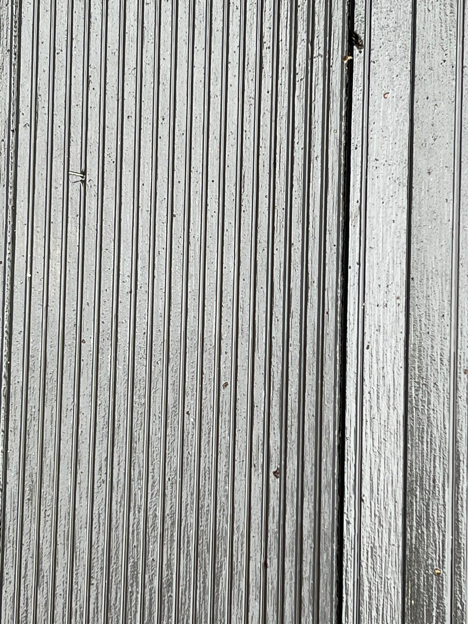

3 hours ago, ProDave said:
Composite decking planks is a possibility
Been quite disappointed with our composite deck.....it's only done one Scottish winter and seems to have some frost damage where moisture retained in the grooves has frozen and opened up a split in an odd plank here and there....so I'm heading for changing my mind on composite decking I think.....

18 hours ago, saveasteading said:
'Composite' is recycled plastic, bulked out with sawdust. Works well and is very durable, but gets very hot in the sun
Yes, but our composite is fitted with the suppliers clips all to their instructions and I'm not sure that approach gives enough expansion gap as quite a few of the joints closed up tight and perhaps that's why ours has split as shown in pic - although it seemed to happen after the winter so I'm still thinking frost. We live amongst trees so quite a bit of leaf debris etc clogging grooves and possibly retaining moisture (yes we could sweep and clean more but it would be an hourly job!) It's put me off enough that I've switched back to wood on another deck recently done at the front.
