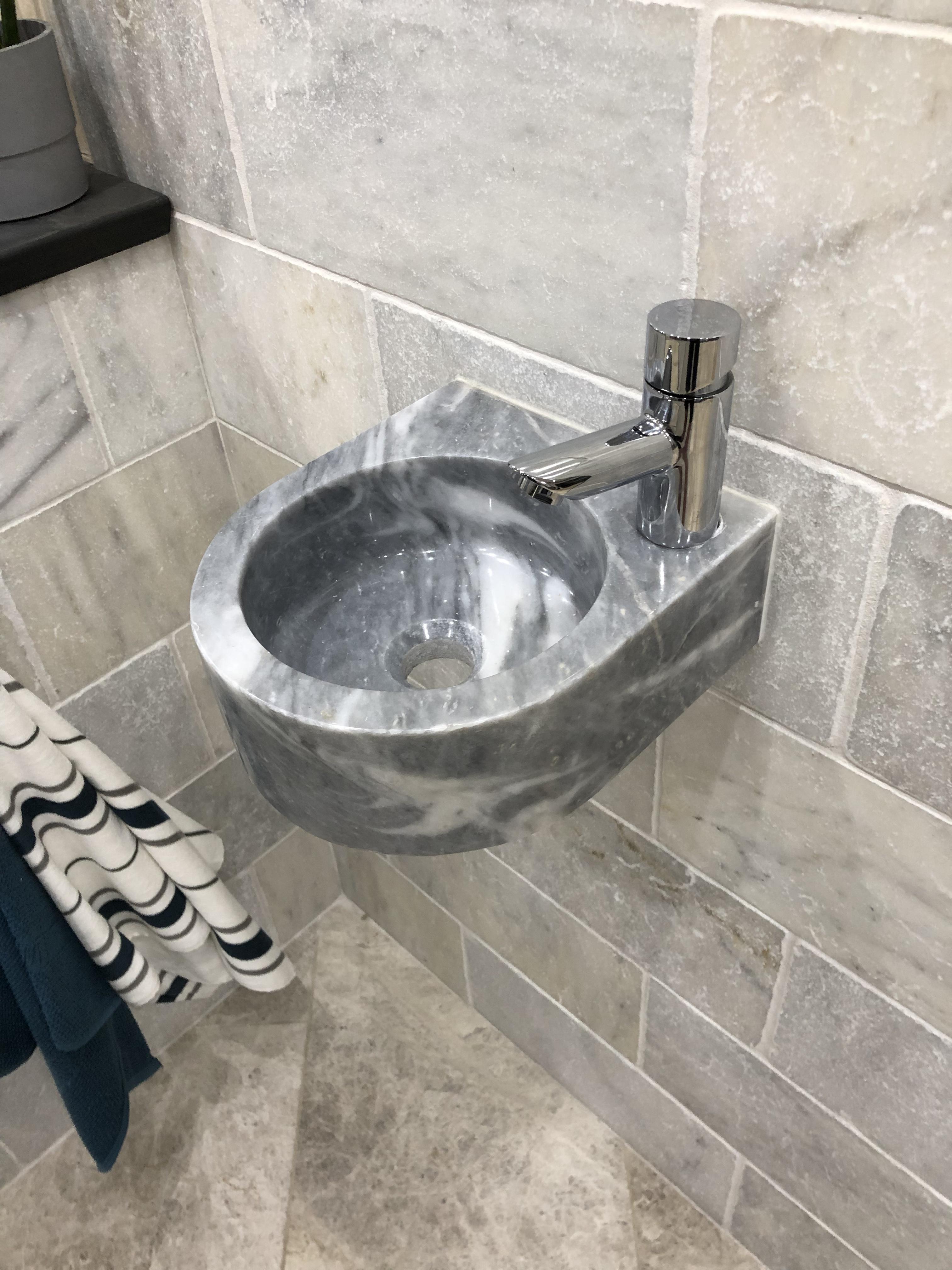

Pocster Posted March 24, 2019 Share Posted March 24, 2019 Hey @Onoff fit one of these ! Dead nice I think ! Link to comment Share on other sites More sharing options...
